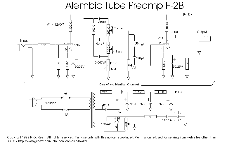

I agree with brett: chose strictly bass-related circuits!
My idea:
Pre - Alembic F2b, or Ampeg SVT, mid '70 Fender Bassman
or if you're after a more '50s sound, build a Tweed Bassman circuit.
Power stage: a pair of KT88 or a quad of 6L6 and you can't go wrong! Or if you're in needing for power a 6550 quad is well-know in bass amps.

Giaime said:I agree with brett: chose strictly bass-related circuits!
My idea:
http://www.kbapps.com/audio/schematics/tubeamps/ampeg/Default.htm

For the transformers, I think anything that's hi-fi and not too outrageus (think Hammond) will be good. For the OPT look for one of abundant power and the right primary Z. Frequency response for a bass amp is not to worry for (i.e. they are full range). For the PT look for a powerful one, with the right voltage, so you won't suffer much about extreme sag, not so good in bass amps. But the schematic you're linking is lacking most of the information you need (ok, for the primary Z of the OT you can copy it from whatever Fender, but for the PT voltages? I assume a 350-0-350 or something...)
For cabinet construction, I admit I'm not an expert. Try to find photos of the model you are interested in, maybe on ebay or something.
But I have to understand you: you point to a 50w design, tube rectifier. So you want just a recording / micked amp, not a powerful 200w jam amp? Are you after power or sound? I think I misunderstood you, if you're after a great tone to record or to be micked, 50w will be enought.
