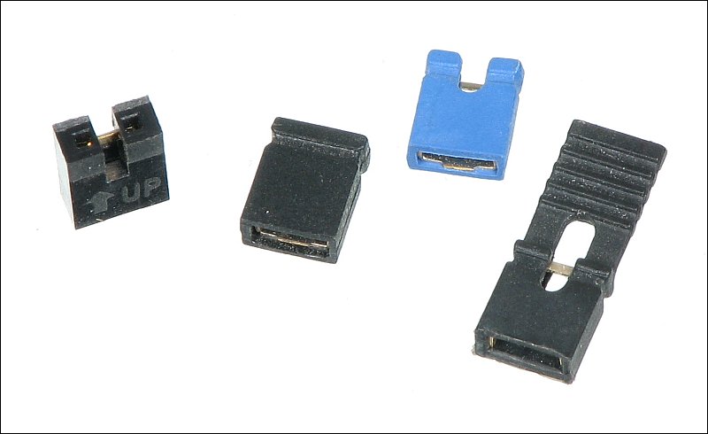

Perry wants you to place pin shunts/jumpers to each channels bias shut down pins. If you install those pin jumpers the amp will effectively have all bias turned off to the outputs. Good idea perry...hope this helps some..😉
Thanks perry, going in the right direction. Putting the jumpers across the pins effectively turns the current down. Is there enough bias current with the shunts on.
Not for normal operation. Those are used to eliminate the bias current so that the amp can be serviced without having to worry about the output transistors overheating.

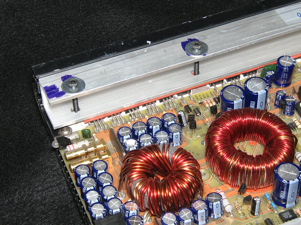

If you're going to work on these amps, you'll need to make clamps to allow you to clamp the transistors without the cover. If you want to make clamps, the attached photos shows the one that I find works best.
If y9ou won't likely work on any others, you'll have to set the bias by clamping the transistors for one channel the best you can and then set the bias. I'd set it to about 0.001v across the emitter resistors. You'd then install the shunt for that channel and do the same for all other channels. After setting the bias and powering the amp down, you'll remove the shunts and install the cover.
