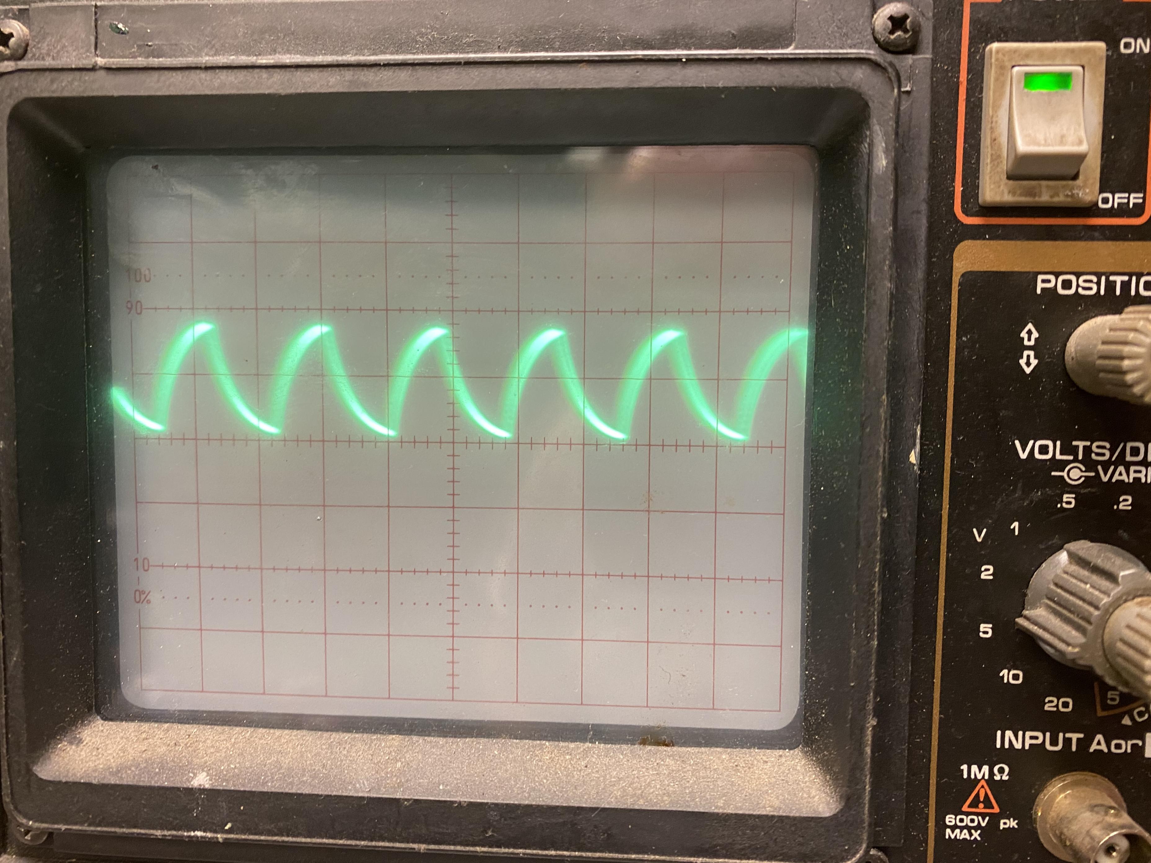

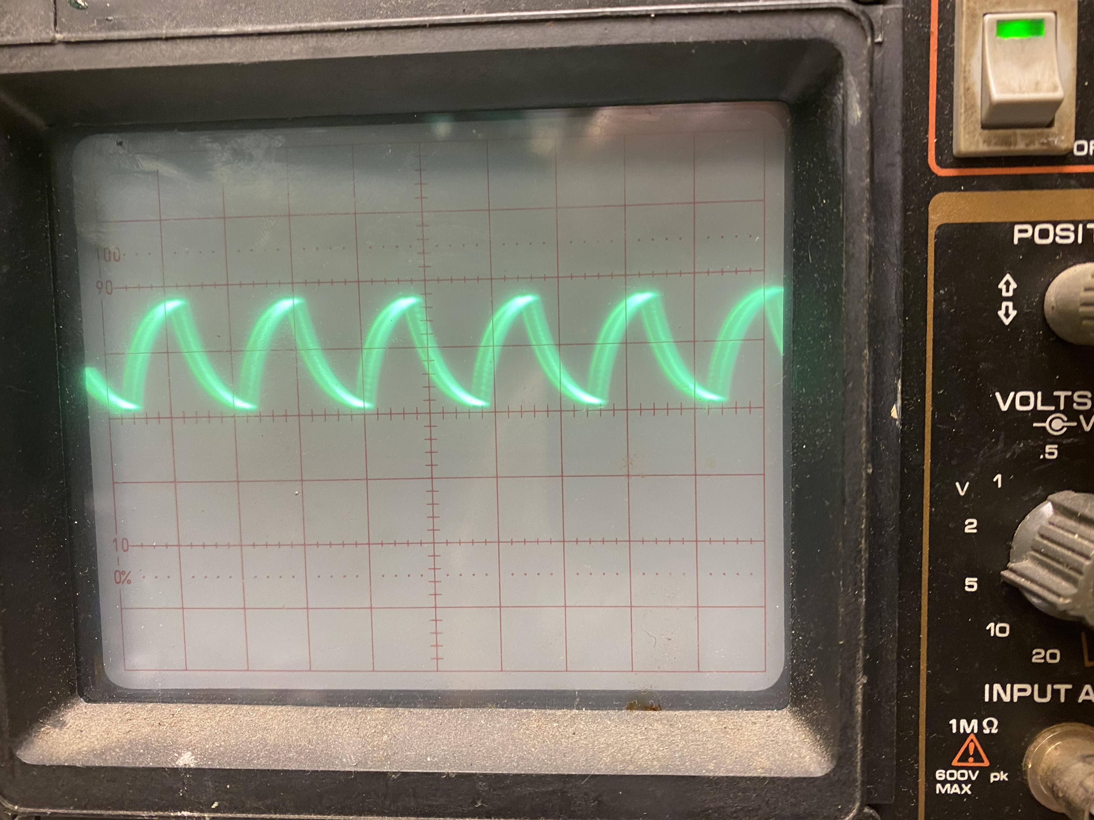

PPI A600.2
Here is what I bet for drive signals for the power supply fets .
Scope set to 5us 5 volts/div
0.1uf cap from gate to source
As soon as I apply remote amp draws excessive current all of the outputs test fine
Must be something in the output section or the rectifiers are dead I think.
Have you checked the rectifiers if they are ok?
If they are ok, is anything in the output section getting too hot?
Have you checked the output fets/transistors?
Do you have a photo from the internals?
I replaced the power supply fets ,gate resistors , and drivers
I also replaced the rectifiers .
I’ve removed all of the outputs and ceramic driver cards along with the regulators .
If I leave the rectifiers out of the amp the power supply will power up and idle fine .
If I put the rectifiers in the amp it will draw excessive current.
I’ve checked for solder bridges can’t find any .
Any ideas ?
The amp draws 40 amps of current .
The power supply fets get very hot instantly .
It draws 40 amps of current continuously .
If I install 1 rectifier but not the other it still
Draws excessive current as soon as I supply remote voltage .
Only way the amp will not draw excessive current is if I remove the rectifiers
