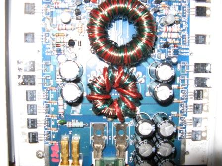

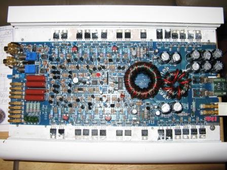

There are likely multiple op-amps. Those used for audio will have both positive and negative 15v. If none have positive supply voltage, the regulator has likely failed. If you need help troubleshooting the regulator, post a photo of the regulator and the surrounding area.

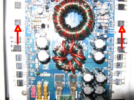

There are two others that have -6.44 on Pin 8. I was trying to find where a 15 volt could possibly come from. I found one transistor by the other DS1 that was about 10.58V. Another one kind of close to it at 13.58V. I'll probably just take a pictire of the amp as that might be easier. Thanks!
The transistors indicated in the attached image appear to be the voltage regulators. Email me the full resolution images if you need more help.
