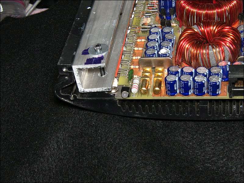

Dr Zeus, what do You mean CT? I can't do measurement without clamping rear cover on, over heating risk.
If you're going to work on these amps, you need to make clamps. The ones shown below are very easy to make and work well.
