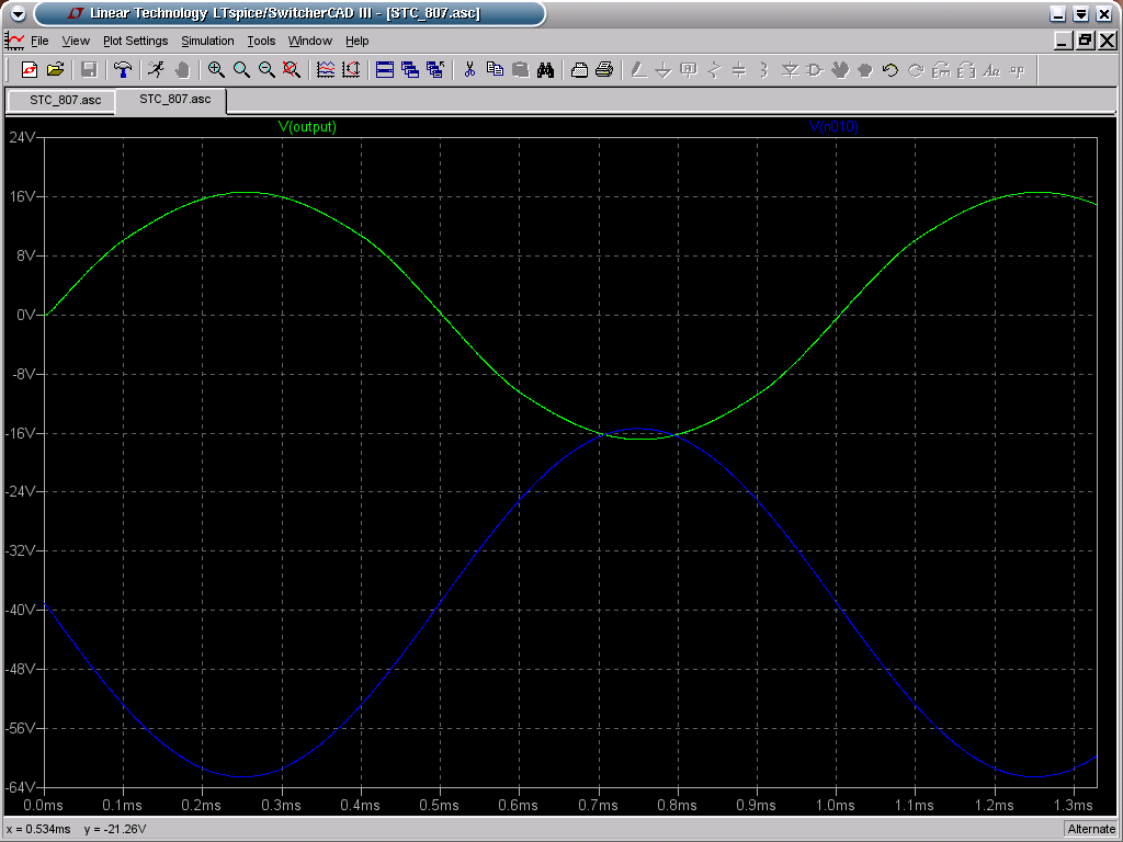

Sch3matIc, I have to disagree with your statement that class AB amps do not have crossover distortion.
I have just this week created a SwircherCAD model of the final stages of th STC 807 75 Watt class AB2 amp from the circuit in the STC 807 data sheet. See attachment.
If you run this model for a few cycles of the 1KHz input and then plot the output waveform together with the anode currents of the output tubes you can clearly see a "kinks" in the output sine wave at exactly the points where the tube currents drop to zero (This really stands out if you are used to looking at clean waves)
If you plot the signals on the 807 grids you see no such kinks, so I conclude this is purely cross over distortion in the output.
In that model I have disconnected the feed back path. Connecting it seems to be able to fix the distortion but playing with variuous feed back ratios I have seen terrible bursts of ringing in the output again coincident with the points of anode current hitting zero. I think we should not be suprised at the inductance of the output transformer doing this.
Also I noticed that applying feedback causes a very messy output signal when driven a little bit into clipping. With no feedback a little overdrive is a lot cleaner.
So whats wrong with my model ?. If it is reasonable I conclude class AB does have crossover distortion.
What's the bias at? Is transconductance at this current equal to half that at high current (peak) levels? (If small signal (class A) transconductance is lower than the average value of it at large signals, 3rd harmonics reverse from positive to negative, causing the crossover distortion.) How about the OPT model, does it simulate the initial permeability of the OPT?
Odd. Plate current doesn't hit zero for one.
Does the OPT simulation model leakage inductance between the two halves of the primary? Primary to secondary? Any other intentional or unintentional parasitic circuits present?

Sorry Sch3mat1c here is the STC 807 spice file.
Seems when one hits "preview Reply" the attach file dialogue box cleared, anyway ".asc" is not an allowed file type. You will have to save the attachment as STC_807.asc to get it into SwitcherCAD.
This simulation shows a 17v peak to peak output with clearly visibe kinks at +/-10volts. Just when one or other tube anode current goes to zero (Acually -450uA)
Yes the OPT model is as simple as can be (I copied it from the EL34 PP amp on Duncanamps) but I don't see that as contributing to those kinks.
Perhaps "cross over distortion" is not quite the correct term here as it is not happening at the zero crossing of the output signal but rather as we move out of class A operation.
So, anyone know if this normal and/or how to fix it ?

I don't have Spice/CAD anything. 🙁
That the current is going even to zero, let alone negative, especially at *higher* plate voltages, smacks of a bad tube model.
(Very rarely, secondary emission can cause negative screen current in some transmitter tetrodes. Low power tetrodes like type 42 or beam tetrodes like 6V6 have regions of negative plate *resistance* (meaning plate current drops as voltage rises), but still no negative screen current. Pentodes cannot have either characteristic, by design. At any rate, I doubt your model would be programmed to represent secondary emission anyway.)
No matter what Greggggggggeek says, 😉 simulation is for educational purposes only and if you aren't using accurate models or using them right, can be quite far from reality indeed.

I suspect that the kinks may be the result of the sudden increase of current through the cathode followers, ie when the grids starts to draw current the driver tubes "sags " bit. Just my 0,02 bucks
