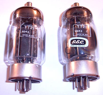

hi,
for the cheap nos tubes use in your kit, pls try to consider the NOS GEC TT21, this was the top cap tube but same spec as GEC or Gold Lion KT88.
Many User of KT88 in hong kongf like to use this tube to relief
KT88.
Pls go to ebay to search. quite cheap.
But top quality.
thanks
Thomas

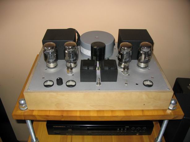

I am playing with Boully Kt88 Integrated and very Satisfield .In that price Transformers are Lundahls . Triode mode is not enough for such sensivity. I play 92 jordans (87 db ) in modest volume levels with 25 watt triode .UL solves the problem but not soundin as good
papparazzi

In the end I went for the Boully too.
As a matter of fact, I have the very first one made.
I am very satisfied with it, although it can't play very loud with my speakers since it's wired in triode mode. Don't know how many Watts are left, but who cares as long as it sounds as it does.
Hope you're satisfied too.
Gert
