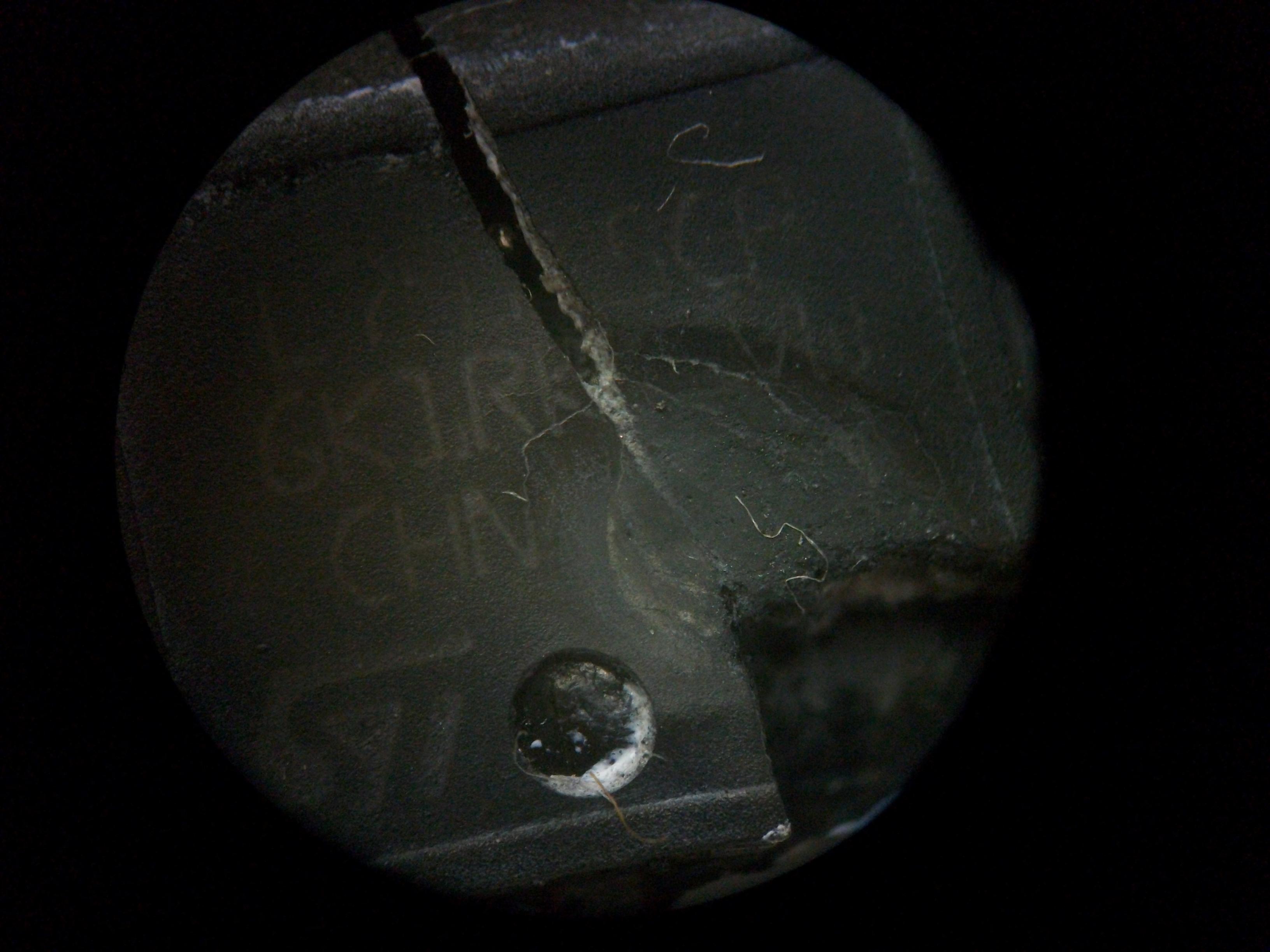

A Powersoft K8 came in for repair due to water damage.
Upon repairing a track on the underside of the pcb, i also found
a bad voltage regulator.
Unfortunately it is cracked open and i am not able to see which one is it.
I am referring to U4 in the power amplifier section.
Here is a pic that might help.
You'll probably have thought of this, but is there an identical regulator doing the same job on the other channel?
I suppose looking at the voltage ratings of connected caps on the output would give you a ballpark idea of the o/p voltage.
I understand that powersoft are a bit cagey with their service data, unfortunately.
Thank you.
I think i came to the same conclusion myself.
There are only multilayer capacitors in the input and output of the regulator.
I only knew for sure it was a negative type.
Thanks again.

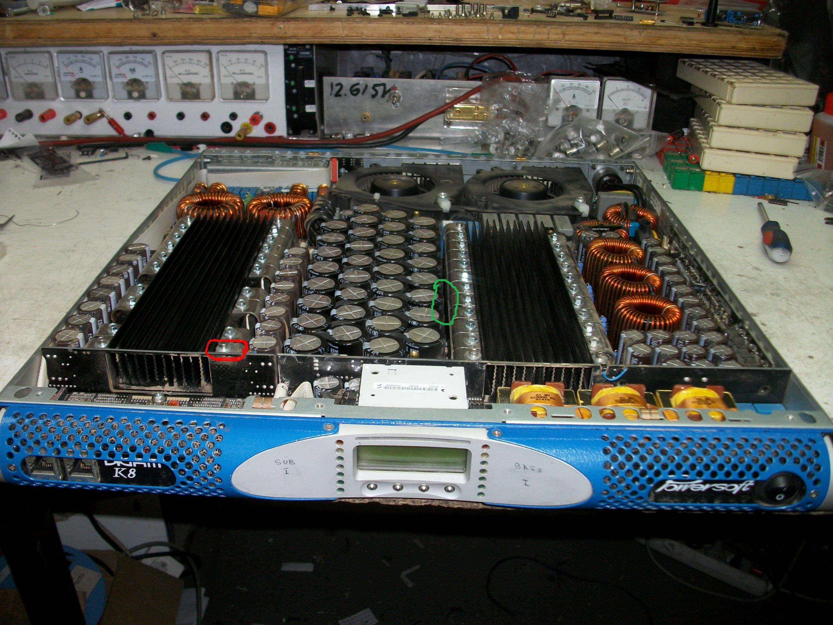

hello do you still have this powersoft amplifier? i have a problem with mine there are 2 blown zener diode and i cand't see the value, the position of the diodes in the board it's marked on the picture...
