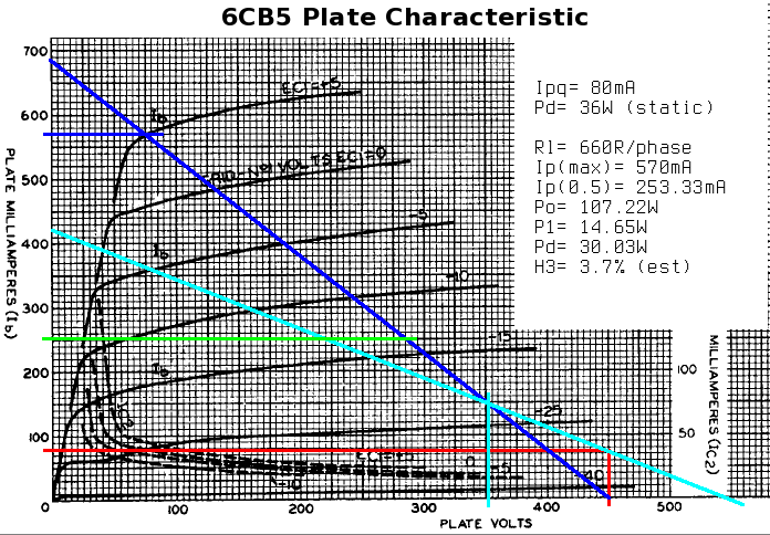

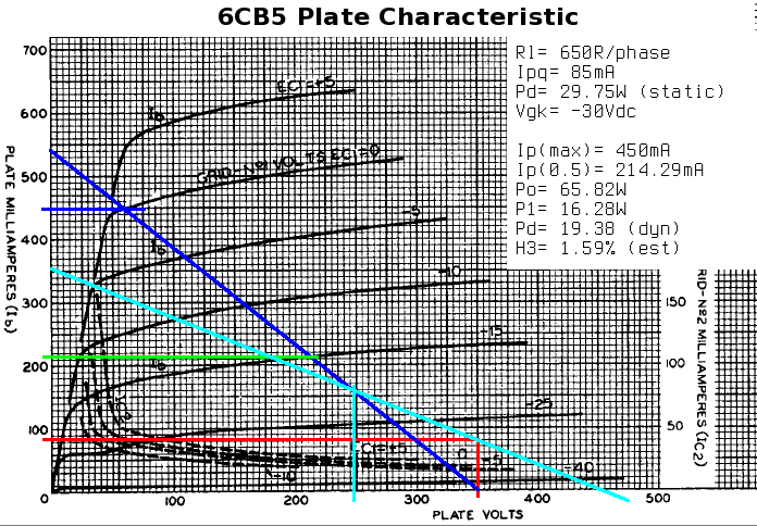

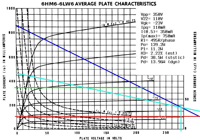

This is definitely do-able, and you don't need the complication of paralleling finals, or outrageous DC rail voltages either. (See attached)
As the output transformer I may be able to use Hammond 1650R (5kPP, 100W, 235EUR/pair), 1650T (1.9kPP, 120W, 235EUR/pair) or 1650W (1.9kPP, 280W, 550EUR/pair), Toroidy.pl TTG-6C33CPP (1.2kPP, 80W, 130EUR/pair) though I am open to suggestions for a similar price. I read somewhere (maybe on this forum) that you should never exceed the power rating of a PP transformer or something may blow up.
These OPTs have impedance transformation ratios that work very well with TV HD finals.
"What would you recommend?"
HD finals: they're cheap, available, and can provide bigwatts at lowish voltages, and they have excellent sonic performance: better than some audio finals, even.
The 6CB5, being an older HD type, needs to be taken inside of Class *2, but it's not a hard load, and a 6SN7-oid as a cathode follower grid driver will work just fine.
6LW6s are as rare as seal feathers these days, due to the demand for these for ham rigs and illegal CB linears. However, there are a lot remaining int he odd heater voltages as these were also designed for use in series strings that ran directly off the AC mains with PTX-less (usually voltage doublers) power supplies. The other than 6.3V heater *LW6s aren't especially $pricey.
2x EL509/519 per channel into 1k9 would already get you over 100W with reasonable voltages. No need to parallel them.

The 6S33S is a triode, the 6P42S is a TV sweep pentode. The triode has a higher saturation voltage than a pentode and therefore has higher internal losses for a given output power. TV sweep tubes operate at full power continuously until they die. Therefore the ratings on the US ones at least are a bit conservative.

The peak plate current determines the saturation voltage. Assuming a 3300 ohm load, which is 825 ohms per plate, and a 600 volt supply, if driven to clipping the peak plate current will be about 725 mA. The tube will saturate at about 30 volts on the plate, and -8 volts on G1. This puts G2 at about 140 mA for that instant.
