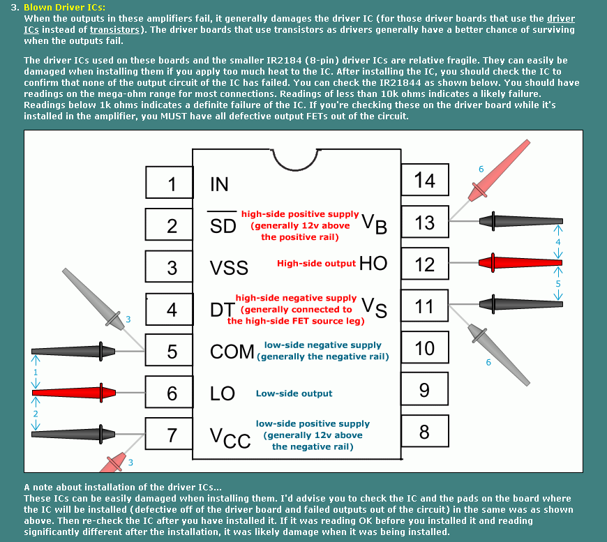

If you have another new IC, check the resistance between the legs of each various section of the IC to see if the ones you installed and removed read precisely the same as the brand new ones.
The image below shows the tests for the driver stages. Also check between the various pins on the control circuit of the IC.
