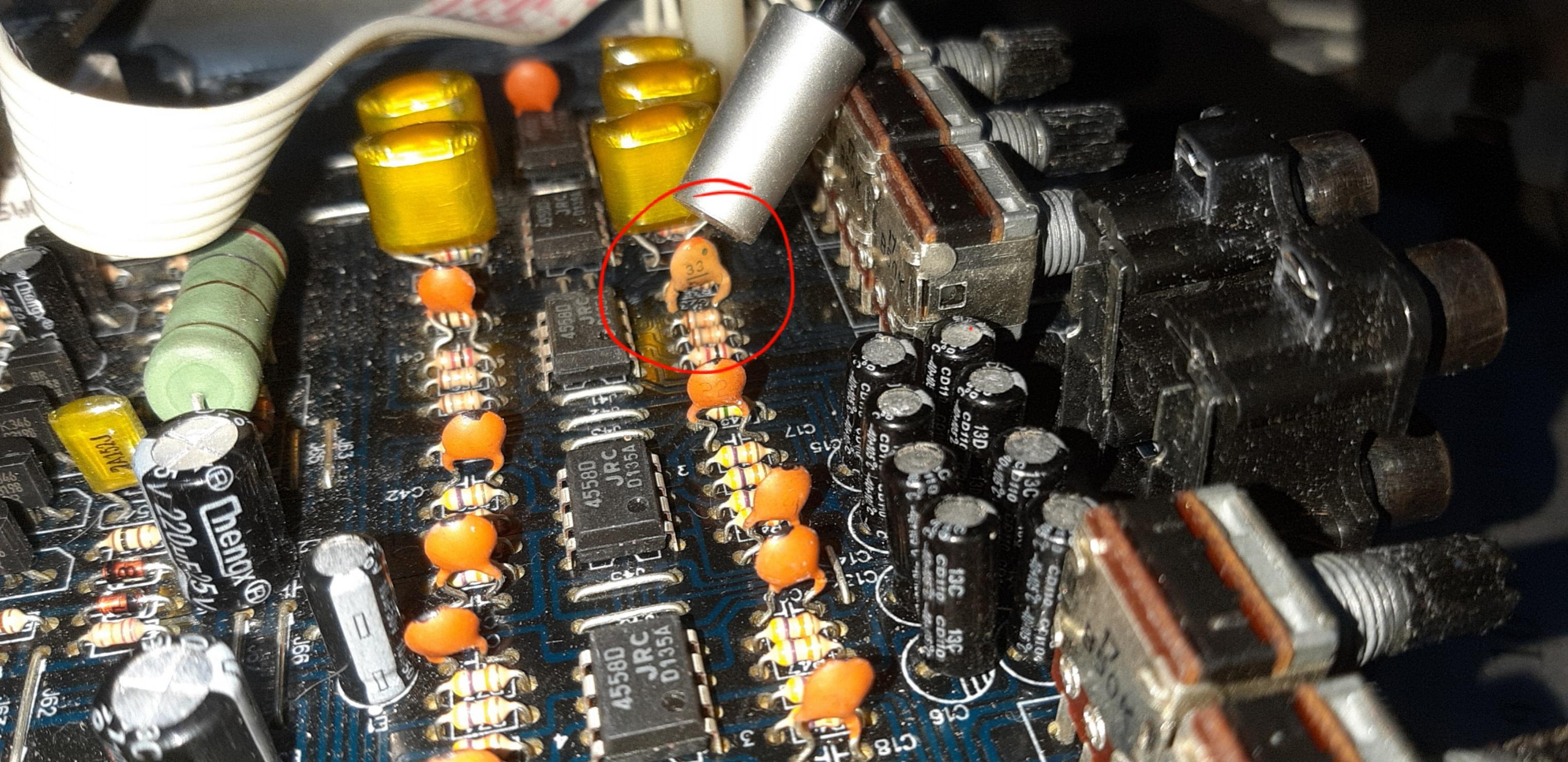

I cant say when or how the fault happened, just that it started to put out a very crackly distortion sound on 3 of the 4 channels. Strange that 1 ch Is working 95%.
There was a 33nf ceramic cap that showed zero continuity when tested. I replaced it with the exact same value. And just for peace of mind I reached the 3300uf 50v caps with 2 x 4700uf 50v caps. Upon testing after putting it back together, all channels were clear and worked, and then went back to the same way it sounded before.
If anyone needs specific pics please dont hesitate to ask. Any idea on where to start investigating?

Precisely which ceramic cap did you replace (show on photo)?

I'll be sure to be more thorough in my explanations. When I set the multimeter to capacitance, diode and resistance there was zero reading. When I removed it the one leg had been snapped/broken off. I replaced it with the same value, but slightly lower temp rating ceramic capacitor. This was for the interim just to check if it resolved the issue. As for the 4700uf caps, before I found DIY Audio on another forum someone suggested I replace all caps, I didn't have caps that would fit in the amp aside from these ones. Should I put the originals back? And i have not proved any part of the amp while it has been powered on, should i push on component legs to check conductivity?
The amp was putting out clear signal on all channels after I replaced the ceramic cap, now it's back to only the 1 channel producing a clear signal, but it cant reach its full potential of 60w rms on a 4ohm speaker without distorting like the other channels do.

Push on the board.
I think you have a bad connection somewhere. The amp started working after you worked on it because the connection intermittently restored the connection.
