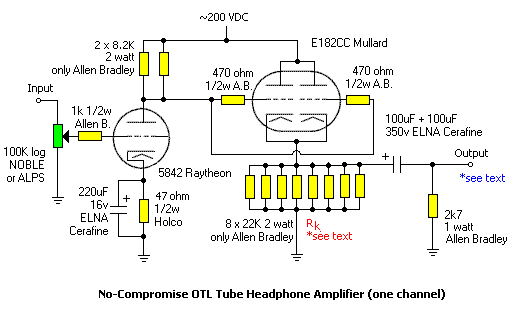

Ok. Mine was a generic question,. But as an exemple, I can refer to this old Ciuffoli circuit (I hope it is allowed posting the screenshot of the that) where one could replace the set of resistors with a s.s. device, so it also may be smarter and more linearized overall. That was my idea.

That plan with 8 * 22k of DC load, the 2,750 ohms of resistance is much higher than almost any headphone you will use, so it makes very little difference 2,750 or infinity.
And if you seriously wanted linearity through more active devices, there are more powerful solutions.
But sure, if you want a MOSFET then use a MOSFET.
The 'No-Compromise OTL Tube Headphone Amplifier' is just another example of a design that ignores the Physics of vacuum tubes. The cathode follower is known for low distortion, all of the gain is applied as negative feedback. But what if the gain is rendered low because of a serious mismatch of the tube to the load?
The Spec sheet shews that under certain conditions the Gm of each section is 15 mA/V. Since the load is so much lower than the rp of the tube the gain of the stage can be taken as Gm*Rl, same as a pentode. So paralleling both sections gets 30 mA/V & the headphone load is 32R. Stuffing the numbers into the HP67 & turning the crank I get a gain of 0.96! Not much NFB in that cct. Does anyone ever look at circuit performance using a scope & distortion analyzer? Maybe not, many are afraid of what they will see.

Your explanation is clear, it's easy moving the crank but a little less with maths 🙂 Why not to use, for example, 6H30 tube (Audio Research used them too...): higher plate current and higher μ. A part this, I feel that on driving low Z headphones I would go for OT instead.
You should try a new crank. For two 15mA/V driving 32r, I get 32/65.3 or 0.49.
No need for a new crank yet, the calculation is for any tube cct where the Rl (load) impedance is significantly less than the tube rp.
Think you went straight to the gain of the cct while connected as a CF.
So to calc that when all the gain is applied as NFB the gain become
A/ (A + 1).
Stuffing the numbers into that the HP 67 sez 0.49, same as you got.🙂
Good for Audio Research, perhaps they didn't read the books on vacuum tubes either! Doesn't matter who builds the amplifier at all, for a proper match a triode needs to see a load at least 2X its rp. Very few tubes can do that for a 32 ohm load.. An OPT is a far better idea.🙂
The proper load is the same whether it is in the plate lead or the cathode lead. Or split as it is in the split load phase inverter.🙂

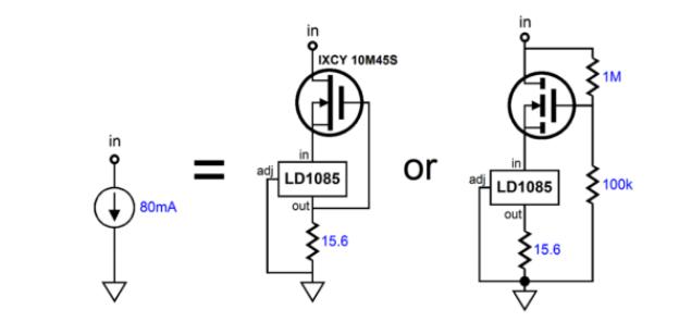

The screenshot of LM317/337 would be ok but within a low-medium voltage...my question was for various voltages or currents.
Just to stay on the initial topic where I mentioned the use of IC/mosfet I found this. Maybe one could replace the current regulator with another, this one is by default.

Yes, absolutely use a CCS there. The AC impedance of the CCS will be many orders of magnitude higher than the AC impedance of all those resistors in parallel, allowing for additional AC signal current to be delivered to the headphones rather than wasted in the cathode resistors.
(A 5842 absolutely needs grid stoppers and plate stoppers too)
