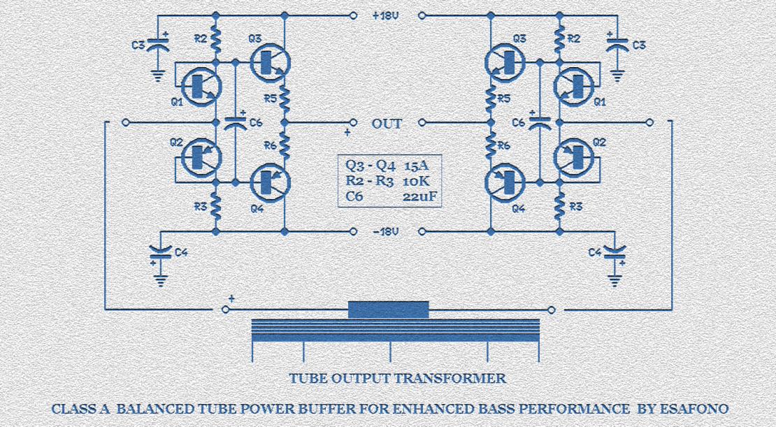

Power tube buffer
as you know
the accurate sound of the Valves does not give a deep bass, never😀
this Balanced buffer does not lose quality of your acoustic scene
and Complete the soul finally adding a body to music😎

Please tell me more.
What is the input impedance of the transistor buffer?
Is the transformer a typical tube output transformer, or is it a matching transformer between stages? If it is a transformer at the output of a tube power stage with limited bass output that is what your buffer will have, limited bass.
Where does the idea that tubes plus output transformer lacks a deep bass come from? Depending on the transformer 25 Hz to 20K Hz bandwidth is not uncommon (also not cheap).

Load change source performance
the really transformer's 25 Hz to 20K Hz bandwidth depends of your load
also of your power level🙂
specific data and parameters often make us lose the overview:Pawprint:
best adjustement is move 10KOhm values to have Ic 2A @ 8 Ohm load (3A@6Ohm)
so need a very big dissipator for each channel

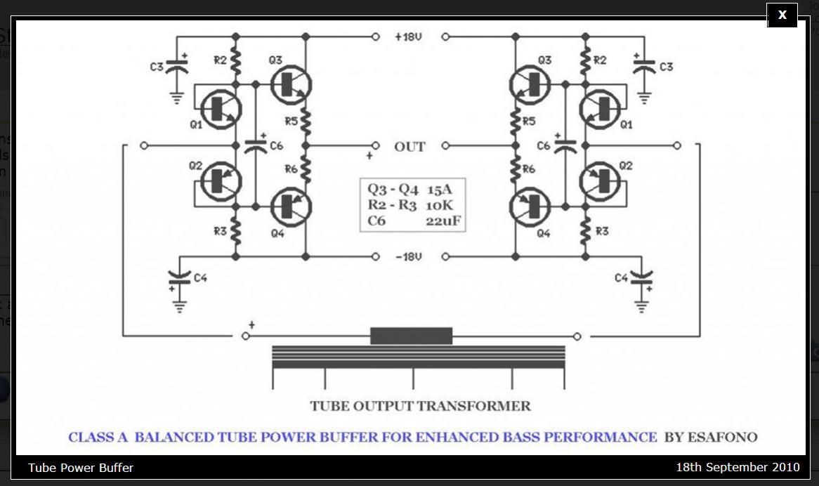

the missing link in the chain
in structural projects, there are two safety factors, static is third of dynamic.
in short I am arguing that the TUBES output transformers are undersized 3 times.
I tried to shunt the secondary in parallel instead series (4 and 8 Ohm to 2 Ohm)
...improves but not enough.
advantage of the buffer is to isolate the reactive power back from the speakers on the negative feedback of tube.
you do not have large heat sinks may adopt a bias AB1 (0.5 A)
in this case it is better to use identical components with gain (gain means speed)
I found the same gain (Hfe 100) with A1302 and C5200
two generations who marry perfectly:trapper:

If you reduce the load on the OPT, as you appear to do, then the result will be to raise the LF roll-off frequency, although negative feedback within the main amp will offset this. You may also get a higher output impedance, as seen by the speaker, as a plain emitter-follower might not be as good as global NFB for this purpose. A higher output impedance could give extra bass boom around the bass resonance, but less below it. I believe this is sometimes called "one note bass" - you could make your hi-fi sound like a cheap ghetto blaster!
So you end up with less bass overall, but more at one particular frequency. To uncritical ears this might sound like an improvement.

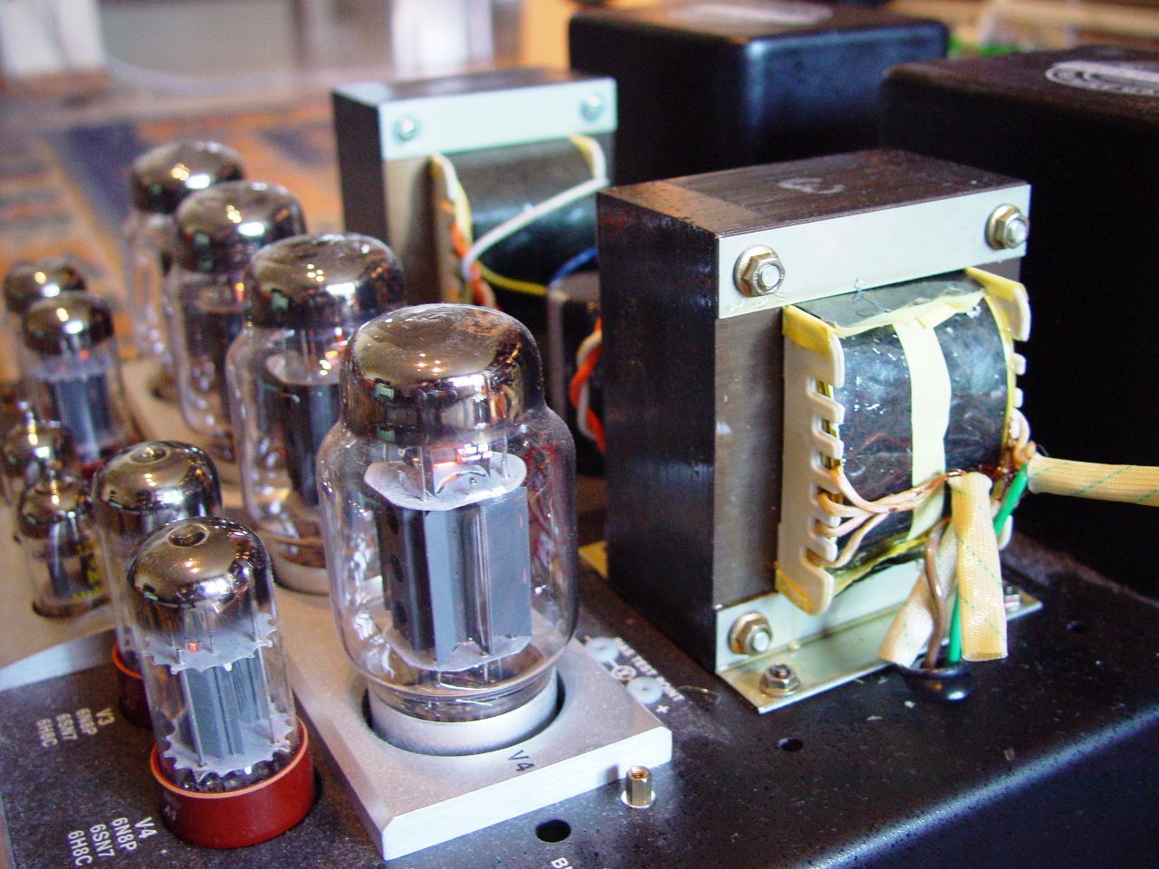

Why not simply using larger ones?
because you lose power😡
also need adjust NFB resistor to half value
