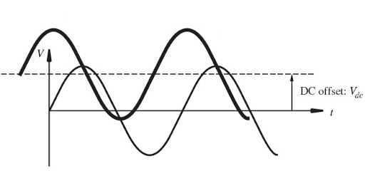

Most toroids, regardless of brand and quality, will hum when fed a slight DC component when the mains voltage is distorted. You could add a suitable DC blocker in that case. I think you can find those yourself. These are mains connected devices so be careful.

OK, then you likely need DC blockers for them as suggested. These don't have negative side effects when there is no DC component on mains voltage.
If it is DC you will experience the toroids to be more quiet or even completely quiet at times.

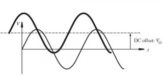

Exaggerated for understanding. A toroid does not need much DC component to hum. Since loads are more and more complex compared to ohmic loads in the old days (light bulbs etc) a perfect sinus mains voltage is rare.

Whether for audio (and with audio prices) or industrial: both toroids will possibly hum with a slight DC component depending on the time of the day. It is a widely known issue. If you want hum free and lower strayfield then R-cores are the answer. Toroids are cheap, easily available, easy to manufacture etc. but they're not the best of transformers. Toroids are the types most sensitive to the DC component which can be solved by DC blockers. Do not assume, build one to test if the Noratels are then quiet. Or buy audio grade 🙂D) toroids to discover they may also hum. Indeed the voltage secondary is OK but that is no surprise. The hum takes away much joy in using equipment. Wherever I can I use R-cores and never had one mechanically humming but I am sure there will exist cheaply made bad ones too.
The system choice you made by choosing toroids is mainly the cause. When using toroids DC blockers meanwhile are a must. It may be that toroid A is worse than toroid B but feed them any DC contaminated AC and they 'll both hum. The ones that are molded in epoxy are way more silent BTW. You could consider molding them in slow curing transformer epoxy but derate power then as heat is then an no no.

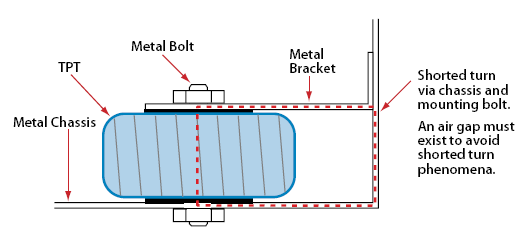

Last question: you did mount them as done standard did you? If these are mounted the way that the bolt is a shorted turn (i.e. between 2 metal sheets that are in contact) they may also protest sonically, even the best ones. And it would not cost much time to reverse L and N of one of the Noratel ones just to check if it makes a difference.

They are mounted with metal on both sides connected by the screw that holds them. It's a bit tricky to reverse one but I can easily disconnect one channel to see if that makes a difference. Interestingly my other "2 toroid" amp have plastic caps holding them down 🙂
There you found the cause I think. You have a shorted winding when a toroid is mounted between metal sheets that are in contact with each other and now also make contact via the bolt and nut. Well another proof that the one helping must ask more questions (to a level the requester even becomes irritated/angry) to compensate for the lack of essential information of the requester.
The metal disk to mount toroids is not what is meant. It is the donut type of mounting in a (theoretical) U shaped sheet of metal. You could of course post a picture as that says more than 1000 words and takes less of your time then it costs me and others reading your issue to understand or maybe even solve your issue. In fact the requester should post as much information as possible as it is in his/her own interest to be helped adequately courtesy of the helpers and to make it a more efficient affair for everyone.
A "right" transformer can be mounted "wrong".
