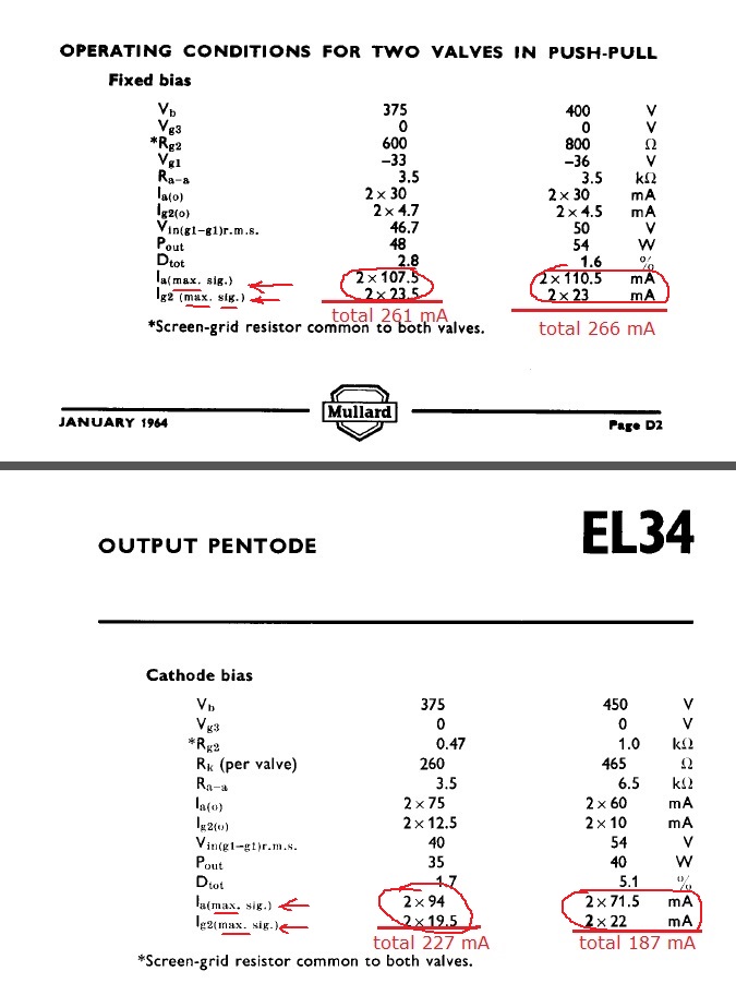

Thanks for all the responses.
I have found something else online, it is a datasheet of the el34 from Mullard shown below.
In my calculation 4x el34 will draw 256 mA max
Mullards datasheet says 532 mA max at 400V
This is a big difference, am I reading the datasheet correct?
Also, what would be the effect of under- or overspeccing a transformer?

Thanks PRR. I calculated the el34 current draw as such:
- el34's @ 450V = ( 25W/450) x 4 = 222 mA
- screen current 222 mA / 6.5 (screen-to-anode current ratio in datasheet) = 34 mA
The amp is push pull, 100 watt sine, 4x6ca7 ( el34) with fixed bias.
Should I better use Mullards datasheet for the max current draw ( Ia max. sig. and Ig2 max. sig.) ?
For a guitar power amp that is working with a square wave-ish output from the preamp, what would be a good fraction of the max current demand when designing the power transformer?
I would like to design for the possibility to turn the amp up full for a couple of hours with a vivid playing style.

The reason I am asking is that I am using a 100 watt replacement Marshall transformer in a amp and it runs so hot at full volume that it starts to smell to varnish and is too hot to touch. It is also fairly noisy. Made by Dagnall.
I have blown the original PT before I installed this one, also by diming the amp.
HT is at 300 mA.
For a new amp I would like to spec a custom transformer that solves these issues, and for that I need to calculate the max current draw of the amp.
Marshall originally made these amps for use without distortion, as stated in the original manual "turn amp down if ugly distortion starts to appear".
I suspect the old transformers are not specced to support dimed playing.
