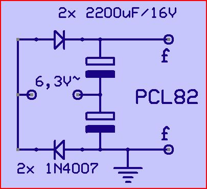

The PCL82 is more complicated since you need 15V,not so commen.
By puting some extra windings it is possible to go from the 6,3V to 15V.
Another way is putting two 18V(1A) transfomers back to back and a resistance in serie with the heather to get rid of 3V.

A one to one isolation transformer could supply high voltage while an additional easy to come by 6.3 volt transformer could cover it, if you wanted a somewhat cheaper and easier to source solution.
hello ,
it is possible use doubler to 6.3 V~ ; up to power BT is 6.3 V~ X 2.828 = 17.81 V= !
and regulator LM317T to ajuste +/- 16 V=
That's a good idea 🙂hello ,
The regulator isn't needed,with the losses of the diodes and some ripple the result is close inough (how do you write that 😕)for the PCL82.

16V AC transformers are cheap and easy to come by and are readily salvaged from dead equipment. This cannot be said for reasonable current 6.3V transformers. The actual voltage is rather forgiving and you can usually get away with anything from 15-17V. They can also be series connected (as they were designed for) allowing you to use an even more easily obtained 32V AC transformer.

hello ,
No, not enough voltage drop on the regulator.
Mona
Maybe, but the 6.3v winding needs to be rated 2.5A or more in this case. And we are replacing benign 50Hz hum with rectification spikes and harmonics which radiate in the neighbouring circuits... not so good.
