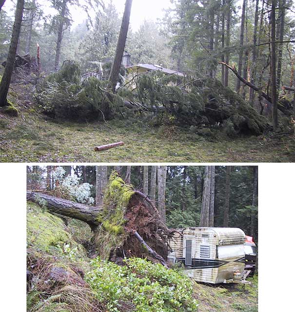

I was hoping to lose a few trees that are too close to the house but they didn't give in 😉
Watch what you wish for... a tree thru the roof of the house is not fun... we had 2 last year that just missed my parents house -- it would have been nice if the one had fallen the other way and crushed the trailer (we just can't talk my dad into getting rid of it)
dave
