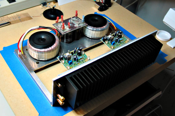

Almost done with my first power amp. AKSA 55W. I still have a little bit of soldering and chassis work to do before I fire it up.
My question is how should I treat my power supply wires? Should I shorten them? Should I twist them? Keep them separated?
The DC to the amplifer should be twisted or not?
Nice project...
Yes...keep the wires short....but please not shorter!! 😉
Twist the wires to the power transformer primary...from the transformer secundary to the bridge rectifier and from the bridge to the power supply capacitors...
No...in this case not...

First, very clean amp, ultrachrome!
Jorge, I am curious about this as well. I would think you should twist wires whenever they are more than a couple of inches. I am curious as to when this would not be a good idea. In my bench power supply I twisted just about everything. I am hoping to start on my first amp, now that the bench PS is almost finished. It would be nice to know any reasons to or not to twist other wires.

The Twist
Hi
The reason for twisting a set of wires is to reduce the magnetic field created because og the current running i the wire.
Twistind pairs are also more imune to incomming magnetic fields, and therefor small signal wires in microphones are almost always twisted as well as balanced.
Using long wires is alvays a problem, and therefor I would recommend to twist both your DC and small signal wires.

To twist or not twist...
When you conect de DC path from the power suplly capacitors to the active devices...if you twist them...you will increase the inductance...and oscilation could be the result...never forget that is in this capacitors that the output circuit close the loop that come from the loudspeaker...
I sugest to run this path with to wires side by side and near...for the loop betwen them to be small!

So in short. No unnecessarily long wires. Twist AC, untwist DC.
Do I need to keep my 24VAC apart from my 0VAC wires that are running to the ground point? (I'm using a 24-0-24 transformer) Do I twist the 24's together and twist the 0's together?
Or is a couple of inches to short of a distance to bother with the hassle?

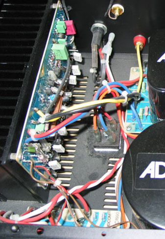

I pried the lid off my Adcom to take a look at its power supply wiring. The only wire twisting is the 117VAC coming from the back of the chassis up to the front power switch and even then the twist is about 1 turn / 3 cm. In fact, it appears the secondary wiring rubs against the DC coming out of the rectifier.
