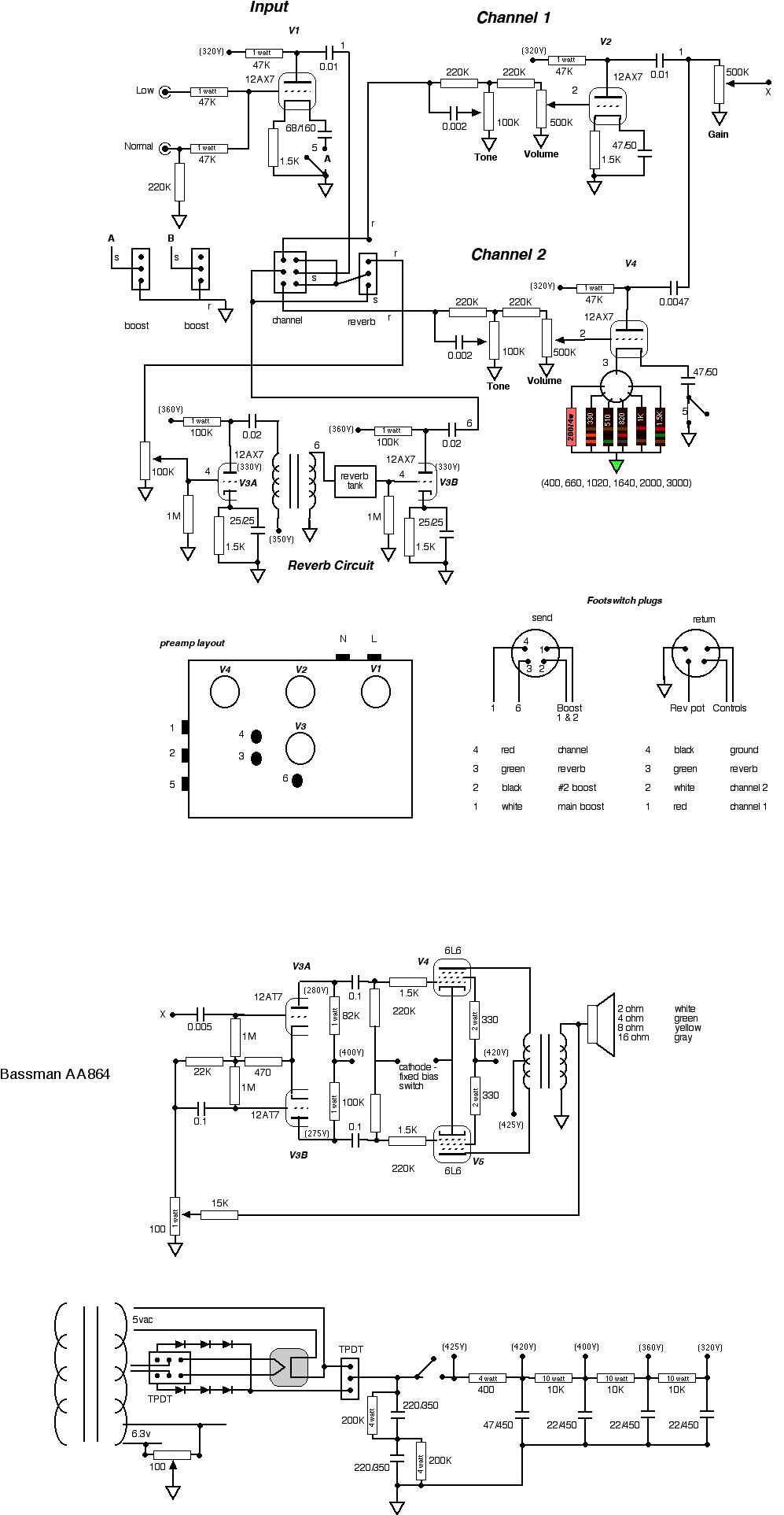

Can you post a schematic of your power supply and amp (hand drawn or out of copyright please) but you should probably adjust the resistor in the supply that feeds the phase inverter rather than the last one in the chain.

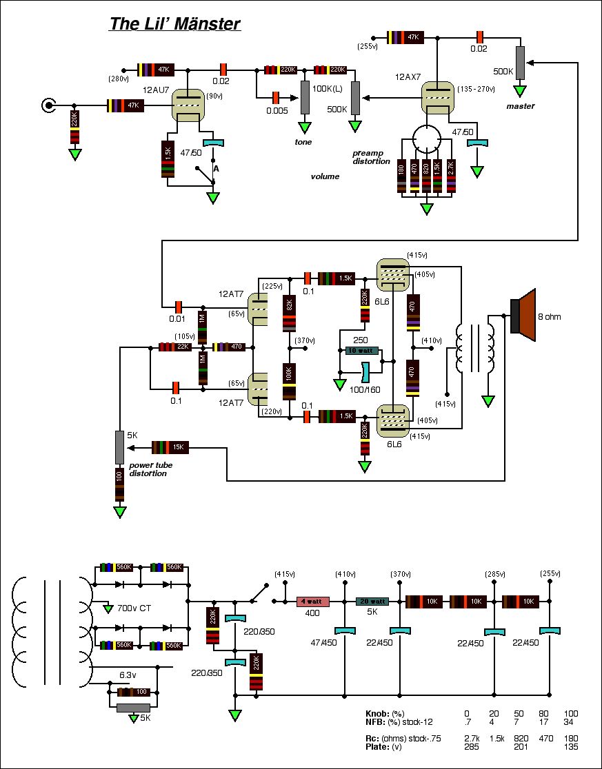

Increase the resistor feeding the PI node for the voltage on the PI and the preamps to drop. This assumes a typical series-type dropping configuration. In a AA864 Bassman this would be the 1k after the choke. To keep the PI close to where it is, while reducing the preamp voltages, increase the 4.7k that feeds the preamp instead. Each "dropper" drops voltage on all the nodes it feeds as well as "down" the rail. It's a balance act. You can use a PS designer (like Duncan's) but real world trial and error may be easier since you've already built it.
I would try a 3k in place of the 1k as a starting point crap shoot. If the PI is then good but the preamp is still a little high, proceed to the 4.7k and maybe try a 10k. Assuming that's where you are starting from........

Here is a schematic of the amp and one of another that works perfectly. With the "same size transformers" the voltages are quite different. I guess I'll need a larger first resistor. I used a 400 ohm instead of a choke.
Is there a way I can test the transformer for how much current it has? I'd like to see how much difference there is between the two, but my knowledge and experience are limited to what I've read...

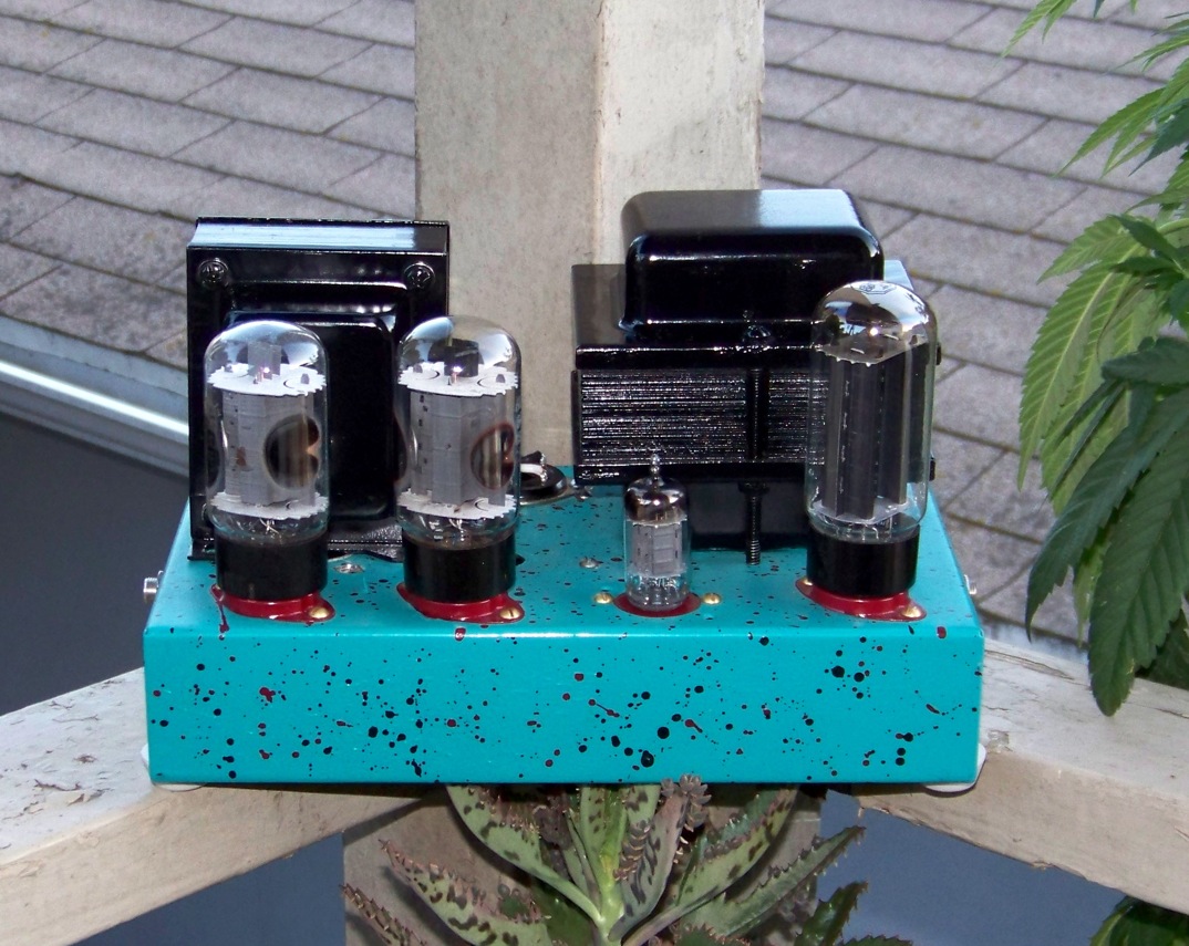

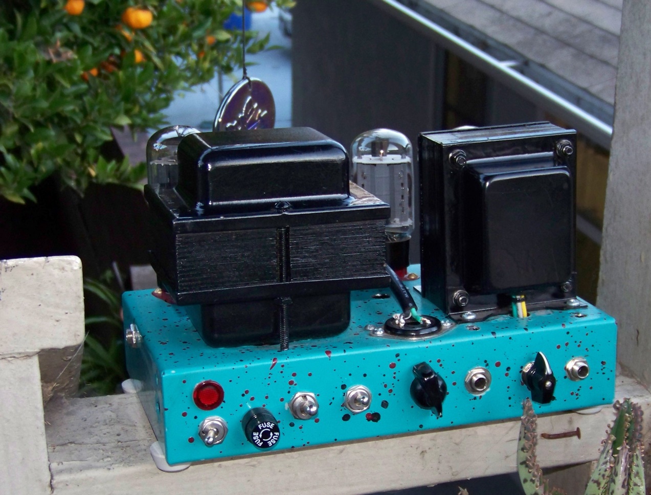

On a bigger chassis I would use a choke as well as film caps from some one like Angela instruments asc brand it does change the sound of the amp however . The color of the chassis is cool what is that robin's egg blue ? If you like now stay with this setup and play with the first resistor.
Indi: I'm curious why you said PA amp? I kick myself for not thinking about your test, I know that already. Duh. Thanks for reminding me.
Trio: What caps are you referring to? And what does a choke do different? The color was an accident. I got the blue/teal color but couldn't keep it from crinkling so I sprayed dark red and black on paper and used a tiny brush to shake the spots all over it.

To all: I found a problem that brought the voltages down. The cathodes on two preamp tubes were not grounded. When I did this, the voltages came down to values I'm used to seeing. I have sound through the amp, but it's very low. I think it may have to do with the foot switch, but I'll figure that out, hopefully.
Thanks for everybody's input.
