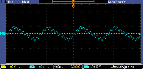

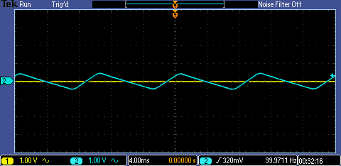

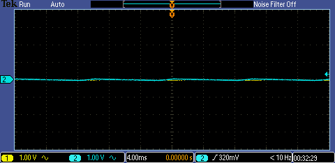

I've been testing a class AB amp on a simple 150W toroidal transformer + bridge + 2x 10,000uF filter caps power supply. However, it seems to be taking a long time to recover after a short period of heavy load (approx 70-80% load for 5-10 seconds). It's in the region of 8-11 seconds before the voltage rises back up to the normal value for a minimal load condition (approx 100mA) and the ripple goes back down. Does anybody else have the same experience? If so, how did you improve the recovery time?
I suspect it's due to the transformer itself as the secondary VAC also drops and it seems to take the same amount of time to recover.
Here are some pictures. Blue trace is the B+ supply in question. First is under heavy load with 1kHz signal. Second is few seconds after 1kHz signal is turned off. Third is about 10s after the 1kHz signal has been turned off when it gets to the normal minimal load condition.

What you're seeing is the normal performance of a simple unregulated power supply. The recovery time is due to the capacitors being discharged at 1 KHz but only being charged at 120 Hz or 2x the line frequency.
If you need the output voltage to be more stable then a bigger transformer is needed, as you initially suspected. Larger capacitors will help some too, but the main cause is the transformer.
As long as the voltage drop is not causing the amp to clip with the loads you intend to drive, it's not really a problem. It's just the way these circuits work.

Could the bias current of the amp be increasing drastically during the heavy loading (getting close to thermal runaway) and it is this loading the supply and causing ripple. After a few seconds the bias current manages to fall back down as the junctions cool.
Disable the bias generator in the amp and try the test again.

I think you're onto something here, I need to make some measurements to see what's happening to the bias after the signal is removed.Could the bias current of the amp be increasing drastically during the heavy loading (getting close to thermal runaway) and it is this loading the supply and causing ripple. After a few seconds the bias current manages to fall back down as the junctions cool.
Easiest way is to tag a couple of wires across an emitter resistor (I assume your amp has those in some form or other) and semi permanently connect those to a DVM for a constant readout.I think you're onto something here, I need to make some measurements to see what's happening to the bias after the signal is removed.
Thanks everyone for your help and suggestions. Yep Mooly was 100% right, the bias was set way too high, duh! 🙂
