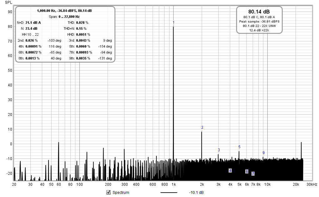

There are two separate but related issues that lead to my curiosity.
1. I observe 60Hz harmonic noise on my the power amp build I recently completed. Not high enough to be problematic, but enough to make me wonder if I could reduce them.

Do you have measuring equipment or a way to measure the hum you presently observe? Preferably any measuring technique explicitly identifies hum related frequencies, as ears are prone to misinterpreting the frequencies involved.
There are some starting points for that type sleuthing in the end appendix of the linked article: https://www.dalmura.com.au/static/Hum article.pdf
Yes, I'm using the FFT function of Room EQ Wizard. I've attached an example image.

Are you saying that the highest hum component (mains 2H), which is about -85dB of 1W level, and other related components are what you are interested in suppressing even further? I guess for starters it would be best to characterise your measurement setup with a spectrum measurement under the same conditions but with the probe connection at the amp output moved across to the 0V connection at the amp output (ie. the noise floor of the same measurement setup, including what may be being picked up by the probing arrangement).

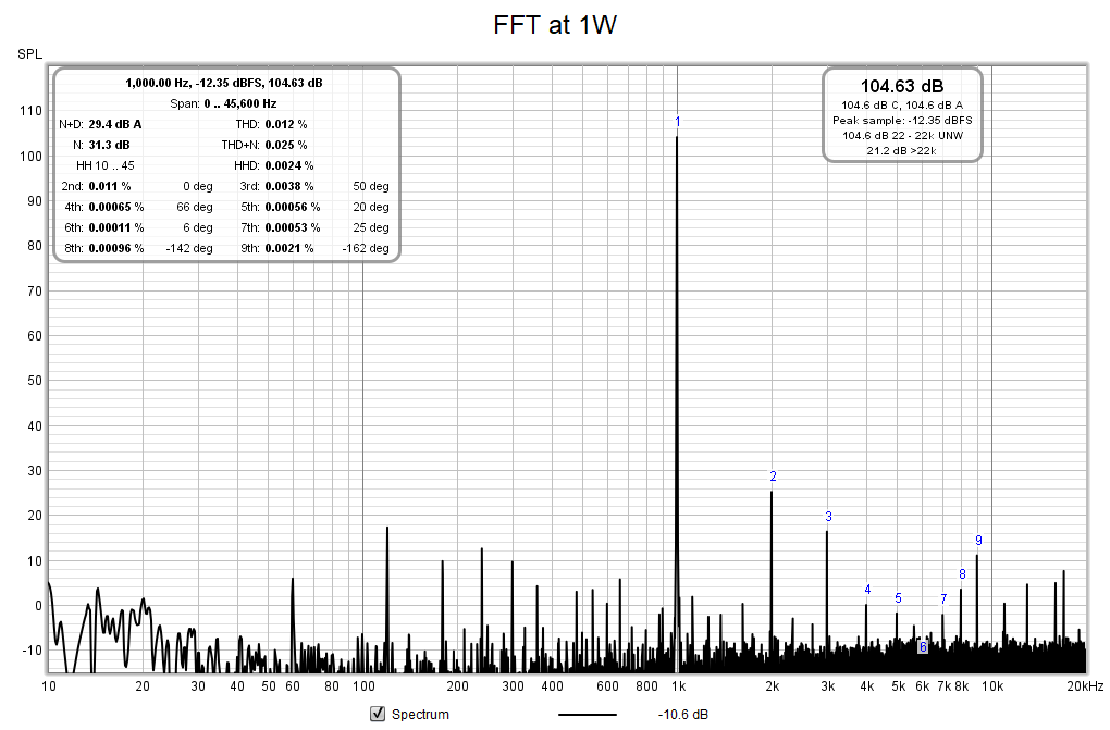

I resisted my power supply noise. I don't remember exactly, but I think the above graph was taken with spring clips on the output posts. The input to my sound card might have also been loose previously. The below graph was taken using a load box connected with proper spade lugs.
As you can see, I still have a similar noise distribution, but it's 10-15 dB down from previous. (Ignore the signal harmonic differences, I've been making adjustments).
If you have any suggestions from reducing this sort of noise further, I'm all ears. However, I'm much less worried about it than I was before. For reference, I've built a Burning Amp 3 with the diyA Universal Power Supply.

As per post #8, a benchmark measurement is the best way to confirm that a measurement plot is not just showing measurement set-up foibles.
