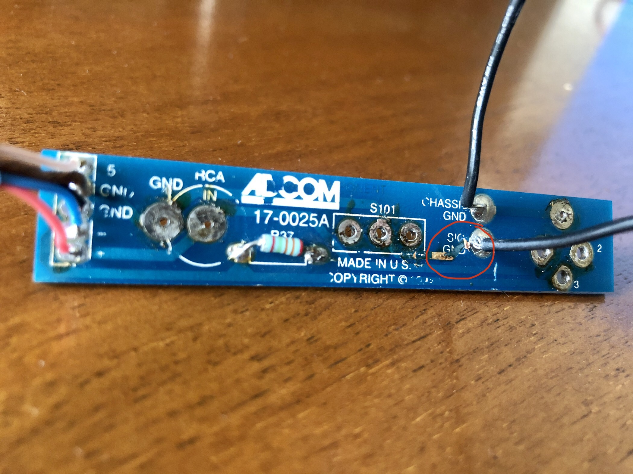

Basically for a long time I thought that the Left Channel was damaged because its at this point going full + 83VDC a the speaker output, so I de-soldered every single component and tested it and re-soldered them back, I even replaced some MOSFETs that I know usually get damaged, based on other GFA-5500s and 5800 that I have fixed, I also changed some resistors that were very close to the 1% tolerance and of course the little electrolytic caps.
It wasn't until I finished all of that yesterday that I thought, OK silly why don't you connect the right channel assembly on the left side of the power supply and vice-versa and see what happens...
Well, I'm glad I did that, it turns out that that other channel had the same behavior and the previously thought damaged channel is perfectly fine in the other side of the power supply with only 12 mV DC offset.

for start , check continuity between central GND and local GND of +/-91V supplies
check also all connections with main supply - these connecting 91V rails (pre-reg) with main rails
after that , replace all zeners, they're cheap anyway
while you're there, you can replace bridges too, they're also cheap
Thanks for your suggestions Zen Mod, well I checked all connections to ground on the power supply and they were all good....
There was only 1 thing left to disassemble and analyze, yeah, the balanced input board, I was really hesitant to do that because its a pain to remove it but I said, I must because that thing has a couple of loops to ground so I did it, and YES, that was freaking it!!!!!
An open ground, see below.... JEeeeeezzzzzzz!!!!
