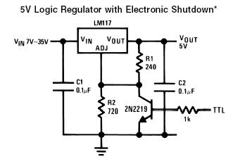

No, I didn't mean the Vref pin should be left floating. What I meant is that the Vref pin should be connected to the ground. As a consequence, the output voltage from the regulator is not zero but 1.25V (when off), which is not an issue in most cases. The picture below (taken from the National's 317 datasheet) shows a controlled regulator.

Hi borges,
I agree with Al. A separate "housekeeping " supply can leave your digital stuff running if you want. You can electrically turn it off. Milan's diagram is exactly how it is done.

Looks like I'm going to redesign the supply with regulators with enable/disable (LM2941 and LM2991). And the digital part I can keep running off a simple 7805. I don't want to run my DAC on +-1.25V.
