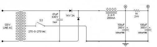

I'm building this circuit to supply plates for my amp at 315 and 305 volt. Main transfo is 275-0-275 volt.
Right now, in theory, I should get less than 300 volt at point A and B, but I get 420 volt approximately. WHY?
I should have maybe 250 volt. Am I correct?
Thank you

If there isn't enough of a load, the voltage will be higher. With no load, the filter caps will eventually charge up to 275 times 1.414 volts, about 385V for a powerline at 120V, but if your powerline is a little higher, and the 275-0-275V secondary is its voltage under load, these two factors would put the unloaded output voltage even higher to the 420V you're seeing.
There is no load right now...
Did not thought that this could cause a problem....
Should I put my tubes in and try?

Yes. Absence of load causes higher voltage.If you convinced that your amp is good you can, but better solution is putting high power resistor.
Is your transformer an old one that would have given 275/0/275 back when mains voltage was lower? Your result does not seem surprising. The resistor will develop a voltage drop only after there is current running through it. Connect your amp and the rails should come right down.
gary f said:And my power line is 125 volt AC. Very interresting

You should also try measuring the AC voltage with a true RMS meter. I believe you'll then find your AC mains at 120V or less.
