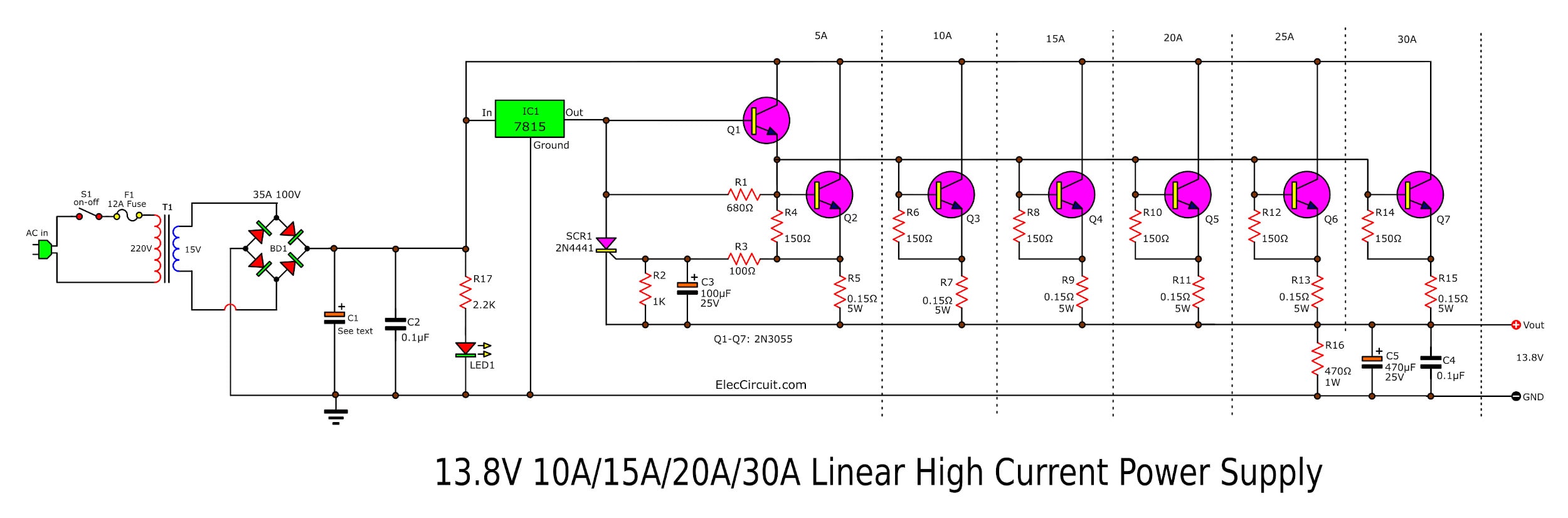

Now to the point, I want to build a 12 volt, 20 amp or so power supply to drive the Kenwood, yes I know I could by a PC supply but I want to give him a non-switching linear sup ply in keeping with his aspirations of an SQ system.
Does anyone know of a schema, plan, kit or assembled PSU that would work for this project?

Just use a battery charger, around 10 amps should be plenty, with a moderately large cap to filter the ripple.

BTW concur more like 12A or so with good caps on the output for peak loads.
you CAN NOT just use a battery charger and a cap. voltage will be around 19-20V
http://www.repeater-builder.com/astron/pdf/rs12a-bb-2000-01.pdf

That's non-sense, maximum charging voltage is 14.4 volts, more than that will destroy a 12 volt car battery. When I had a car deck running off a battery charger in my garage the only problem was excessive ripple which was minimized by adding more capacitance. I used that setup for a couple of years with no issues.
Mike
You might try looking for a used 12v Astron power supply on Craigslist, they are popular with the ham radio folks.

Great info/options/discussion guys, thanks. I don't really like the idea of a battery charger as a long term solution so I'II buy the kid an Astron linear supply...model to be decided.

Slight change of plan, I picked up a 50 watt/channel vintage Rotel power amp at
the local swap meet...used for sure but sounds fine. So the Kenwood H/U will only be used as a Media Centre/pre-amp out to the Rotel.
In this case it makes sense to me that since the Kenwood's power amplifier is no longer in use the total PSU current requirements are reduced and we can concentrate to a higher degree on a high quality, low/medium current supply to power the Media Centre/pre-amp functions being used.
Make sense?
K.S.
Make sense?
