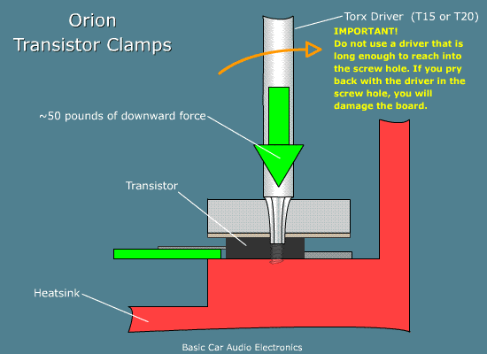

if anyone has worked on this model amp, they should know of the double sided tape orion used to hold the fets to the retaining rail that screws down onto the heatsink....this is where my headaches started....
like an idiot i tried to remove the securing rail off the fets again, the tape stuck just like the first time and some of the power supply fets got destroyed again...the fets are smp60n06-18 ( i cant find datasheets on these fellas either)
so now i have two 225 hcca's that are scrap, just to see what happens i replaced the damaged fets on the second amp and the same thing happened -power supply fets fried immediately after connecting power.....i tried ssp60n06 and rfp70n06 but both types blew, i then tried taking the remaining good fets(the original ones) from one amp and transferred them to the other, same thing happened...
so my question is what is causing this? do i need to disconnect the drive transistor in the output section- connect power-disconnect power- then reconnect the drive transistor?

When you initially pulled the transistors off of the clamp, you likely wedged a screwdriver between the clamp and the tab of the transistor. This can rarely be done without destroying the transistors. What you need to do next time is this...
While the board is still screwed down, pull the screws out of the clamps and insert a T20 driver in the hole in the clamp. Be sure that the driver does not extend down into the hole in the heatsink. While applying at least 50 pounds of downward pressure, pry back away from the center of the board. Start in the holes near the ends and work your way down the clamp. You will rarely break transistors when you do it this way. If you are applying enough downward force, the transistors will remain flat on the heatsink while the clamp pulls away. See atached image.
