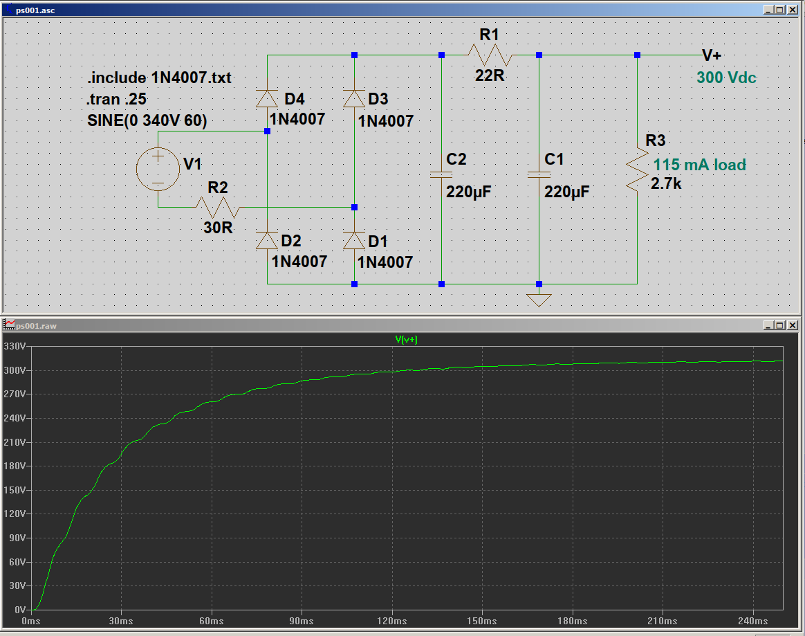

The attachment is a power supply I designed for one of my projects, using an inexpensive Triad N-68X mains isolation transformer, wired backwards to step 120 V AC up to about 240 V DC.
There is a lot of DC resistance in the little N-68X, on both primary and secondary sides. All of that is lumped into the 30 ohm series resistor in the schematic. It's not entirely a bad thing to have this series resistance, as it keeps inrush currents at start-up under control.
With two 220uF filter caps and the little 22R series resistor, LTSpice says output ripple is only about 1 volt peak-to-peak, riding on somewhere around 300 volts DC. About 3% ripple. That's with R3 (representing the guitar amp) drawing 115 mA from B+.
DC voltage drop in the 22R resistor averages only about 3 volts once the caps have finished charging, and the PSU has settled down to steady-state conditions. That's only about one percent of B+ lost to the series resistor.

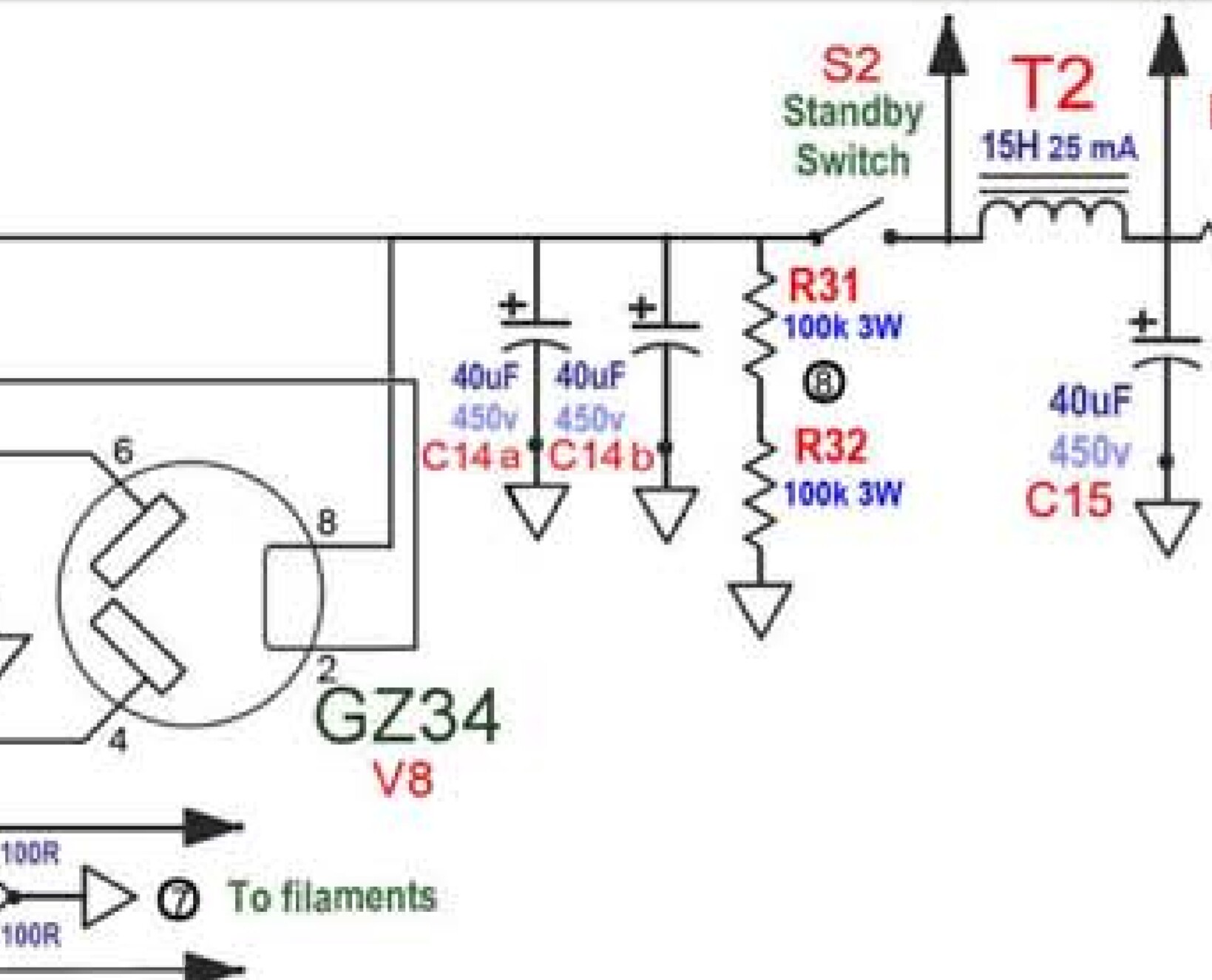

That's interesting. While working on this, i dug through a pile of schematics, and pretty much every amp with a P-P output stage at 22W or better has a choke in the PS. Even "modern" (okay, not so modern anymore) stuff like Soldano and Mesa. But then again, those have their roots deep in Marshall and Fender, so I suppose that's to be expected.
Mesa is the one that I find interesting. Smith's "make it repeatable/identical/predictable/reliable" ethos implies that everything in the amp is there for a very specific purpose (yes, even if it makes the circuit highly complicated). So if a choke and a resistor give identical results, why would he choose to continue using chokes?

I redesigned without a choke, and this seems pretty solid. 7V ripple on a 463V supply, or about 1.5%. The 400V node has 0.05%, and it's not measurable at the 300V node. If I drop down to 50uF at the reservoir, ripple goes up to 3.2%, which still seems reasonable for the power tubes, but as long as I'm saving money on the choke ... 😀
(For giggles, using 8uF results in 93V of ripple. Nnnnnnope.)

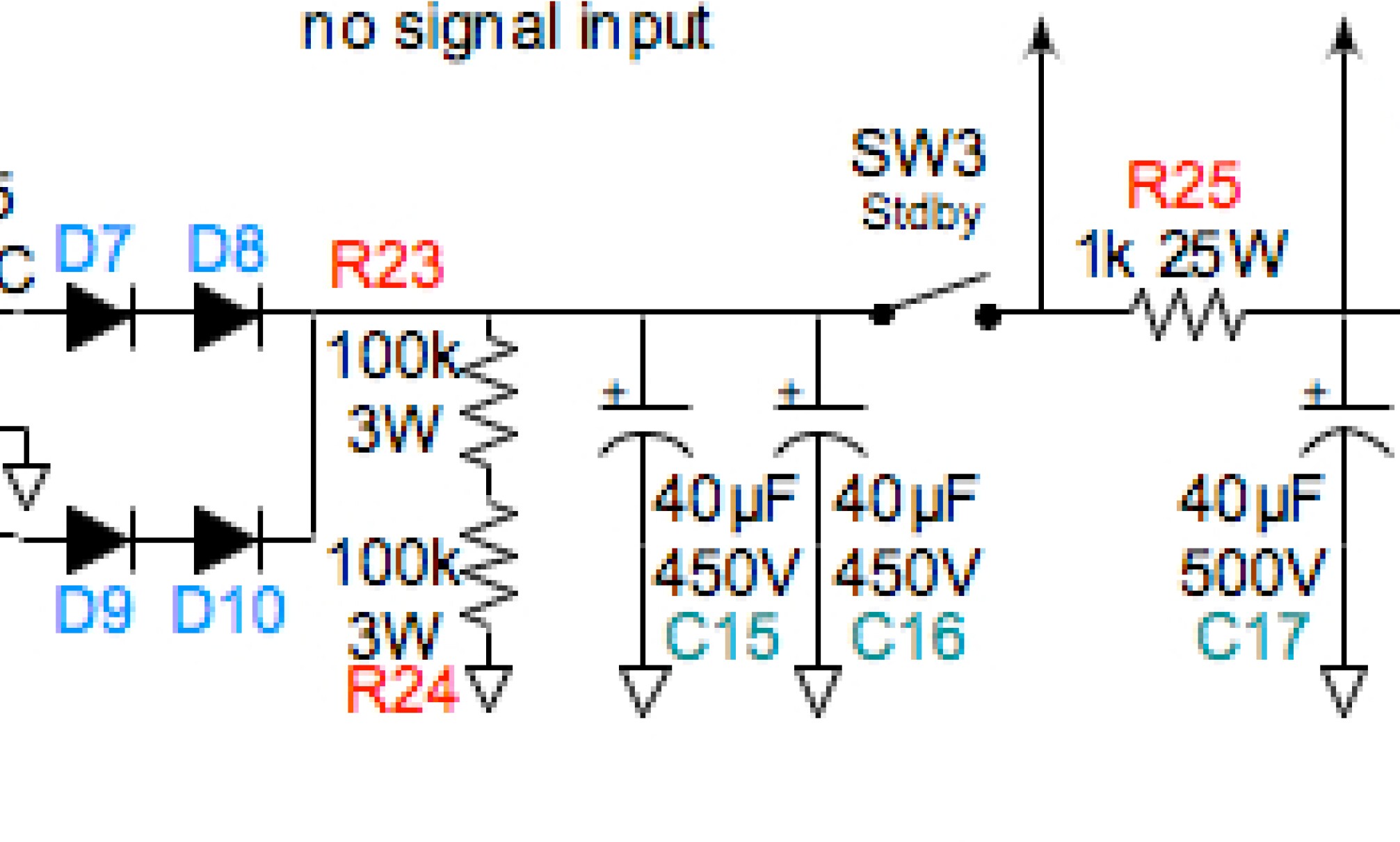

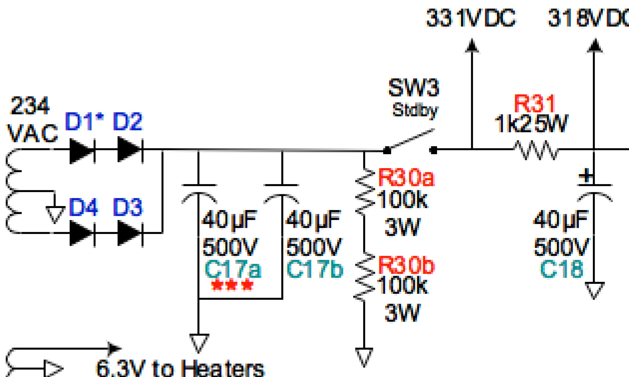

Nostalgia is definitely a factor when building/modding/designing guitar amps, at least to many. Trainwreck Rocket amps (I've built many of my own variants) use a 15H 25mA choke after B+1. The chokes are not that large compared to the power and output transformers in these amps, and don't add to the hum (though careful adjustment of the relationship of the PT and OT will reduce hum). It uses a GZ34 rectifier, and subject to much discussion, 80uF of filtering after the tube, before standby switch. Concerns over quality of new production tubes has caused some to reduce filtering, and others like myself to provide diode protection. The Rocket was designed to not be stiff, and to be very pedal-friendly.
The TW Express and Liverpool models use a 1k 25W resistor after B+1, which gets quite warm in operation. They are SS rectified and are intended to be stiffer.
Marshall style amps I've built also use chokes from 4 to 10H. I think the use of diodes, tubes, chokes or resistors all add valid characteristics to the amp's tone and response.

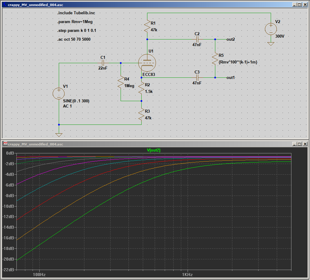

And then, quite recently, on another diyAudio thread, someone posted details of an absolutely terrible post-phase splitter master volume. This particular circuit simply doesn't work as intended - it is actually a variable bass cut, rather than a master volume. The massive flaw was spotted by another diyAudio member, jjasniew.
I threw together an LTSpice simulation to demonstrate how badly the circuit worked, and posted something along the lines of "Who on earth designed that monstrosity?" I was then informed that the circuit had been designed and made famous by Ken Fischer. Yikes! Either he had a very bad day (and never looked back long enough to fix it), or he really didn't understand very well what he was doing.
Looking at the circuit, it seemed pretty evident that the designer did not understand the concept of output impedance of a triode gain stage, or how that interacted with the coupling caps and potentiometer that made up the rest of the circuit. If you understood such things (which any first-year electronics engineering student should), it was easy to fix the flaw. I added two resistors to fix it, and before-and-after LTSpice simulations confirmed the problem, and the fix.

The version which stinks is attached...I'm afraid I dunno what it's called by Trainwreck cognoscenti.
This circuit is supposed to be a master volume, but is actually a variable bass cut, as you can see from the simulated LTSpice frequency responses. It does very little above 500 Hz, and virtually nothing above 1 kHz.
In the attached screenshot, R5 is the 1M logarithmic "master volume" pot; the equations next to it, along with a couple of SPICE commands at top left, allow LTSpice to "turn the pot" in equal increments of rotation, so we can see the resulting frequency responses.
I don't think the forum software allows us to attach images to private messages, so I took the liberty of going slightly off-topic with this post. 😱
Not to further contribute to topic drift, but it's my thread, so ... 😀
It's called a "Type-3", and the theory is to progressively blend the inverted signals to effect cancellation. To be clear, though: in the offending schematic that I posted, I didn't implement it correctly. I placed the pot before the grid leaks, and Fischer's design had it after. It seems like that would make a difference; if I understand correctly, that the grid leak provides the input impedance, which would mitigate the issue at hand. So mea culpa.
All that said, I ended up implementing a Lar-Mar, which is more theoretically sound (but with several more components), which worked out really great.
