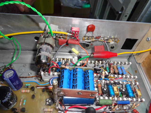

Quick update on this... after trying a 100r resistor in various positions and still getting instability I stripped the amp back. By that I mean I removed the tone control circuitry, de-coupled the gain stage from HT/B+ and powered it up - quiet as a mouse, all good. One other thing I did was to tidy the ground bus up.
The challenge now is to re-fit the tone controls + volume control and retain stability. I'm really not enamoured with the tone controls and would probably leave them off if it wasn't for the chassis already having been drilled and painted. There is/are too many de-coupling caps for my liking,also de-coupling the three triodes from the HT/B+ supply presents a challenge, I'm toying with idea of supplying them from a simple regulated supply. One final issue to be solved is where to place the volume pot - before or after the tone stack?

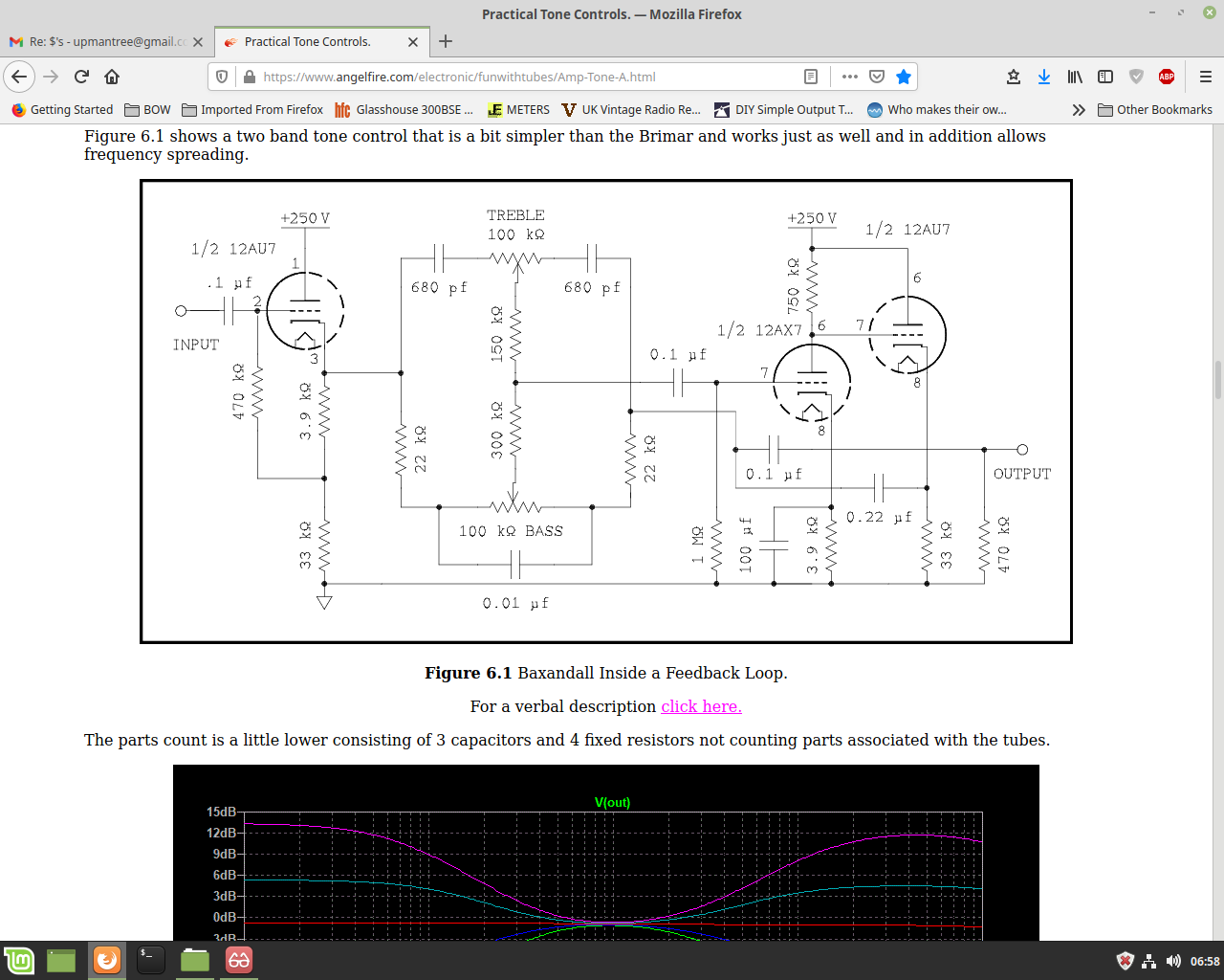

Here's the tone stack schematic attached, I'll re-draw the amp schematic later today and post. Andy.

I
n guitar amps (I've seen) the volume is normally after the tone stack.

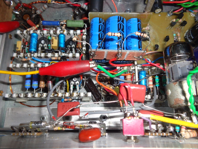

This is what I've done Tom.
I put it all back together yesterday, not a whistle, chirp or other euphemism for oscillation. I've either done something right or the Gods feel benevolent at present.
I improved the HT decoupling - those three blue caps - and improved the ground bus. HT wise now all individual stages are de-coupled apart from the tone control hi gain stage and OP CF, which have one stage. Trying to fit all this in is a nightmare, there's plenty of room, but it's in the wrong place. One more ting, I re-jigged the tone control de-coupling too.
What the cause of the oscillation was I'm still not 100% sure - resonant HT PSU, sloppy de-coupling,iffy layout and ground bus loopyness? Anyhoo, main thing it seems to be fixed.....for now. Thanks for all your help, Andy.
