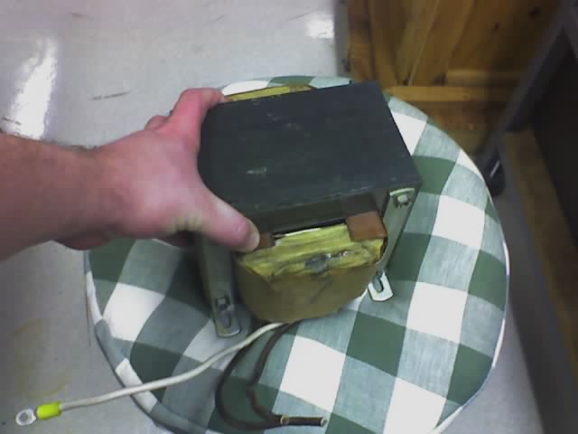

Any of you that have read the dumpster dive thread know by now that I have come across a ~2KVA CT isolation transformer for free! I would love to use this in a psu for the LM4702 based amps I am planning, but the rectified voltage will be higher than what I was aiming for. By my math, I can expect ~+/-85V rails using a "traditional" bridge/cap non-regulated PSU, but for this project I was thinking ~+/-50V would be closer to my target. I would think that using a simple voltage divider would be pretty inefficient 🙂)), so I am trying to get a few ideas from more experienced power supply builders.
AudioFreak suggested a choke input power supply that would pump out ~51V, but I was under the impression (after reading the few internet references I could find, coupled with the fact that I may not know exactly what I am looking for) that this sort of PS was used primarily in tube amps or for higher voltage applications. Would this configuration be appropriate for an LM4702 type system, or is there some other option for getting the voltage from this transformer dropped down a little? Also, I have only come across a couple of schematics for choke input power supplies, and they are for higher voltage supplies (around 4k). If anybody has some suggestions as to whether a design of this type would be appropriate, and where I could read some more to intelligently go about building a power supply, I would greatly appreciate it!

I can't think of any reason that a choke input supply couldn't be used here (but I can't think of everything 🙄 ) The reason they are more common in tube amps probably has as much to do with era than anything else. They provide good regulation without active regulation, but these days (and at lower voltages) I suspect that active regulation is cheaper and looks better on paper. OTOH, in the case of tube amps I have found that a simple choke input supply usually sounds better. Chip amps seem to respond well to simpler supplies, so I suspect that they might sound better with choke input than active regulation. (I won't pretend to understand why, but that doesn't keep me from using the knowledge.)
Anyway, there are a couple of criteria that need to be met in order to keep a choke input supply from acting like a cap input supply. In other words, to keep the voltage from rising. In technical terms, you need to keep the diodes conducting during a full 180 degrees of each 60Hz cycle. If they conduct only during part of the cycle to keep the caps charged then the supply voltage will go up as it starts to act like a cap input.
In practical terms, it means that you need to makes sure the choke is big enough and that you always draw enough current. The old rule of thumb is that the inductance of the choke needs to be at least:
L > V/I
where I is in milliamps (a throwback to high voltage, low current supplies.) Anyway, you can see that if you draw more current (bigger I) then you can get away with a smaller choke.
As an example, with V=50 and I = 500mA you need a choke that is at least
L > 50/500 = .1 henry or 100mH
Typically, if your choke is close to the lower limit then you would want to add bleed resistors from each rail to ground to make sure that the minimum current is always being drawn from the supply.
You could use one choke between the center tap and ground. You could use two chokes, one in each rail (the inductances will add) or you could use a dual winding choke with one winding in each rail.
Hope that's enough to get you started thinking at least.

This is just what I wanted to hear! I guess we will see whether this is indeed a good design for chipamps (if you can even call the LM4702 a chipamp--more of a hybrid IMHO). I will be sure to run a preliminary circuit by the board before building/ordering parts, but I think it is time I committed some serious time to understanding this circuit and making sure I have a good design.
Thanks for the insight, Dave.
I_Forgot said:
If all you want to do is lower the voltage all you have to do is put some extra turns of wire onto the secondary.
Well, that isn't going to be as easy as one would like. I would rather modify the PSU design than the transformer. 😀
