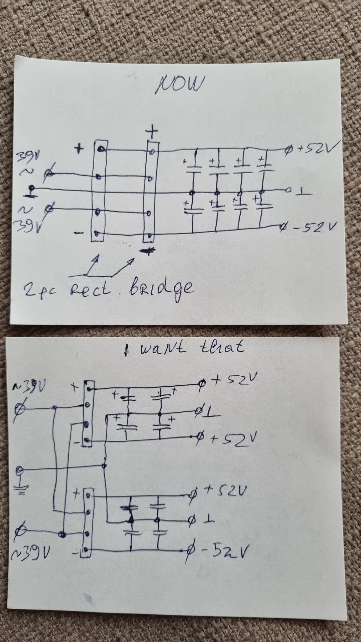

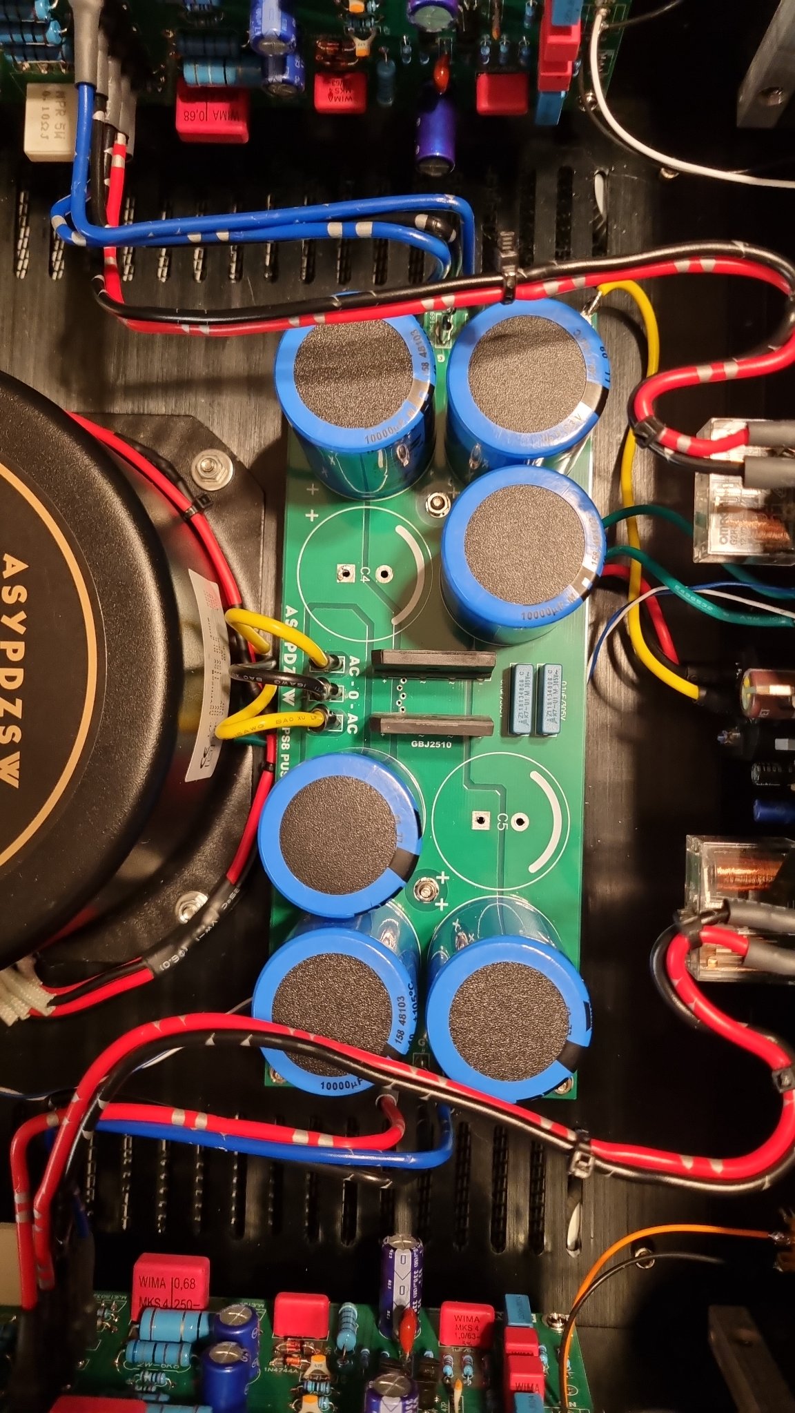

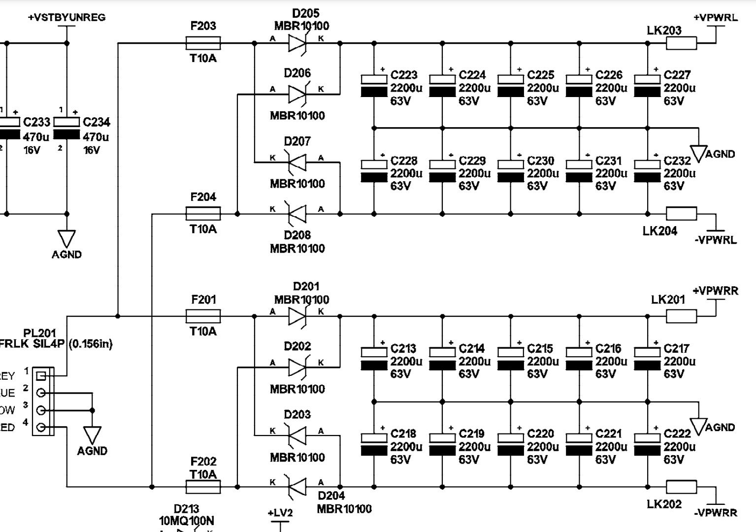

I bought a copy of Dartzeel. The power supply is strange. It seems to be separate for both channels, but in fact the two bridge rectifiers are connected in parallel and all the capacitors are on both arms for plus and minus.
I want to split the power supply between the two channels like the diagram below. (without the fuses)
Won't the two rectifiers "interfere" with each other?
