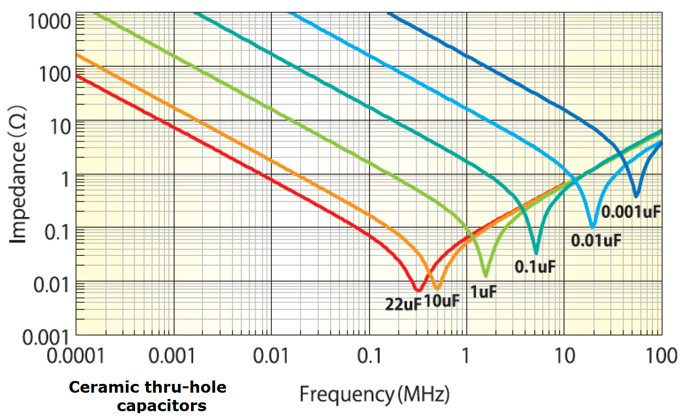

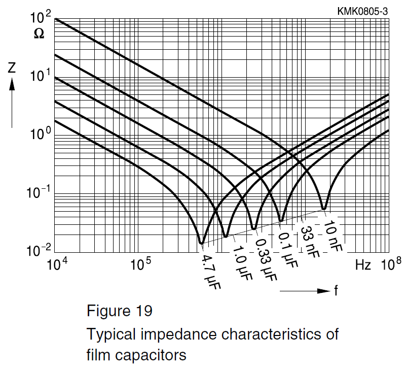

ESR is important, but the inductance, and the resulting self-resonant frequency, is very important for bypass use. It's very hard to beat surface mount ceramic caps for low inductance.
ceramic through hole from those plots show 1uF 0r011 @ 1M5Hz and 0.1uF 0r030 @ 5M2Hz
whereas film shows 1uF 0r018 @ 1M2Hz and 0.1uF 0r034 @ 5M1Hz.
That seems to indicate that these two examples are very similar, rather than very different.
Could the leads of the through hole have such high inherent inductance that this swamps the other parameters?
Would this indicate even more that short leads are important?
