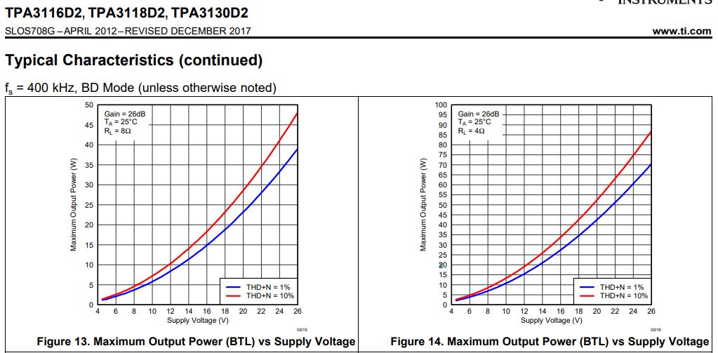

Based on the datasheet of TPA3116 for 15W per channel for 4 Om I need around 12V and 3A.

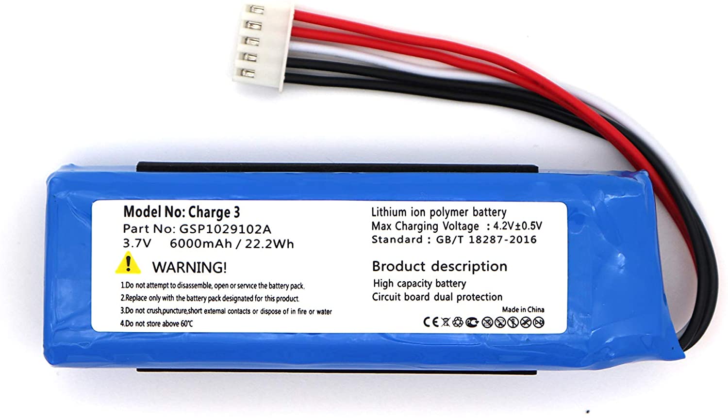

I found speaker from JBL with similar characteristics, JBL Charge 3.
Output power 10W per channel or 20W total.
Battery has 3.7V and capacity 6000 mAh.
Amplifier TPA3118
attachment.php
attachment.php
Based on datasheet for 10W clear sound need 10V for 4 Om. That means they use step-up module.

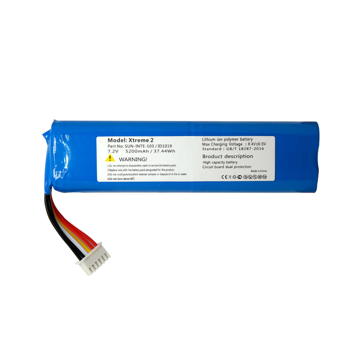

Another example JBL Extreme 2.
Output power 20W per channel or 40W total.
Battery has 7.2V and capacity 5200 mAh.
Amplifier TPA3116 (as I could find)
attachment.php
Based on datasheet for 20W clear sound per channel need 14V for 4 Om. That means they use step-up module too.

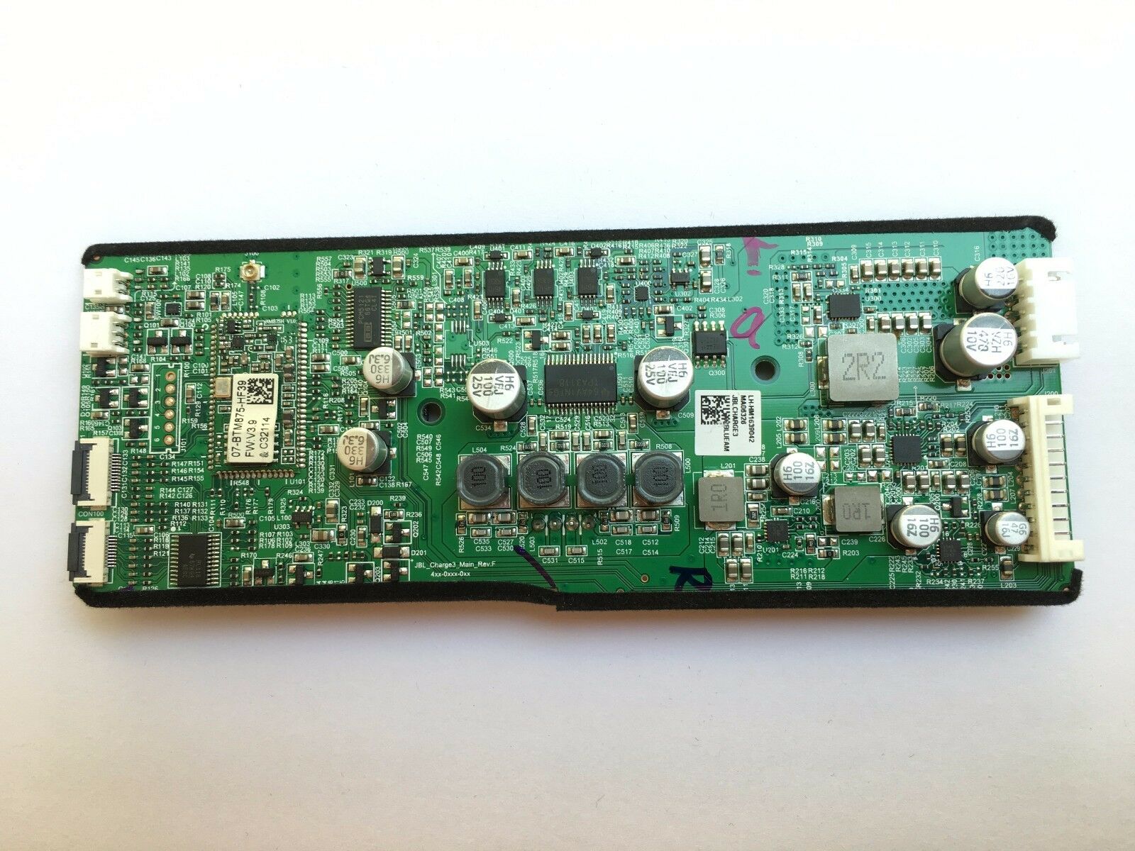

How does it work on those speakers?

As to the JBL speakers, unless they're tested we won't know what the numbers actually are. In any case, they seem to be using a much higher quality booster design on what seems to be at least a 4-layer board, instead of a dubiously designed single chip on a sloppy PCB. So in any case their result will be better than what you can achieve. Things change quite a lot when you go from 85% to 95% efficiency.
