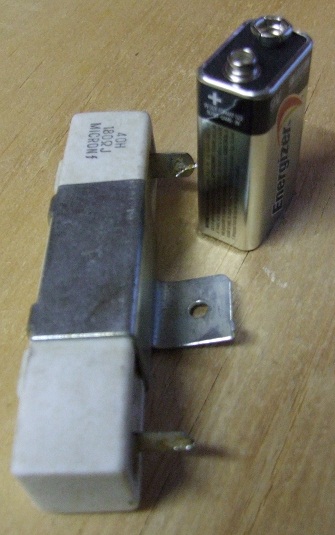

I was asked about power resistor inductance and whether it's an issue in spaker crossovers or not. I ran the MLSSA through its paces on some items in my parts box in the past, I think the attached tells the tale.
Thought I'd share it here.

Interesting...any "non-inductive" wirewound available?
Yes indeed, for example the Dale NH series. Mills resistors claim non inductance as well.
Unfortunately I had neither available to measure.
Dave
Very interesting, Dave. Nothing like actually doing it, eh? 🙂
Am I right in thinking the tale it tells is not to fret about inductance in wirewounds or metal film? This was something that bothered me when I used them in amplifiers.
A few uH is nothing compared to the typical 0.05mH Le inductance of a tweeter. 😎
It makes sense. Resistors are designed to be used at much higher frequencies than we ever use in audio. The double winding technique is designed to cancel out most coil inductance. I had a look at some cables too, and again the self and mutual inductance was an order of magnitude lower than tweeter inductance even with 10 metre runs at audio frequencies.

Hi Steve,
Interesting thing is that none of these even had the non-inductive wind (where the wire is folded back and then wound clock and counterclockwise simultaneously to canel inductance).
The way I like to look at it is that for woofers or mids, the self inductance of these has absolutely no quantifiable impact. For tweeters, at most its equivalent to changing toe in of the speaker maybe at most a degree or two.
I modeled the Vishay RH-25 inductance for the speakers I posted earlier in the week. It affected the response at 10kHz by at most 0.03 dB. I'm sleeping prettty soundly with the choice. 🙂

There is no such thing as inductance (external) of a straight piece of wire. A straight piece of wire will have 15 nH per foot internal inductance, but not external. What you measured was the inductance of the complete circuit loop including the wire being measured. A 3 foot length of any wire should have measured 45 nH, not 1270 nH.
More apropos would be the measurement of lengths of zip, as that should be in the 180 to 200 nH per foot range.
jn
18 gauge diameter is 0.1024 cm, from
American wire gauge - Wikipedia, the free encyclopedia
Plugging that into a wire inductance calculator assuming approximately 90cm length:
Inductance of a Straight Wire: A Calculator
Expected result is 1334 nH. MLSSA measured 1270nH, pretty close.
Another place in audio that resistor inductance is significant, is loudspeaker crossover networks.
Values used in crossover networks are usually between 1R (tweeter L-pads) and about 22R (shunt RC across woofer)Another place in audio that resistor inductance is significant, is loudspeaker crossover networks.
This range does not require too many turns and hence has small values of inductance (10s of uH), that just will not be significant at 20kHz
