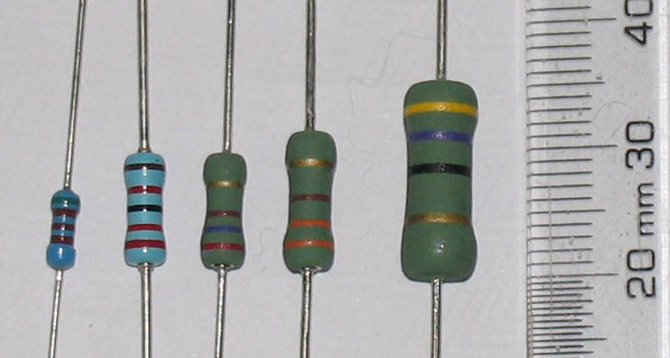

For your average colour band type, power rating isn't stated, you "just know" by looking at their physical size.
To help, here's a piccie of some different ratings.
From left to right:-
1/4W metal film, 1/2W metal film, 1W, 2W, 3W carbon film.
Hope this helps

YOU KNOW....WHEN I FIRST POSted...sorry...anyway...i thought the answer would be in the colour of the resistors because i noticed that most of my big resistors..in size not ohms....were green the other smaller ones were blue or red or...well i was hoping there was a sure fire way of telling....guess that would make life to easy:att'n: ....AND WE JUST CANT HAVE THAT CAN WE😡
thanks anyway...ill print out the image...be quite handy to have around when im looking for a certain resistor...thanks....

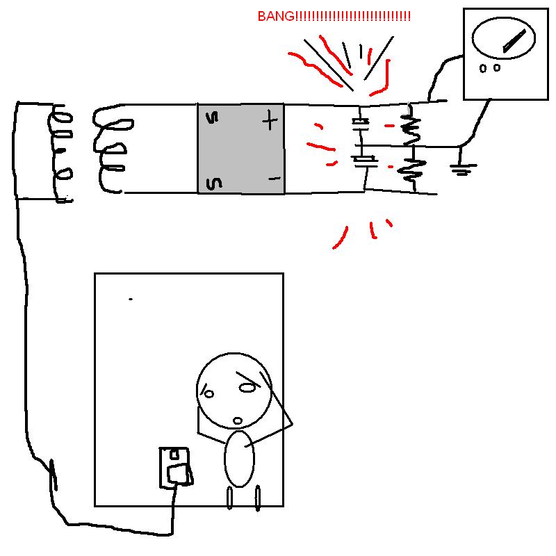

ok all those self problaimed experts here is one for you.....there is a schematic linked of what im talking about....i had a transformer....about37Vac linked to a full wavbridge that leed to 2200uf capacitors rated at 50v...ok and 5k draining the caps....so when i turned the whole thing on ...the ground to positive rail measured 14volts dc...then 13.9...then 13.8.........when it finally got down to around 10volts dc the damn caps blew up.....lucky for me i had baracaded myself behind a shelf......(to get to the switch...hmmmm thank u lord...) anyway pop!!!and suddenly the caps went to cap heaven.....why....why did they have to leave me??????????:bawling:
i got a little carried away with the schematic...sorry....:angel: :bawling:

Caps go bang when the leakage current through them is too high. That will happen if the polarity is reversed, or if their voltage rating is exceeded.
Don't forget that the DC across those caps will be nearly 1.5 x the AC into the rectifier. Also the AC voltage may be 20% higher than specified with no load current being taken.

The caps almost certainly were connected reverse polarity.
The sequence of events, time line, and the consequence says this is most likely.

ok... :cannotbe: now that u mention it...the caps were connected in revers.....man!!!its cause when i kept flipping the breadboard round ...up down....alittle to the left!!!...i guess i must have gotten the rails the wrong way round........i drew schematics on the non copper side before soldering so i had to keep flipping to solder.....man i gotta learn how to make pcb.....also u should see how crap my finished peices look...hmm...ah well.....
