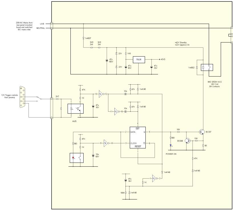

Hello Alexcd,
I must say that this circuit looks very familiar! While you've changed some details of the main relay drive and added the extra speaker delay, the heart of the circuit is identical to my one here: http://www.mhennessy.f9.co.uk/gainclone/control.htm
There's a couple of points to explain to anyone looking - mainly the purpose of R3/D9 and R10/D10. In my circuit, each of those diodes is an LED - Standby and On, respectively. Also, R3 should be 560 ohms (not 560K). If you're not using the LED's, omit all of these components. Alternatively, correct the diagram to show that these are in fact LEDs, and change R3 if you want the standby LED to light 🙂
I'm not sure why you are using MOSFETs to drive the relays - perhaps a personal preference "thing" - maybe you're more comfortable with understanding how they work? Or maybe to differentiate your version from mine. I don't know. Whatever, "normal" transistors are certainly cheaper here.
Also, I note that you've passed the "inhibit" signal via an inverter - I chose to apply that directly to the base of a transistor because you cannot guarantee how CMOS logic behaves as the PSU rails are rising; obviously you can with a simple transistor circuit.
Regarding the soft-start option, it would be very easy to add in the same way you've added the speaker delay. Refer to the previous paragraph, and consider using U13B for this function instead.
BTW, while the circuit is (a) nothing special and (b) in the public domain, it would be nice to receive a mention if you plan to use extracts from it. If you publish on a webpage, let me know and I'll happily link to it. I also assume that a Group Buy is non-commercial?
FWIW, I did a lot of testing and debugging of the circuit, and it's pretty sorted. There's even a PCB layout, but as includes my dangerous mains dropper PSU, I won't be publishing it! Future enhancements, as well as soft start, include DC protect - essential in any amplifier. Just a couple of transistors and some diodes for the detector that Douglas Self promotes - see page 421 of his book (4th edition). I couldn't include this in my version because the circuit wasn't transformer-isolated from the mains...
Hope this helps,
Mark
PS: I've included a view of the schematic that isn't available on the website sorry about the quality, I had to downsize it. Here you can see that most of the diodes should be 1n4148 or equivalent rather than the 1n4007 that you've used in many places. Keep to those for the relay coils, however 🙂

Yes, I did copy a lot of your circuit. I apologize for not mentioning this. The group buy thing was strictly non-commercial as well.
I changed the outputs to MOSFET because the current drive transistor circuit would not be adaptable for different relay coils. It may be adjusted for each user but I thought that would be too much of a hassle.
560k is a typo but I did in fact simulate it that way.
D9/10 are LED but I didn't find them quickly in PSPICE so I didn't use them. Also I used 1N4007 for the same reason. I was going to publish an accurate BOM at some point.
The additional inverter required for a soft-start is not available on the DIP14. If there is simply a larger package of inverters available I would get that and add an extra delayed output. NOTE: U13 does not exist. I used a single 6-inverter chip but PSPICE did not like me cut/pasting it around. Basically i have a lot of house keeping to do on the schematic but the idea is there.

No worries - glad to have provided some inspiration 🙂
I used a current source because of the wildly varying supply voltage, but here things are easier for you. I would stick with the original current source, as it will protect the circuit from mistakes caused by the relay being mounted off-board. Just choose a value of current that is higher than the largest anticipated relay current, then it will saturate (like a switch), but have built-in (short-term) short-circuit protection.
Yes, I wondered if that might be the case 😉
Yes, I know that you're using a hex inverter, but I was suggesting doing away with the inverter for the power-on inhibit (labelled U13B on your schematic) and using it for for the soft-start delay instead. But if you prefer not to change that, then there are myriad ways of implementing it using discrete transistors.
As an aside, have you considered a solid-state relay for the soft-start? That worked well for my A4 amp, where space was a problem. But perhaps you're trying to keep mains off the PCB?

Fair enough if you prefer MOSFETs, it's your project. But I just need to correct your statement about "wildy varying current". I was suggesting that in your application, you use the transistor as a switch, just like you're using the MOSFET. The current limit is just that - a limit.
Although the circuit looks like a current source, it's only a current source once you've reached the designated current. Choose a high current setting, and you satisfy your goals while having protection. Also, you don't need that inverter, meaning it can do something else.
Of course, those 180 ohm resistors skew your argument somewhat! I assume each user will have to calculate the value according to their relay? Which is actually no different than choosing a resistor in a current source!
You can add a capacitor to provide different currents for pull-in and hold-in, but this introduces even more variables if you plan to let others choose their relay...

I should point out that I strongly believe in high value, low-cost engineering! Anyone can come up with an OTT circuit that achieves a function, but the real skill comes in careful pruning and parts selection. A few small changes to the topology here and there might also facilitate other savings. Designing down to a price while not compromising reliabilty and functionality is a real skill that is increasingly rare these days. Note that this a lot more subtle than just removing parts until it stops working!
Examples: According to Mouser, that MOSFET costs $1.22. A BC337 costs $0.05! (Disclaimer - you might need a bigger tranistor and a heatsink if you plan to use it as a current source rather than a switch. But there's no need to run the source as a source, as I've repeatedly said).
You'll note that the changes I've suggested are implemented with BJTs and passive components that cost pennies. In return, think of the benefits: DC protection - how expensive are your woofers? Do you really want the endless emails from people who have zapped that expensive MOSFET because they've hooked up the relay while the power is applied?
And sometimes you save costs by adding components! Notice the 1K resistor in series with the switch contacts? R2 in your diagram. I added that to prolong the life of the switch contacts. Likewise D7/D8: the intrinsic diodes in the IC will perform the same function, but eventually they'll fail short/circuit, rendering the IC useless. On the PCB, I added extra diodes across R1/R5 for the same reason (must update that schematic).
Incidentally, an instant cost saving is to swap M5 for a NPN general purpose transistor of your choice - BC548/2N3904 or whatever you have in your parts bin - no other circuit changes required. Instant saving of what - $0.25. Again for M8. And as I said above, a LDO regulator does nothing for this - stick to a 78L05. Mouser have these for as little as $0.18!
Final point - you seem to be worried about investing time and money in this part of an amp. IMO, this is actually one of the most important parts to get right. Don't underestimate the ergonomic "interface" between the amp and the user. Soft-touch or remote switching is nice, as you've identified. Also nice is freedom from clicks, pops and bangs. Essential (IMO) to prevent the amp destroying loudspeakers. This "auxillary" stuff takes time and effort to get right, but it's well worth it.
Anyway, enough ramblings - please remember this is advice, not critism - hopefully to give you an insight into how I do this stuff, and maybe to save you money the long run in return for some intellectual investment at this stage. But ultimately, it's just IMO, and YMMV!

Ah yes - I've looked again, and see that those 180 ohm resistors are representing the coils. I saw the inductors and assumed they were the in fact the relay coils. Sorry about that 🙂
What voltage are the coils? 12? If so, perhaps the easiest solution is to use a 7812 to regulate the coil supply - but it will need a heatsink, as 4 lots of 180 in parallel will take ~266mA at 12V. With 17V nominal in, a 7812 will generate 1.3W, which is a surprising amount to lose...
I presume 17V comes from 12VAC times root-2? If so, expect the real value to measure higher... If you don't want to regulate to 12V, then putting a resistor in series with each relay coil will spread that 1.3 watts around - each resistor will dissipate around 0.3W. I would employ 1W resistors here, at least, to ensure long-term reliability. Of course, the trouble is that the users will have to calculate the value of series resistors - not difficult, but one more "variable"...
The BC337 I mentioned before is rated for 800mA, but can't dissipate much power because it's in a TO92 case. In normal use, it won't get hot, but in the event of a short (when it enters current limit mode), it will obviously warm up. The protection offered should be considered very short-term only (someone playing with the connections while it's powered). If you want a better "margin", consider a TO220 device like a TIP31, but the HFE is lower, meaning that the series 10K will need to be lowered.
