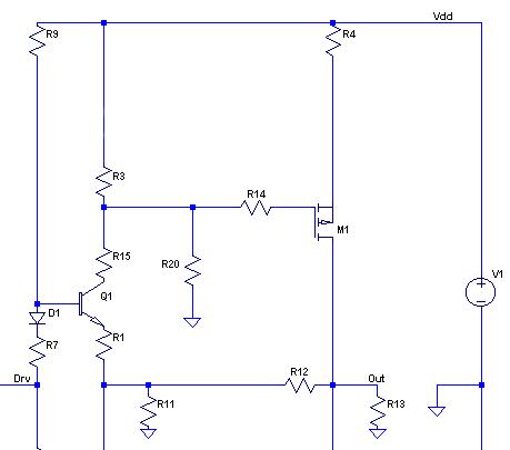

While working in another project, I came across the need to build a MOS output stage based on a previous idea I later found to be already in use, more precisely in the Tiger line. Sziklai pairs as known were pointed to me by Tube Dude while AKSA provided valuable insight in his own experience with the configuration.
The first thing that struck me with the Tiger topology was the low gate source resistor values used, implying high dissipation in the driver devices. The low frequency pole caused by the high MOS input capacitance (typically 500p to 1nF depending on device size) can be pushed as in the Tiger case with a low resistor value, but this problem can be circumvented in my experience with higher overall loop gain and negative feedback, as well as mitigated by lead compensation at the driver input.
The other problem and much more serious as I was to learn in practice, is the effect of the high gate capacitance when the driver transistor goes from the off condition to on, forcing the feedback to push hard during crossover. The crossover glitch is almost impossible to overcome unless some form of standby biasing independent of driver transistor condition is applied, and this I did in the circuit shown (only upper half, the other is complementary symmetric) with resistor R20 from gate to ground for the time being, though this actual implementation cannot be considered adequate from the stability and repeatability standpoint. The lower MOS gm make this kind of source resistance stabilization (by R4) not nearly as good as the equivalent configuration with bipolar transistors (in my humble oppinion).

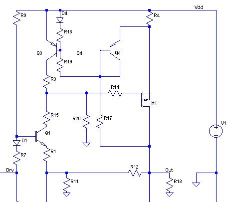

With this in mind, and pondering about output device protection desirably including some simple approach to SOA, I devised the circuit shown in the next posts. I do not know whether this topology has been proposed before, simulations look promising and I am planning to actually test it in the future once I have time for it.
Biasing circuit
To achieve permanent operation in the active region, a feedback mechanism is provided through the source resistor R4, Q5 and Q3. To allow use of low source resistors, it was selected the common base differential pair configuration. It is easy to see under no M1 source current, Q5 takes most of the current from R17 leaving Q3 almost cutoff and freeing M1 gate through R3 to be pulled down by R20 thus turning it into conduction. Once a voltage drop develops in the source resistor R4, Q3 begins to conduct more rising M1 gate through R3, thus closing the negative feedback loop. D4 provides a threshold to improve gain for a given current setting.
It is easy to adjust minimum device current with standard value resistors and simulations show the added circuitry has no effect on overall amplifier performance.
In the next post, the added protection circuitry.

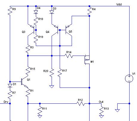

Basic protection.
With the addition of Q4 and D3, it is possible to provide current limiting and a rudimentary Safe Operating Area protection. Because of D3, Q4 starts to conduct with a voltage drop through the source resistor R4 much greater than needed by Q3 to operate the biasing loop. The basic operation is nonetheless the same, restricting source current to limit dependent on the source resistor value though finer adjustment can be achieved with added complexity.
Note R17 is not returned to a fixed voltage, but to the output itself. This way, when the output swings high when the amplifier is not loaded or loaded within nominal limits, less current is available for operating the protection, yet if the output is stuck to ground (or –V) there is much more current available, thus roughly tracking a power dissipation limit rather than strictly a current limit.
I should like to hear from members for comments about this circuit, and whether something just like this has been done before.

HI Rodolfo,
That's 1 complex circuit!!
I'm not sure that protection is altogether a good thing here....... you don't have SOAR failures with mosfets, and overcurrent is relatively easily covered with a reasonable sized fuse.
How about replacing R20 in your original diagram with a current source to the opposite rail? You could then delete R15 and R1. In fact, degeneration of the driver should not generally exceed about 22R. This will improve stability, but reduce feedback factor.
Hugh
AKSA said:
HI Rodolfo,
...you don't have SOAR failures with mosfets, and overcurrent is relatively easily covered with a reasonable sized fuse....
Yes, I expressed myself wrong, I want to address a situation where maximum current is not exceeded but because of overload, device dissipation does.
How about replacing R20 in your original diagram with a current source to the opposite rail? You could then delete R15 and R1. ..
Hugh
Replacing R20 with a current source goes a long way to make biasing independent on supply voltage. Yet I think an active biasing scheme is better suited because of the mentioned lower gm of MOSFETS. R15 is there simply for luck. (Well seriously, to divert power dissipation from Q1).
Rodolfo

AKSA said:
....Thus, Rodolfo, I applaud your efforts and would encourage you to continue. A bit more simplification and you might have it.
.....Hugh
Many thanks for your comments Hugh.
I'm afraid this circuit cannot be simplified too much while keeping an active control of minimum device current for reasons I will try to put as clearly as I am able to do.
To have active control, it is necessary to measure device current, and probably the easiest way is by the customary voltage drop on a series low value resistor.
We also want to control a low current (50 -200 mA or thereabouts), and at the same time do not want to have an excessive voltage drop at peak working current (5 - 10 - 20 A, whatever the design power output) depriving of maximum PSU capability and forcing excessive heat dissipation on the sensing resistor.
The combination of both requisites implies the voltage drop under quiescent condition (or during the reverse cycle when the other device is conducting) must be in the order of tens of milivolts.
To measure reliably this voltage drop, one must resort to some form of differential comparator, and for this you need at least 2 transistors.
Now you see the proposed circuit, just for quiescent current control uses exactly 2 transistors, doing for convenience the voltage comparation at the emitter side instead of at the more frequent base side.
I wish it could be made simpler, at least I have not figured out how but may be someone comes with a cool idea in this respect.
Rodolfo
