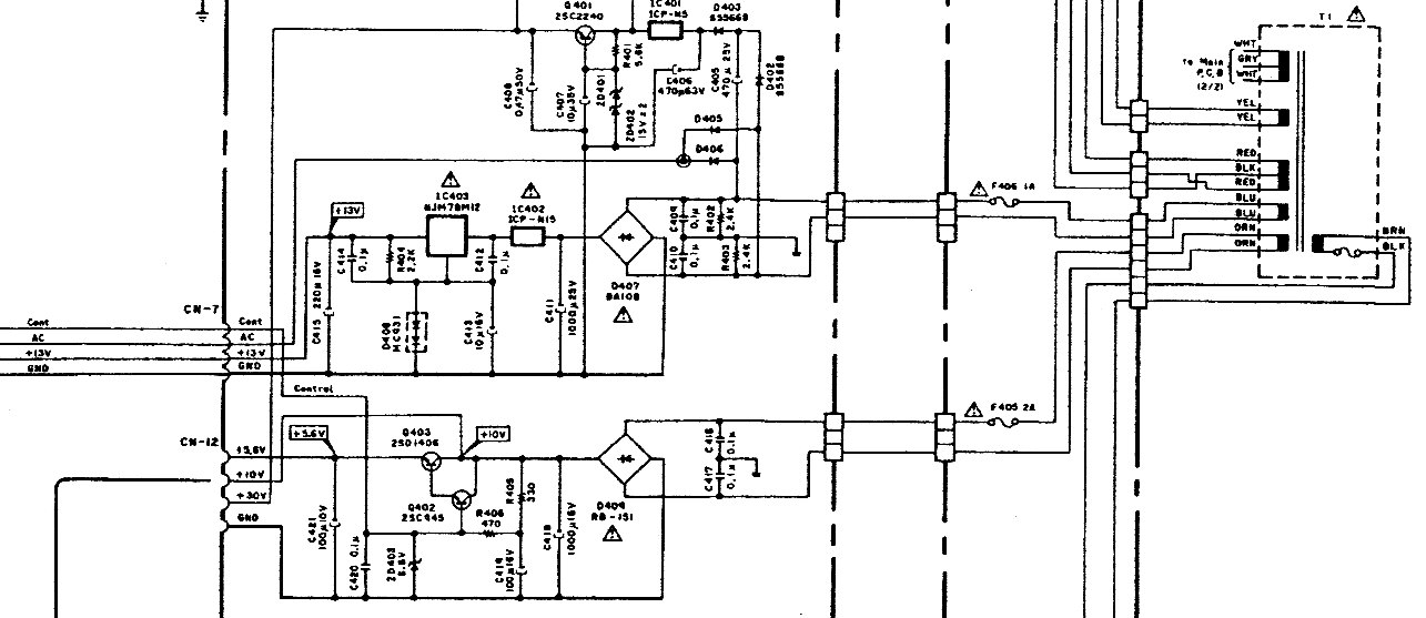

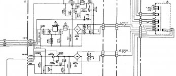

Looking at the power supply board, I'm reading bridge D409, 12VAC between the outer legs (~) and 12.7 VDC for the innter (+,-). At fuse F405, 6VAC to Ground. Seems to me the voltage is coming off too high from the bridge (should be 10V?) and something is preventing down-voltage to the required 5.6V. By inspection, is it possible to determine what is causing this?

Just check the voltage across the zener diode. Can't make it out on the diagram but it will be a 6.8 volt zener. If you have higher than that its duff.

Those would be the likely suspects for failure in this circuit, but do they serve to reduce the voltage? What are those transistors there for? Is this functioning as a voltage regulator such as in:

The transistors make a very simple regulator and ripple filter. The diode produces a stable voltage but the current available is tiny and limited by the two resistors feeding it. To get useful current we apply that voltage to the base of a transistor. That allows the emitter to deliver useful current to our circuit. This particular circuit uses two transistors, one feeding the other for even more current gain. The control input allows the voltage to be shut off (you can't do that with a normal 3 pin reg) when the unit is in standby etc.
So yes, it is a voltage regulator. Three measurements will tell you where the fault is.
1. Voltage across the zener.
2. The voltage across the base and emitter of Q402.
3. The voltage across the base and emitter of Q403.
If either 2 or 3 are above 0.7 ish then the transistor is faulty.

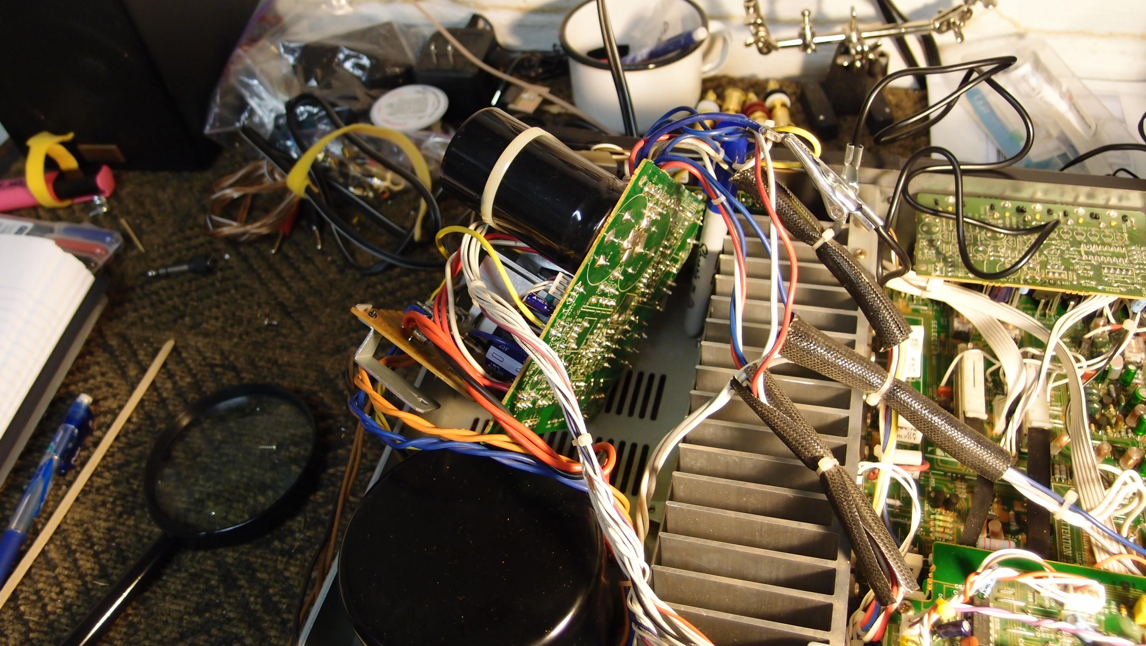

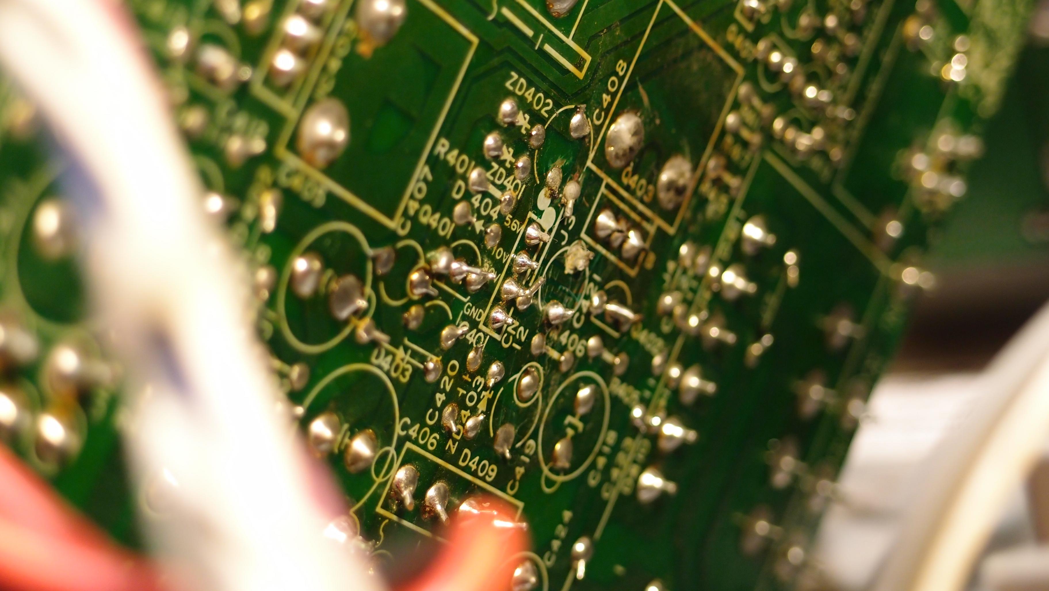

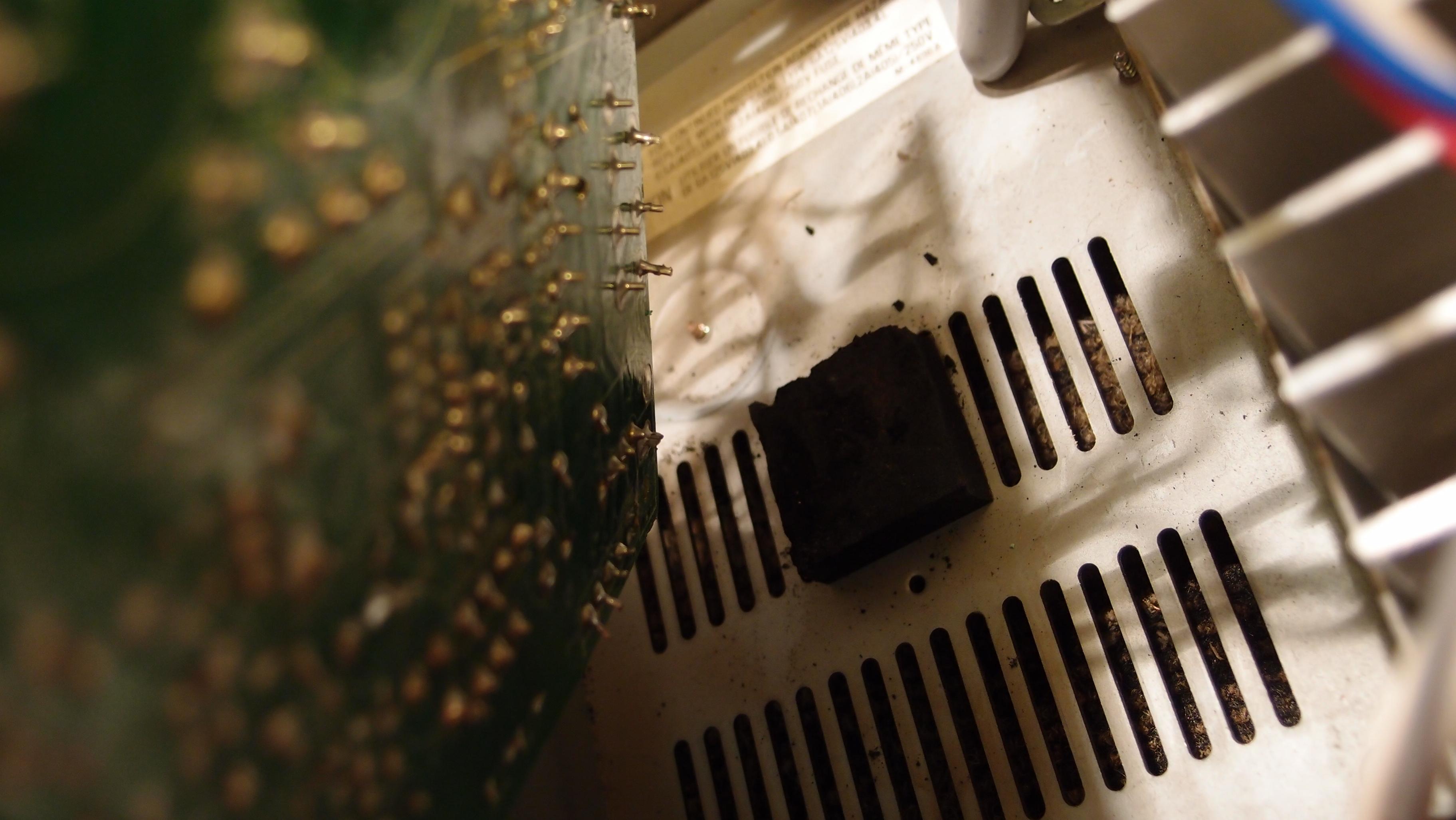

Interesting findings. First pic shows how NAK made it tricky to access the PS board, it cannot be tackled from beneath. Second shows some solder bead issues on C402, the 5.6V power connector, J3, C408, and general area. There was a piece of black foam attached to this area upon dis-assembly. Final pic is a foam pad underneath the PS board. I believe this is the cause of the fault, it has resulted in some conduction between the previously mentioned solder joints. This foam pad has to go. Wonder why it was there to begin with. There is some decent clearance between the pcb and the case.
Voltage across ZD403: 7.03V
Voltage b-e 2SC945 (driver): 4.25V
Voltage b-e 2SD1406: .65V
Since I have the board in the tilted position, I have had no issues on power up. Before, the unit took awhile to come out of protection mode on startup (power light stayed red, now comes green immediately). Either some solder joints are being affected or the foam is also to blame for this problem.

Its definitely open circuit with 4 volts across B-E. The 2SC1345 should be OK.
I'm wondering whether its worth replacing the other one too. Those type (generally) have a habit of failing intermittently... I'm wondering if that has happened and that is what has killed the small driver. Any suitable NPN power device would be OK.
Cracked joints are common on any older equipment, particularly around parts that run hot. It can be worth just going over a whole area if there is any suspicion of anything intermittent. The foam is possibly to stop the board being pressed down and shorting... hard to say... but foam, glue, cable ties, all are seen in commercial gear.
As to the original problem... as it is the driver that is zapped, it makes sense in this case to replace both.
