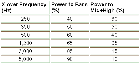

does anyone know if there is a way to calculate a good speaker power distribution for a 2 way or 3 way system? I am trying to build a sound system and have no clue how much power to put into each frequency range. If someone knew how much speaker power to get for lows mids and highs, it would help me out a lot. I wish i had access to the funds to get all the same power speakers and then figure out what sounds right from there, but i can't afford that, i need help to get it right the first time.
The amount of power distributed depends on the number of octaves covered as calculated by the equation N=log(F2/F1)/Log2 where F1 is the lower frequency and F2 is the higher frequency. If you first calculate how many octaves the speaker will totally cover, then you can determine the % each driver sill cover. Note that this normally ends up with XO regions not favored by most purist designers.
From "Loudspeaker Enclosure Design and Construction", published by Fane is the following table. There's an article by Rod Elliot on his www.sound.westhost.com website on bi-amping where he uses this table.
But, essentially, if you're going to cross at 350Hz and 5000Hz, then if your bass amp is 100w/ch, you should only require 70w/ch for your mids and 30w/ch for your tweeters.

Try this !!
http://users.tpg.com.au/users/gradds/xls_files/power.xls
for 2-way, just enter the same x-o freq for 2 values.
obviously only a rough estimate !!! but try the values from the table above, they should be reasonably close !!
thank you all, i will get equal powers al the way around. i already had my crossovers calculated when i posted this. i am doing a 3 way sstem (for now.) my crossovers are going to be at 200 and 2030 hz, and i will cover frequencies from 20 to 20,000 which gives me exactly 3.33 octaves in each frequency range. i already have speakers selected to handle these ranges i jsut wanted to know how many to get, so thank you all for the help.
