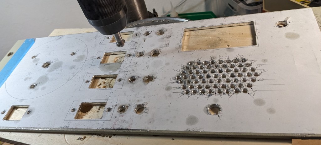

I'm making progress in the construction. Lots of holes, see attached pic. I will send other pics when done, so others may get inspiration. Meanwhile I have a question about the cabling of the isolation transformer output. Swiss sockets are well-defined, the phase "live" is right, the neutral left, the earth centered. I followed this rule for my cabling, along with the cable color that are normalized.

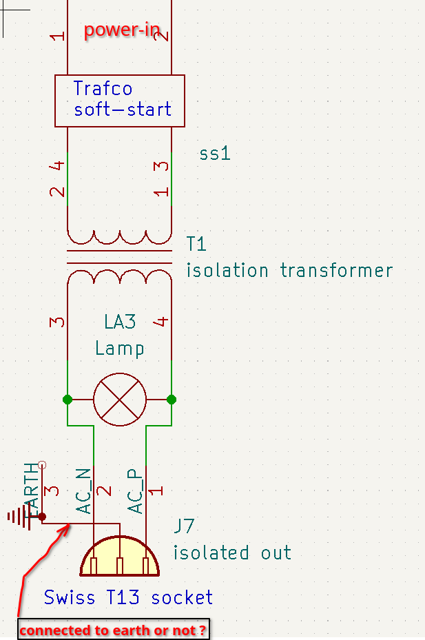

What I'm unsure about, is whether I should wire the earth of the isolated power output, see below the schematic part. The live and neutral will be floating, so if I wire the earth of the female socket, it will ground the housing of the powered device. In my interpretation this is desired and I'd think to cable it, but is there another way to look at this question ?
It's not clear from your schematic which is the input and which is the output. Traditionally, schematics are draws such that signals flow from left to right. In a power supply, the power is the signal. That said, I'm pretty sure the Swiss T13 is an outlet, so I'm going to assume that you have the output of the circuit at the bottom of your drawing.
Here's what I'd suggest: Put a plain IEC 320-C14 on the chassis wall for the power inlet. The protective earth terminal of this INPUT goes to the chassis. The power then flows through the soft start and isolation transformer.
I would not ground the OUTPUT of the circuit. After all, the whole point of the isolation transformer is that you get the output power isolated from the input. The point of this exercise is to ensure that someone who comes into contact with either of the two conductors that carry mains voltage and building ground does not get electrocuted.
Note that this only works if you have an actual isolation transformer. I.e., one with a separate primary and secondary winding. The transformer should conform to electrical safety Class II, i.e., have reinforced insulation (double insulation) between primary and secondary.
I'm curious what the vent holes are for. Dust I/O? 🙂

Thanks Tom for your comments. Updated schematics attached, on this schema the earth of the isolated output is now unconnected.
The whole thing is a power distribution for my bench, with 4 outputs: fix, bulb-in-serie, isolation, variac. The Variac input can be the "bus" or a front-panel IEC input.
The inputs are at the top of the schematics (back of case), the outputs at the bottom, front-panel. The isolation transformer is a Triad VPT230-2170 (class B, 4'000 V). The holes in the front are to see the incandescent bulb of the 2nd circuit from the left.

Let me make a few suggestions, this is what we did in the Monster HTPS 1000 to meet the safety requrements:
1) Use a GFCI on the output of the isolation transformer. (They go by different names in other markets than the US). It will be good protection since it trips if any current going out does not return properly. They do NOT need grounding to function.
2) The safety earth ground can be connected as long as the isolation transformer is fully isolated (two output conductors, no center tap) with no impact except for leakage current from AC Line filters. That leakage could trip the GFCI but it may be a good thing to identify marginal or failing line filters. Some EU brand line filter is notorious for the caps failing.

That's a good idea! In french we call them "disjoncteur différentiel" or "FI". I can buy a 10mA or 30mA. I think 10mA is ok, 30 mA are for garage, cellars and other humid locations. My lab is not humid, most of time 🙂
Next challenge is to find some space in the box and affix it. Updated schematics attached.

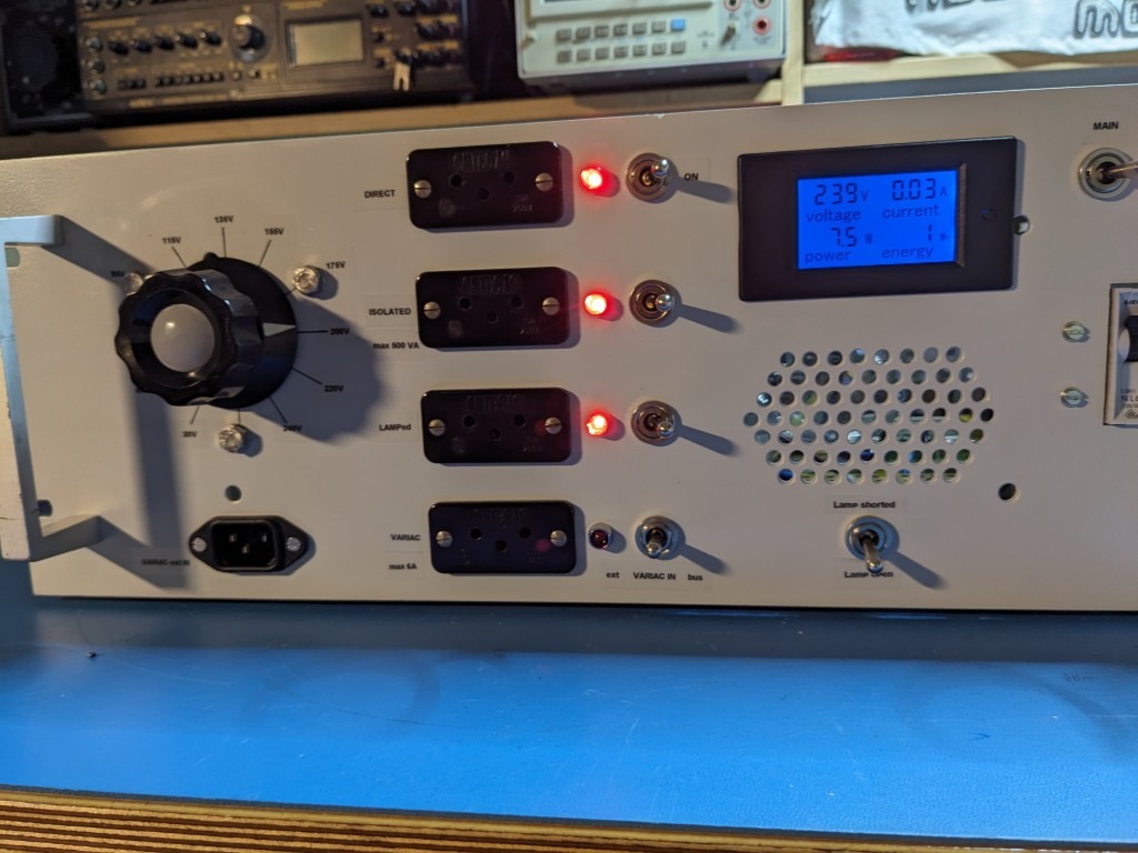

I had to add a 2nd soft-start module, as the 1320VA Variac tripped the main input breaker every 2nd time. Updated schematics attached in case someone wants to build a similar device. The bad thing is, the Variac input LED is broken (or badly soldered) and of course it's the one that is the most difficult to reach now that everything is cabled together.
On thing that I would do differently is to have a volt-meter on the Variac output. The digital module I used can't do it, it starts working from 180VAC, and there aren't much more front-panel estate anymore, so I will rely on the marking or an external multi-meter.
The box weights 16Kg, the Variac and the isolation transformer are heavy things, but they should last for the rest of my career if I don't mess up. There are fuses everywhere, and the left-most differential breaker is wired at the isolation transformer outputs. The front-panel markings are Dymo transparent labels, decent enough for the lab. The thing looks big but once I closed it and move it into it's final location it's less space than the individual boxed things and easy to reach.
An interesting aspect is the output of the isolation transformer. With 240V main, I get 250V at its outputs when unloaded. That's still within 230V + 10%, but still a bit high. Thanks to Hardi's suggestion, I can wire the Variac after the isolation transformer, especially for vintage DUT which were designed for 220V.
