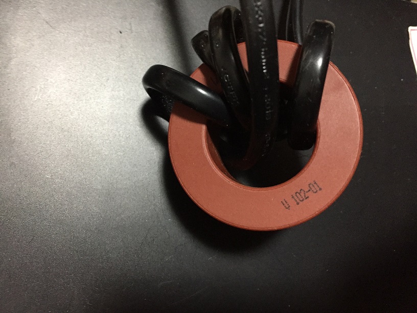

Hello,
I recommend VITROPERM 500F core.
I think that, VITROPERM overcomes any ferrite core.
en NanocrystallineVITROPERM-EMC-Products-2016_01.pdf
It sells at Mouser.
https://www.mouser.com/Passive-Components/EMI-Filters-EMI-Suppression/Ferrites/Ferrite-Toroids-Ferrite-Rings/_/N-bw7t9?P=1yi2qw3&Keyword=VITROPERM&FS=True
