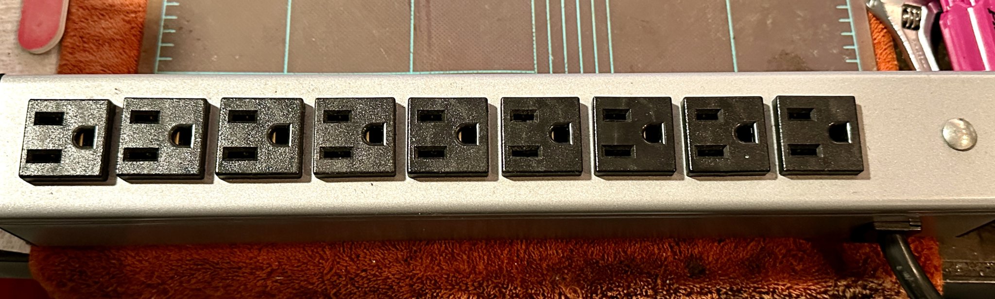

I have tried a number of different power strips / power centers over the years.
I settled on the simple Wiremold 9 outlet model shown below. It’s the one recommended by my Naim dealer. Just correct wiring, with no MOVs or inductors. This one supplies two power amps (various Pass clones), my original NAP 250, a dual HiCap DR, two XPS supplies, and a Rega turntable 24V transformer, with an open slot separating the high power components from the low power ones (as a visual indication).
The only power filtration I have found to be useful is a Chang Lightspeed 3200. Mine powers a voltage dropping transformer for my VPI turntable, an Audible Illusions tube pre, a Rega phono pre, a headphone amp, and an Audiolab 6000 CDT. The Lightspeed maintains an excellent ground continuity with the Wiremold strip, and I have no hum when using the Rega phono pre.
