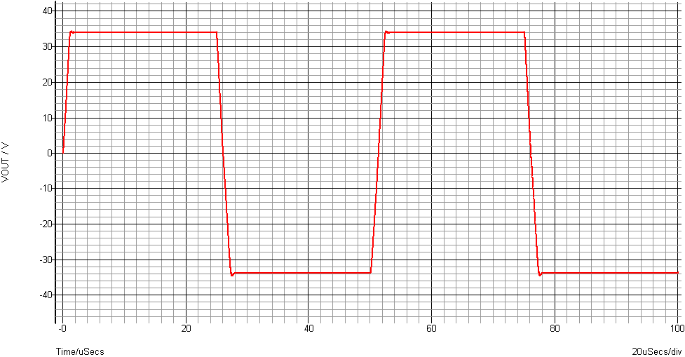

Here a picture from the simulator , i ll post the schematic later
on a relevant thread about symmetrical differential basic topology.
Actualy , only part of the compensation is made through
the fets input capacitances used as shunt.
Elektor s Crescendo used the same scheme but was hardly
stable , due to the cascoded VAS that cant be compensated
this way.
Anyway , perfs where not extraordinary but good enough
for the intended purpose , i.e , stage monitor amplifier for
my keyboards set.

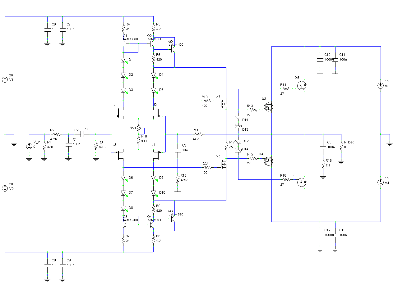

Here's an amp with no compensation. The reason it doesn't require any is because it is a folded cascode (only one gain stage).
Generally, an amp designed like this will have lower gain, higher distortion and higher slew rate than an amp with traditional Miller compensation. Not ideal characteristics for audio use.
