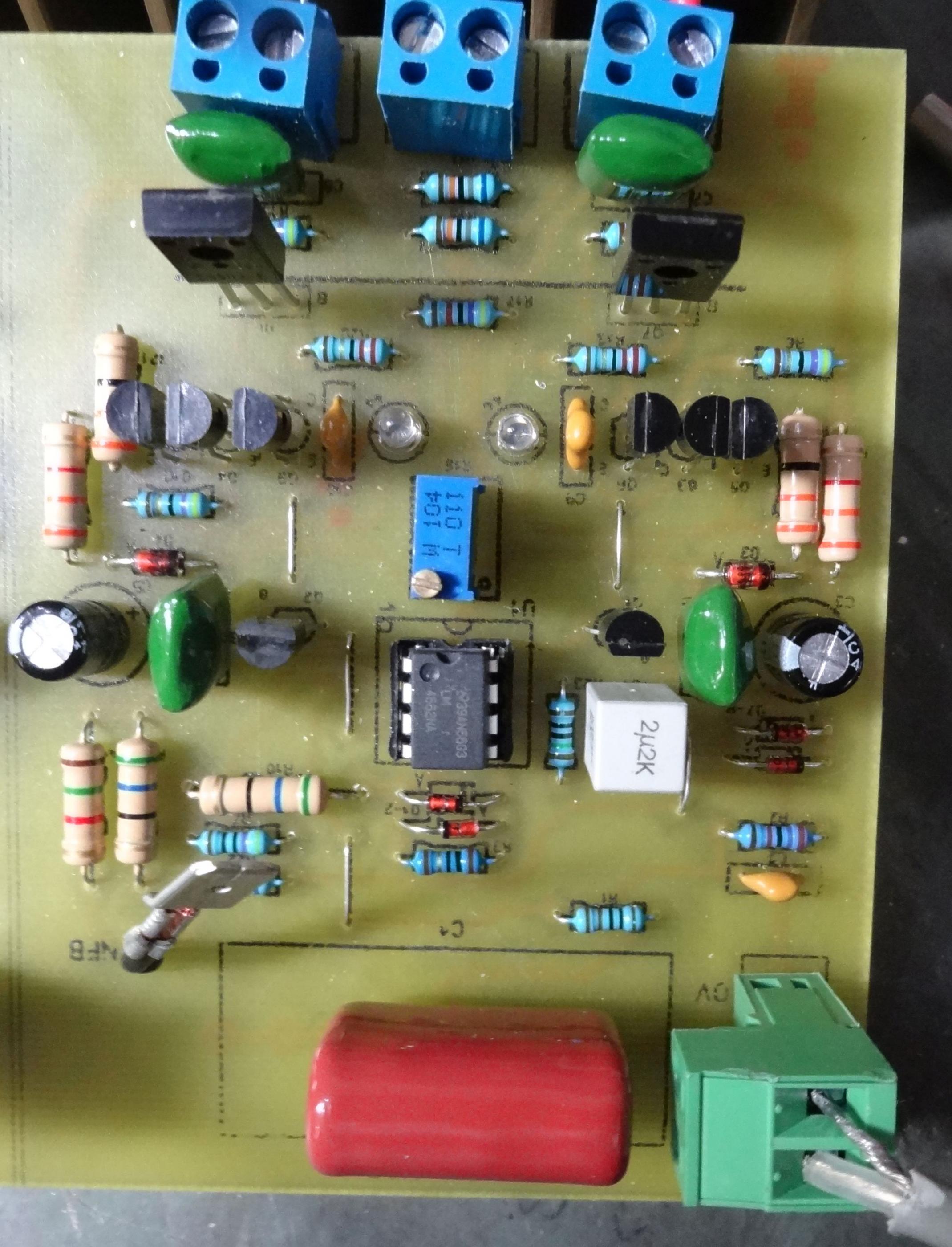

There are a lot of topologies for such amplifiers, but I filed they into two main groups:
1) Signal pad by voltage supply rails of small signal operational amplifier
http://sound.westhost.com/ad_fig16.gif
http://nacl.de/audiomap/sac_50.gif
http://www.diyaudio.com/forums/solid-state/41034-abacus-rieder-60-120-amplifier.html (post #5)
Bild: dacmos300jh8qu4m.jpg - abload.de

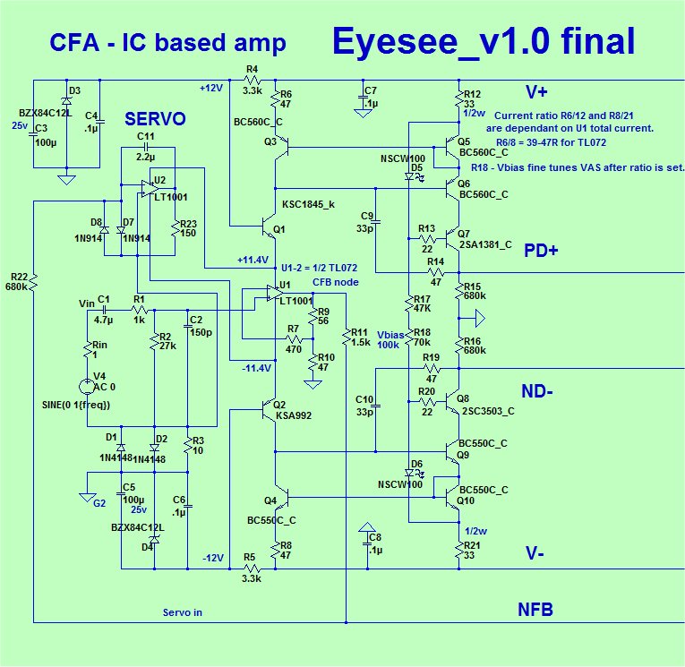

Another one of the first type. By chance, I was looking at it earlier today.
http://www.electroschematics.com/wp-content/uploads/2008/04/mosfet-power-amp-irf9530-irf530.gif
This topology doesn' t look right at first glance. Then you take a closer look and think: "yeah, that could work."
(below) is one that IS working ...
Eyesee got thrashed by member Still4given.
-perfect clip , full 200W+ through the EF3.
He said it was comparable to the standard leach/blameless input stages
with the right op-amp.

I absolutely agree, in this topology you're trying to 'sense' all of the opamp supply current (as a measure of the signal current), so adding any capacitance will shunt some of this away from the transistor emitters and reduce the curent sensing effect. In addition, the impedance looking into the emitters will be quite low, so the impedance of any capacitor will only have an effect towards the HF end.The supply rails of the operational amplifier are signal outputs at the same time on this approach. This means, that capacitors at this nodes create a low pass character.
Because this happened inside the NFB-Loop, it isn't possible to predict what happens without simulation by CAD software like ORCAD.
Ask Mr. Bob Cordell for more advices concerning this.

Hi, your first category utilises the 'supply current sensing' technique, which was used to create the first current-feedback topologies using conventional voltage opamps. The whole supply current fairly closely matches the output current, which is ideally what is required in this topology, with the 'error' from biassing relying on the overall loop gain to attenuate. Providing seperate supply pins for the opamp output devices would allow only the output current to be sensed for greater accuracy, as would an additional discrete current buffer stage after the opamp.
One key difference between the first and second categories, is that in the first the overall negative feedback is current, which in theory allows larger slewing currents of the first stage and some independance of the closed loop bandwidth from the closed-loop gain and Gain Bandwidth Product, whereas the second uses conventional voltage feedback. As to which is preferred - that will depend a lot on the detailed implementation!
