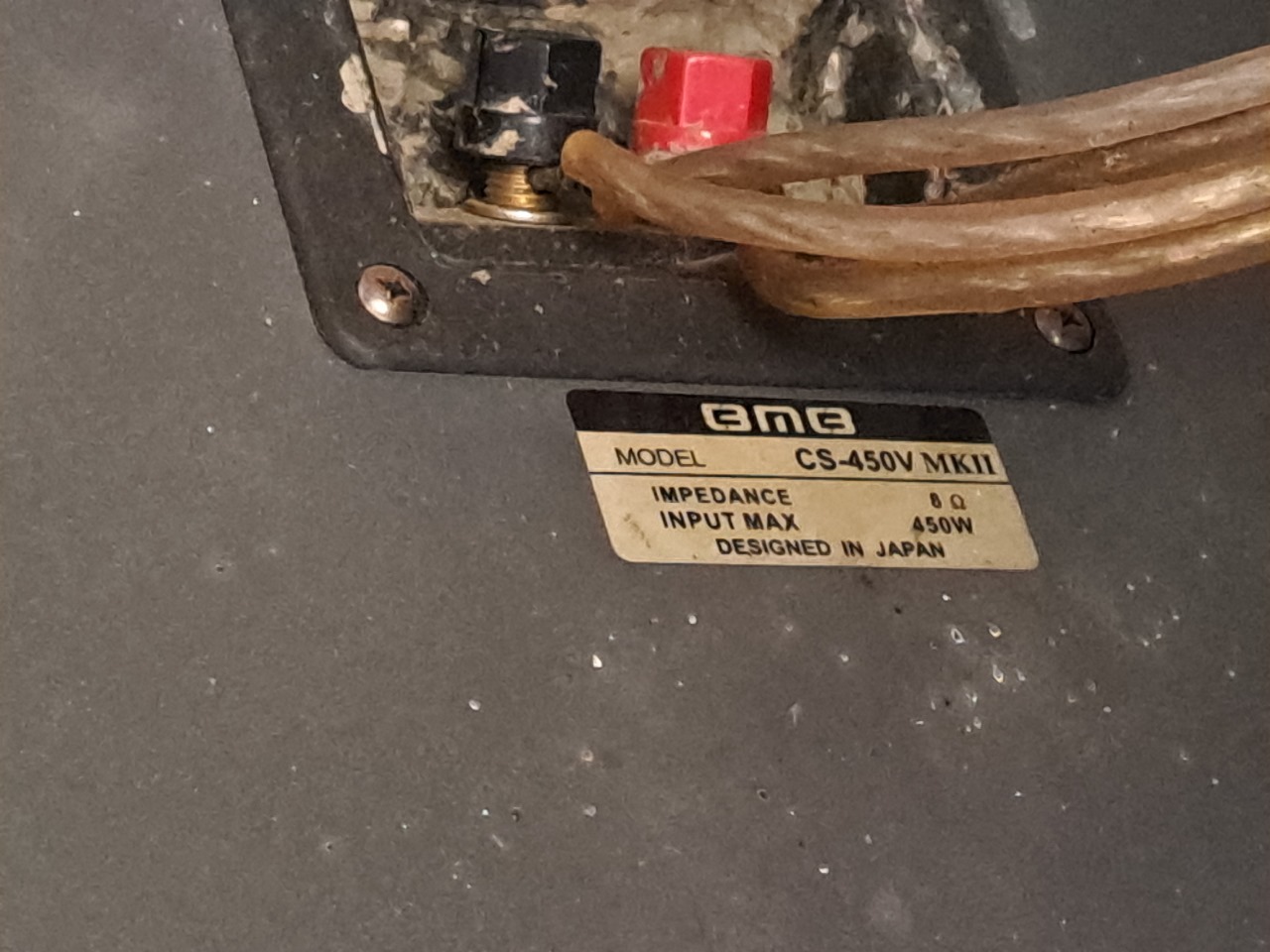

I want to buy a power amplifier but need to figure out my power requirements and it's rather confusing. We have 4 speakers that are 450 watts each with an impedance of 8 ohms. I want a 2 channel power amplifier. Should it be 900 watts, twice the speaker watts? Does it matter how the speakers are connected to the power amplifier? I see talk about parallel vs series connections. This is for a small village church in Indonesia that I'm trying to help.

How will the system be used? Is it speech only or a combination of speech and music?This is for a small village church in Indonesia that I'm trying to help.
What are the specific speaker models?
How big an area/room will the speakers have to cover?
If the speakers are some PA model.. even if they are a brand we have never seen in the west, it's a fairly safe bet they will get pretty loud without much power so you may not need as much amplifier as you think. But if they are more designed for studio or home use then they may struggle to get loud enough even if you get a powerful amplifier.. or they may only last a short time. You need the correct tools for the job.
A picture of what’s under the hood would be more helpful, when it’s something we’ve never seen in the west. How big a woofer? What kind of tweeter (dome, horn, piezo)? Judging just from the kind of connector on the back I would say it’s not designed for heavy PA use. Background music duty, I’d believe. Churches can get pretty rowdy and loud, and a preacher screaming into the mic repeatedly can blow tweeters faster than you can keep them replaced.
These... https://bmbspeakersystem.com/product/cs-450-v-mkii/

Which is really low for a PA application.. and how accurate is that? The room is 10mx25m, if that means it is 25m deep and the speakers are at the front then to generate 90db at the rear.. which is just enough to get over top of everybody talking in a reverbant room.. requires 126dB from the speakers (losses are 6db for every doubling of dstance) but these are only capable of about 115dB continuous with 250w input.Speakers have 91dB sensitivity at 1W1m.
30 watts per speaker is about what real power you’ll really get out of a 250-300W amplifier. Unless it’s turned up to sounding buzzy or raspy all the time. I’d keep the power at this level rather than opting for 900 watts per channel and risk the fires of hell and damnation. At least the cone-type tweeters will probably take the short term overloads you’re likely to get with a 200-300W amp. Domes are often used on these background music type speakers and they fry just a bit too easy.
So does that mean for a two channel amp a 500-600w amp would be enough for four speakers? Not just two?These... https://bmbspeakersystem.com/product/cs-450-v-mkii/
An amp that produces 250-300w per channel at 8ohms will power these to full output
There are two speakers in the front, right and left walls and two speakers about 2/3 back on the right and left walls.Which is really low for a PA application.. and how accurate is that? The room is 10mx25m, if that means it is 25m deep and the speakers are at the front then to generate 90db at the rear.. which is just enough to get over top of everybody talking in a reverbant room.. requires 126dB from the speakers (losses are 6db for every doubling of dstance) but these are only capable of about 115dB continuous with 250w input.

Sure it will work. But it’s also enough power to turn those speakers to charcoal if not used responsibly.
Yes that is where I was going with that... knowing that the amp should produce about double the power driving 2 speakers per channel.So does that mean for a two channel amp a 500-600w amp would be enough for four speakers? Not just two?
Wg-ski and I both own that exact model, it's a really good amp but as mentioned it is a bit like playing with a hand grenade... unless you add some protection(limiting) into the signal chain there is good possibility the speakers won't last long. A better choice would be a P3500s.Or I'll try asking this way. Would the following amp work?
Yamaha P7000S
In that case would Yamaha P5000S be better?Sure it will work. But it’s also enough power to turn those speakers to charcoal if not used responsibly.
