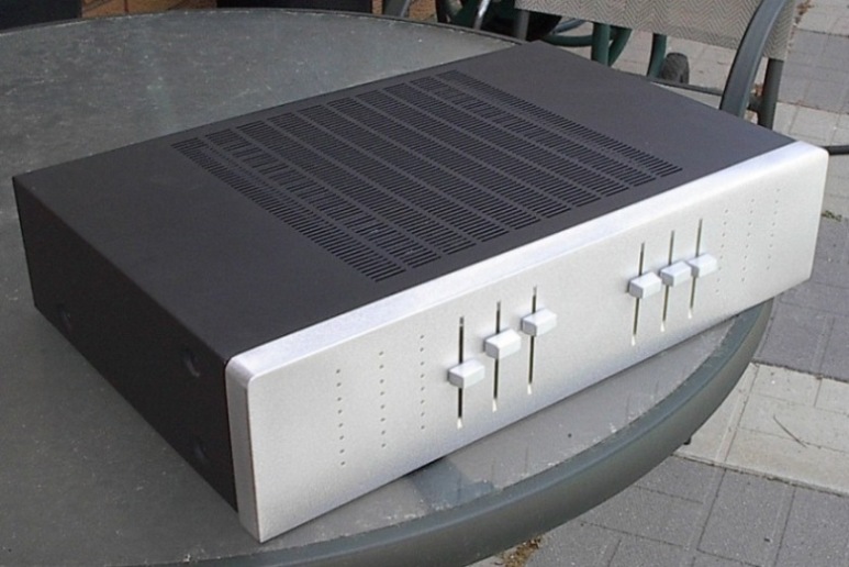

Anodised is the way I went http://www.par-metal.com/

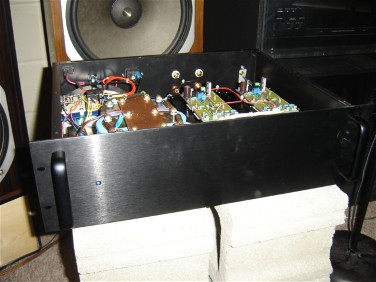

For my next project I'm looking at a pair of 20W class A monoblocks with regulated power supply in a pair of recycled 3U heatsink sided rack cases, I was going to cut the rack "ears" off and glue some 1/4 inch ply to the 3mm aluminium front panel. then run around the edges with a router with a 45 degree chamfer that extends halfway though the 3mm aluminiuim. the cases would be stood on their backs on the floor next to the speakers on wooden plinths made from old skirting board, all cables exit the back (now the bottom) through a slot in the back of the plinth.
