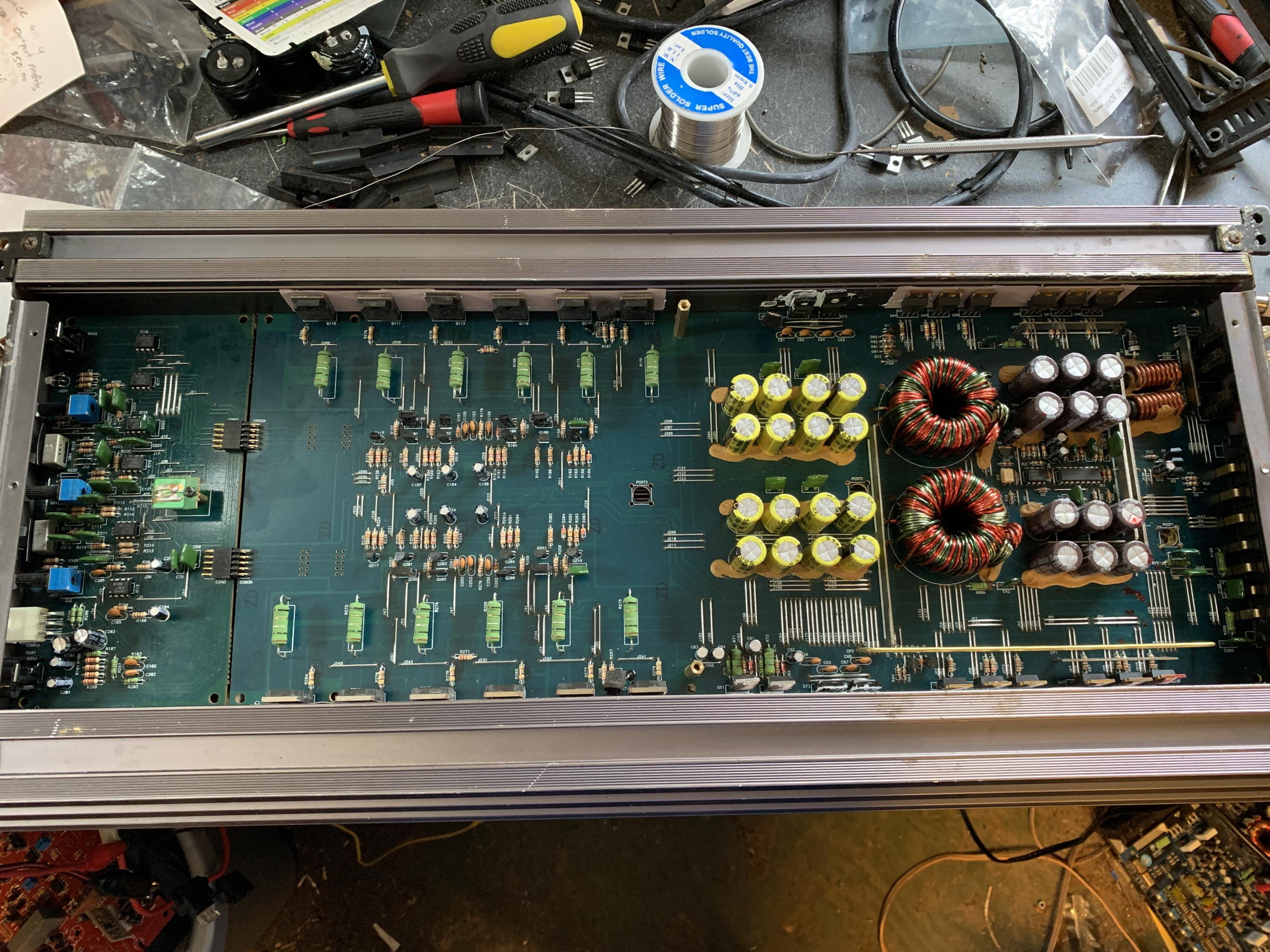

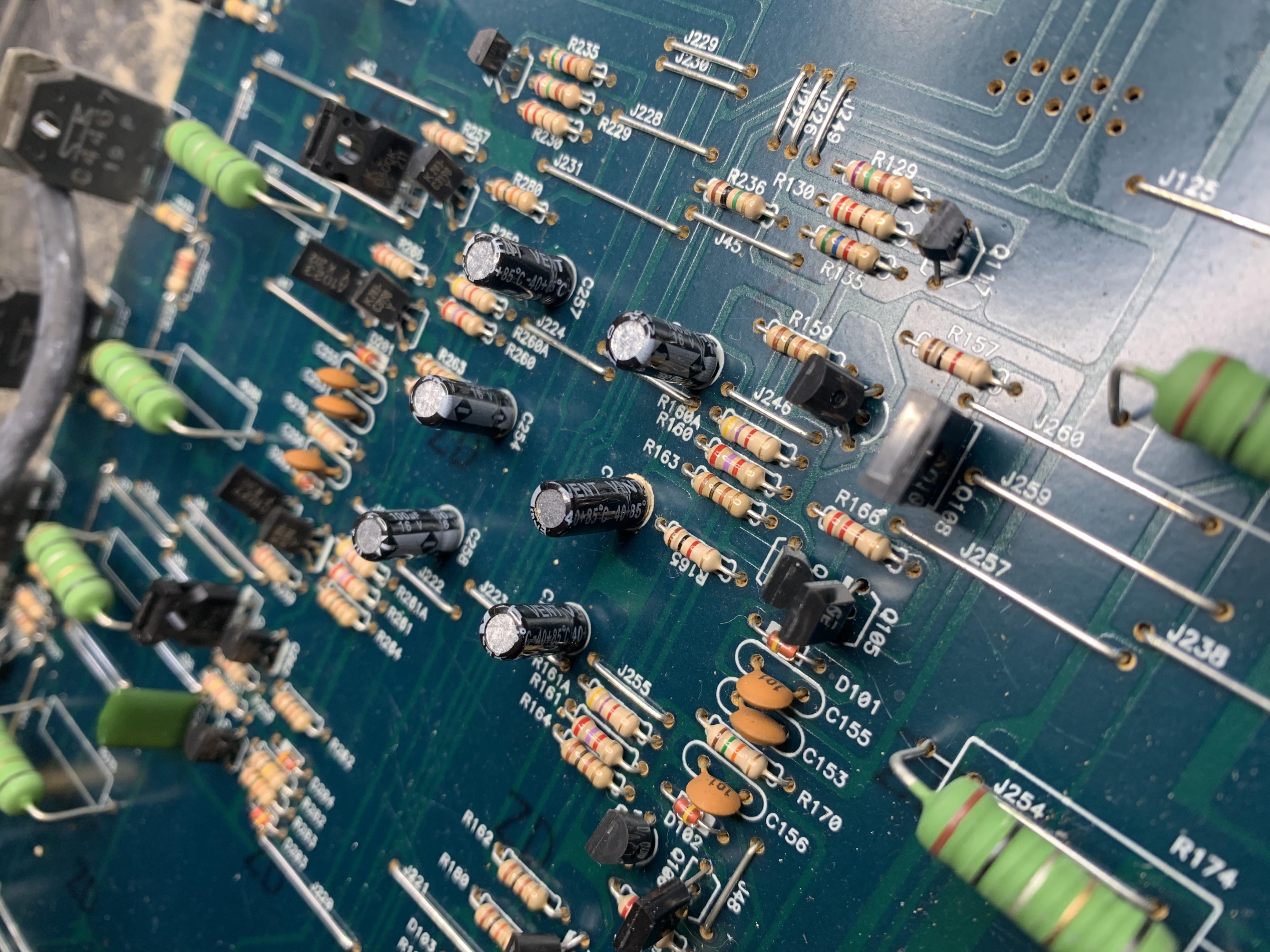

Ok. Today I’m having trouble with a Power Acoustiks OV2-1600 Gothic Series amplifier. It’s a huge amp with lots of unused real estate. Should be simple, right?

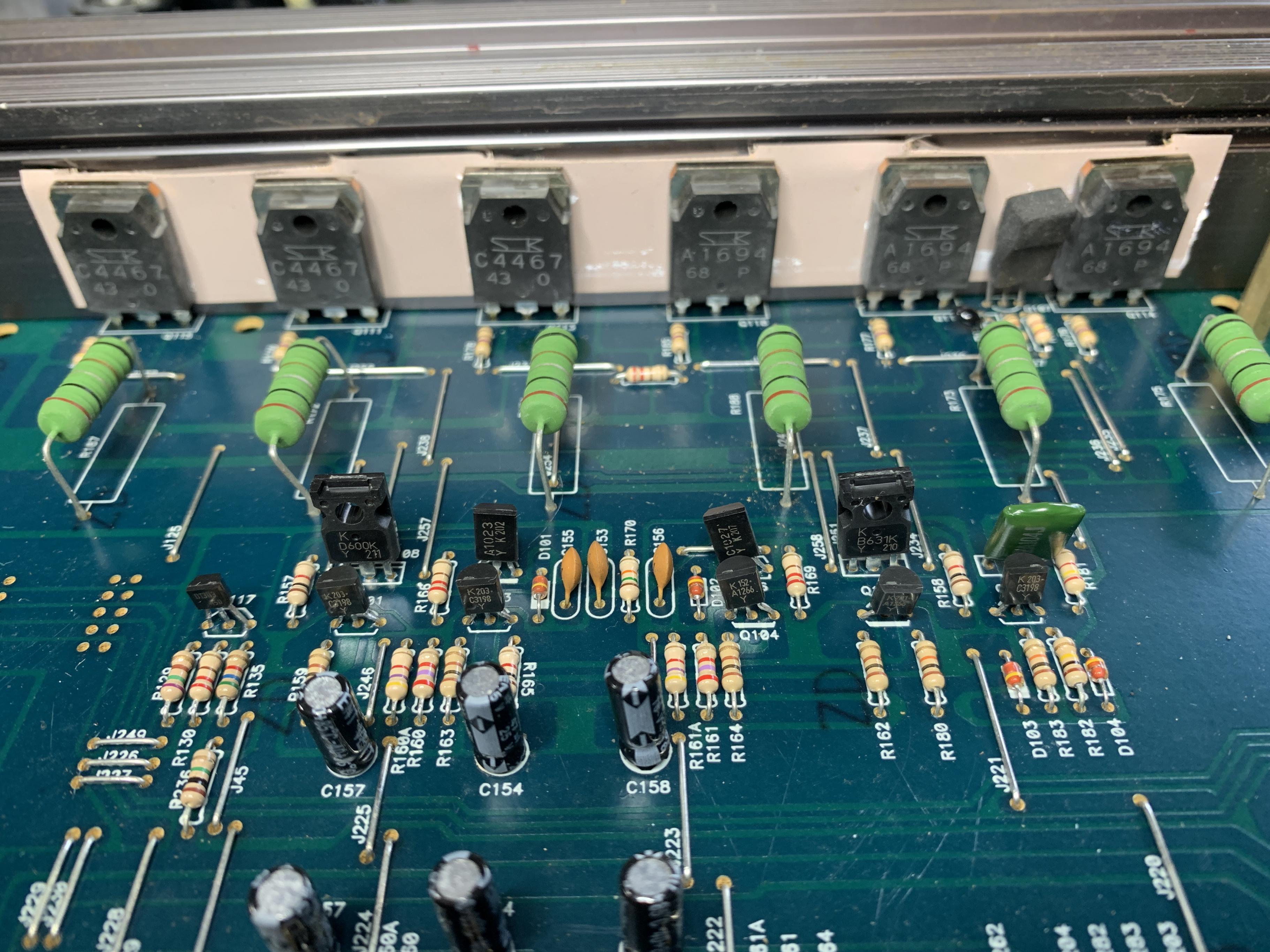

The amp powers up and plays fine in the right channel but the left channel is weak and staticky sounding. The amp uses 3 A1694 mosfets and 3 C4467 mosfets in each channel. In the channel that sounds weak and staticky the C4467s heat up pretty rapidly. The amp is sitting into the heatsink but the mosfets are not clamped to the heatsink.
The individual components test good but I’m not sure what is happening to cause the weak amplification and heat. Any ideas?
I am attaching photo of the affected area.

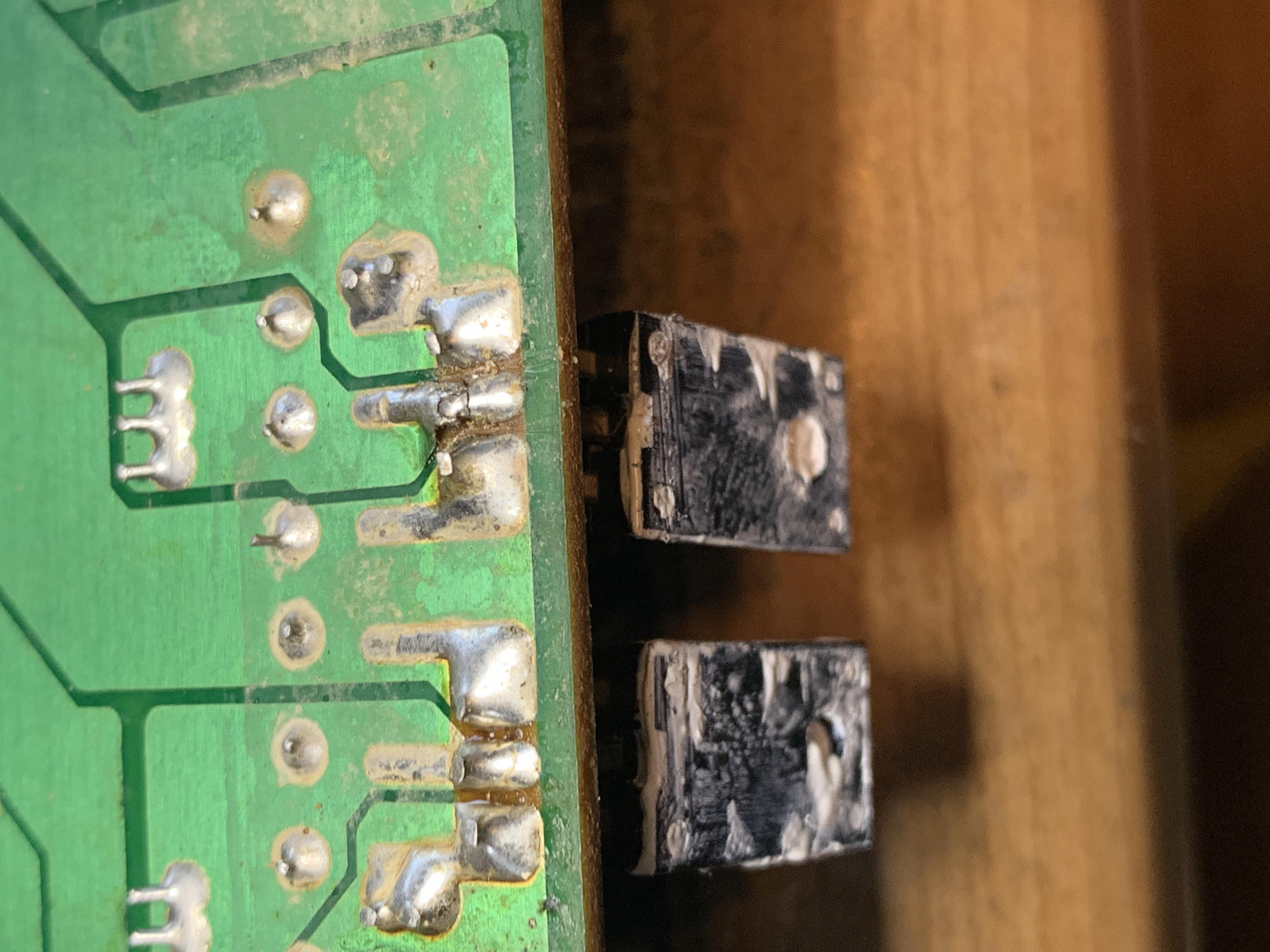

I did find a cracked solder joint on one of the rectifiers on the left channel the center leg solder joint is questionable to say the least. Maybe that is part of the problem. I’m going to wick this solder out and re-solder this leg right now. This IS one weak feeling board to say the least. I bet this thing vibrates like crazy.

Ok. That eliminated the over heating problem but the left channel is still weaker than the right channel. Static is gone too by the way.

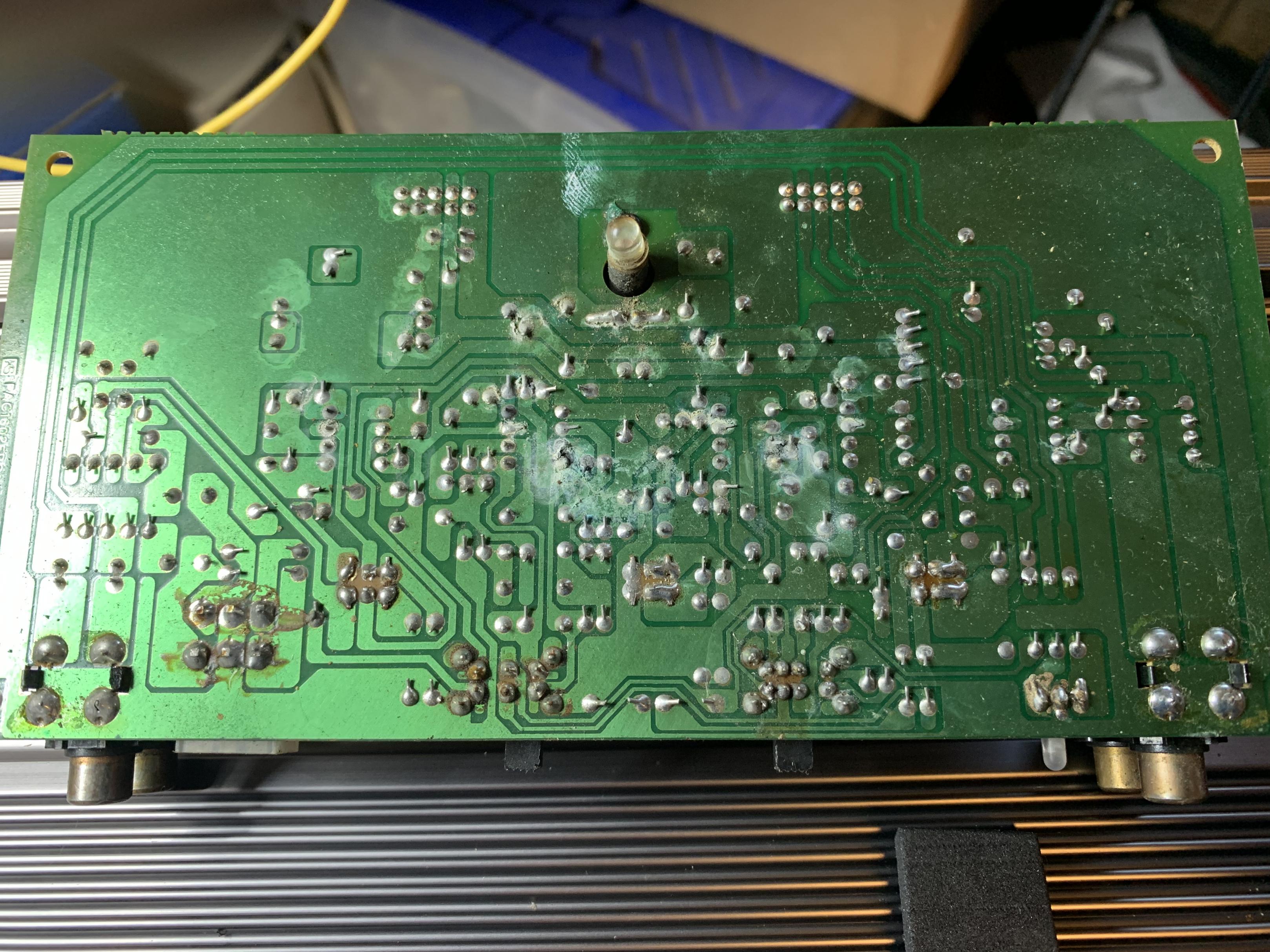

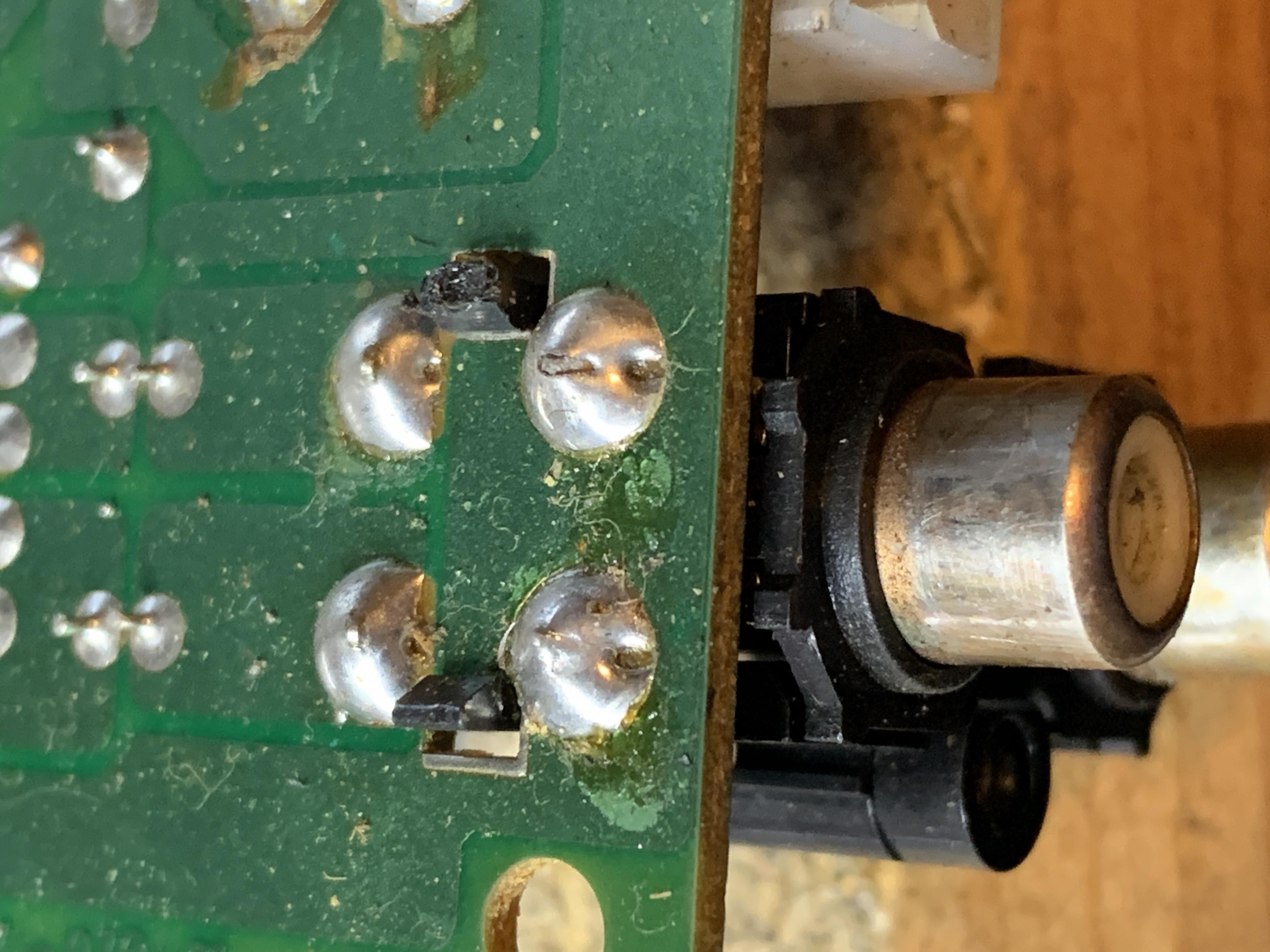

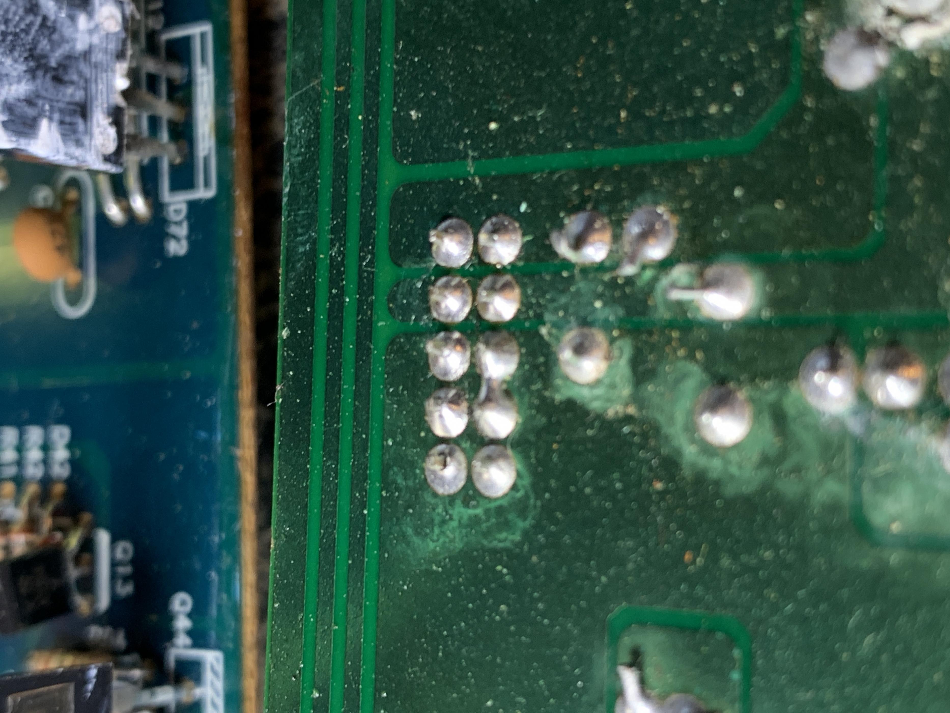

I did clean them with Deoxit and worked them back and forth with no progress. I decided to pull then preamp board and flipped it over to examine the solder joints. I see a lot of corrosion on there. I’m going to clean this board up and see if anything is going on underneath all this white corrosion.

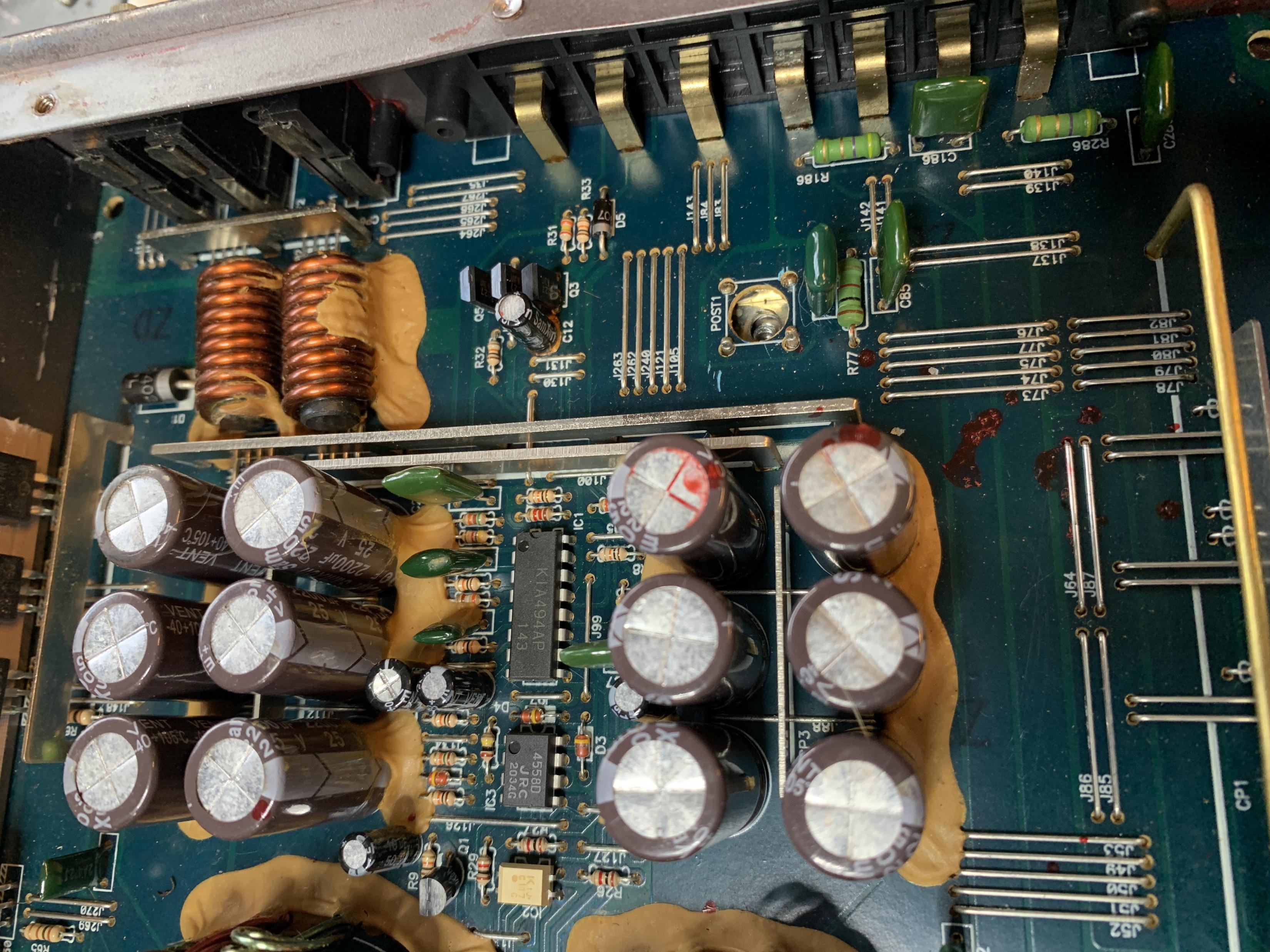

Okay. Turns out that the problem was bad electrolytic caps in the signal processing path. I found four bad caps but I decided to replace all of the electrolytic caps in the signal processing circuit. Total of 12 caps. Cheap insurance to make it doesn’t come back with same problem a few months later.
I replaced these in the middle. One was leaking a little.
