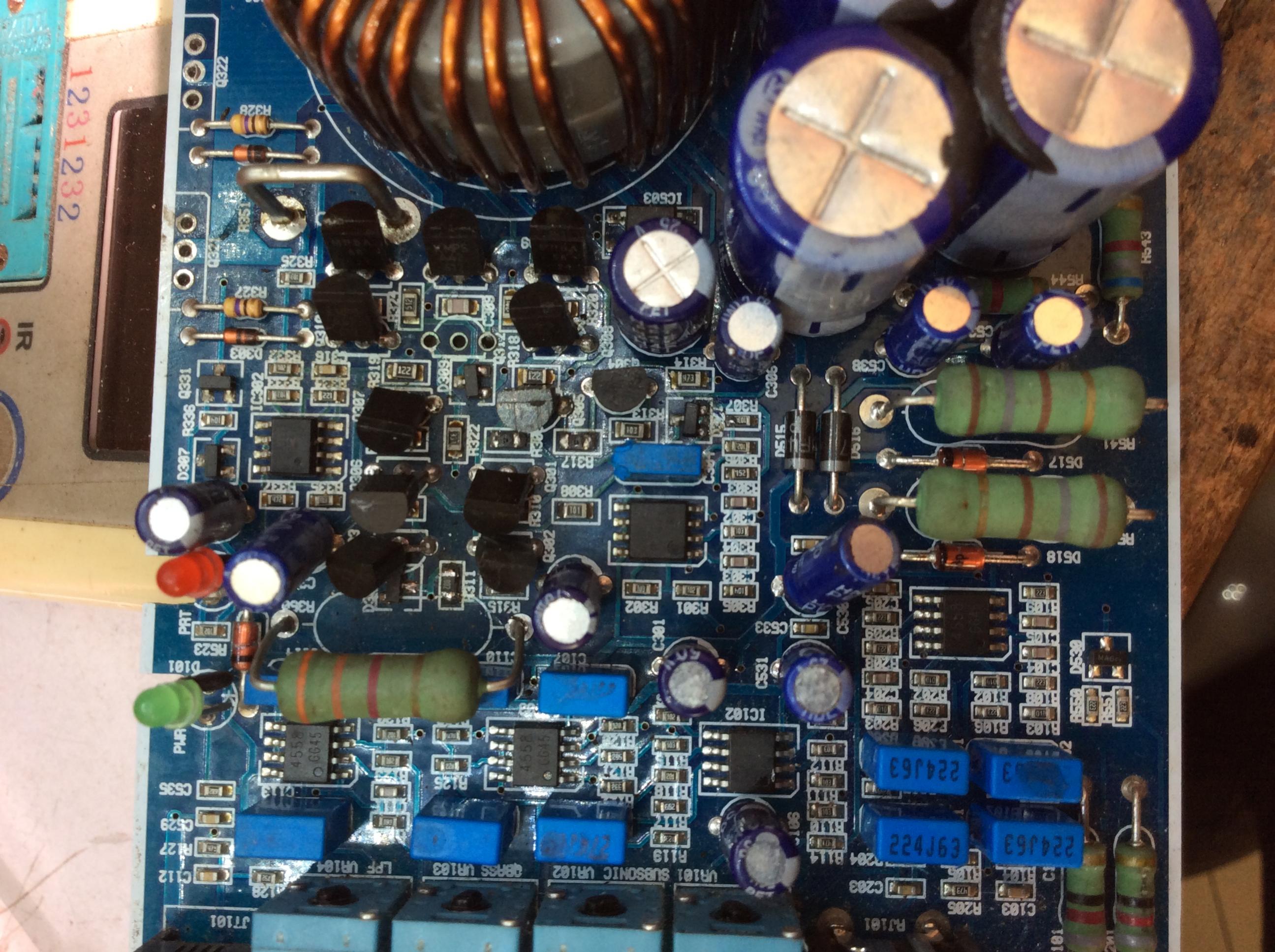

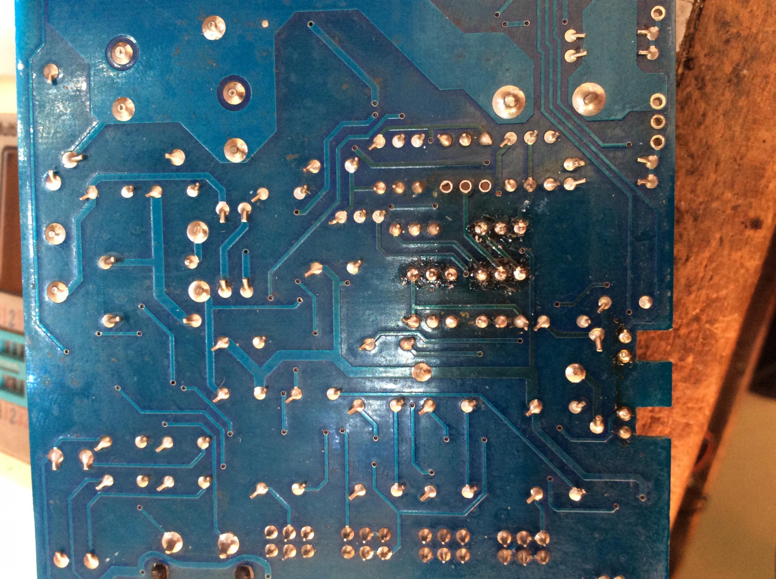

Power Acoustik RZ1.1500D Audio Driver Circuit
This amp doesn’t uses a daughter card. No modules. The drive circuit for the audio is on board, an arrangement of MPSA42, MPSA92, MPSA56, a 4580 and a 393 chip.
