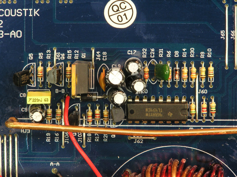

In the amp I'm working on today - it wont power up but the fets could also be to blame. I clipped off the ones which blew out and left 1/3 of them still attached because they were not registering shorted. Next to the TL494 is Q1 which is shorted from legs 1-3. The transistor is a 649A which I found a possible datasheet for.

Also in the above photo you can see the red wire may be on the wrong side of the 1n4001 diode. This wire leads to what I beleive is a transformer which activates the amp's "Plasma effect" on the front cover. its kind of like one of those voltage globes at Spencers / Radio shack where the arc will follow your finger but in this case its a flat plastic piece. On the left you can see where it was possibly clipped, and on the right someone used heat-shrink and cold solder.
2N6491 installed facing the opposite direction due to the reversed pin configuration.

If the power supply for the plasma display was the version with only one transistor, it likely had bad solder connections or the transistor was defective. The plasma power supply could not have caused the main power supply to fail.
