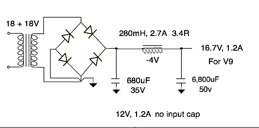

There is one alternative which I use from time to time, and that is using choke input filament supplies and varying a small input cap to get the voltage you want. I just did this today, in fact, on a 10Y build in filament bias. I needed 16.7V output to my Rod Coleman V9 regs. No input cap gave me 12V, 1,000uF gave me 18V and it turned out that 680uF gave me exactly 16.7V. You need the choke to do this, but a choke is a good idea anyway.
Very Interesting! Thanks for sharing AndyThere is one alternative which I use from time to time, and that is using choke input filament supplies and varying a small input cap to get the voltage you want. I just did this today, in fact, on a 10Y build in filament bias. I needed 16.7V output to my Rod Coleman V9 regs. No input cap gave me 12V, 1,000uF gave me 18V and it turned out that 680uF gave me exactly 16.7V. You need the choke to do this, but a choke is a good idea anyway.
