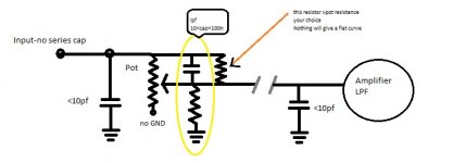

i opened this thread because i can not solve the problem of using a normal stereo pot between PREAMP and AMP
it always looses treble and tweaking it Just doesnt give the same flat curve
If it always losses treble ! is the pot value much to high for any input capacitance that the wiper might see ?
Your not using a 1meg or a 100k pot and an LPF with say a 1nf or 470 pf cap are you ?
I lose treble without cap,only hpf with cap and FIXED resistor solves the problem ,hpf 21 hz
The other fixed parallel improves quality but still not to good,does not attenuate to well
I thought adding another parallel resistor
Pot is 50k cap is 150nf and res to gnd is 51k
Correction its a HPF
